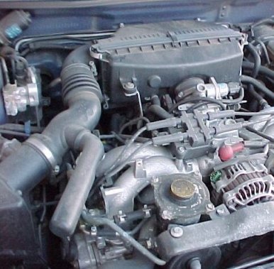

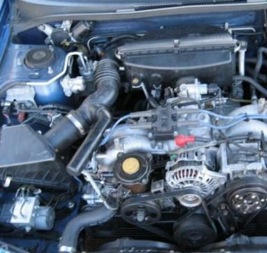

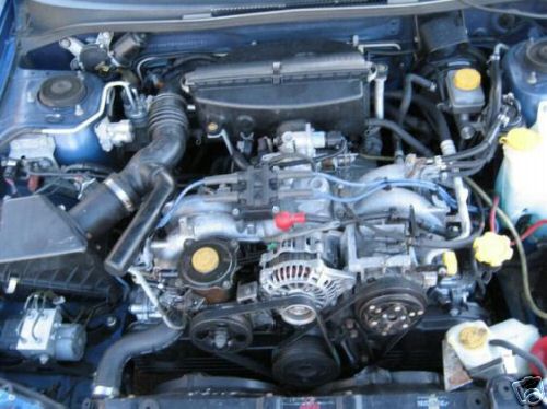

I solved the majority of my engine and tranny problems this morning by just removing one of the air filters. I don't understand why there are two air filter in the 1999 Impreza RS anyway ? I attached pics of two different 1999 impreza and the air intake with two air filters looking the same in both pics? Does anyone know why there are two air filters?
Both air filters were new but the combined air resistance of the two must have been starving the engine of air.

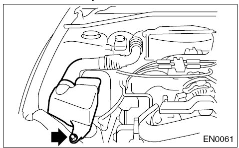

I'm thinking someone my have replaced the air intake duct with another air filter case. Maybe I have both, a filter case for the EJ25 and EJ22.
I will attach a couple of drawing..
I'm getting only one code now and that is the pressure sensor.
However, I don't think my engine has a pressure sensor. I can't seem to find it..
