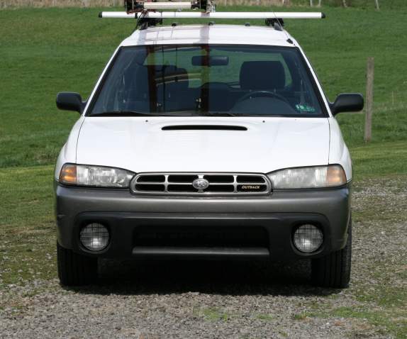

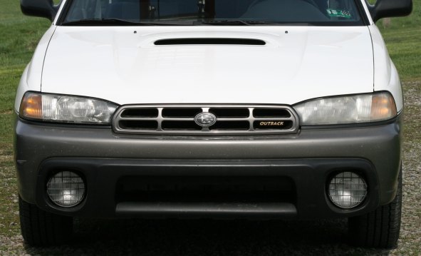

I used Wurth clearcoat on my dingy yellow lenses. I thought it would be worth a try before spending huge money on new lenses. Attachment photo shows the right side with the clearcoat applied, left side without treatment.

skibumm....thats really something...i will def. give Wurths clearcoat a try when mine turn like that.....ill bet you notice a huge difference when driving at night also right?.....by the way were did you get that stuff?
Do a Goggle search on Wurth Clear Lacquer, many places have it for about $12.00 a can. It's a top coat for their Wurth German silver wheel paint. One can goes a long way as I have done 5 Bmw wheels with it and its still about half full.
Make sure you get the lens as clean as you can before spraying them, I cleaned mine with detergent solution and very fine steel wool, then used a prep solvent on the lenses right before I sprayed them. I just used Oops multi purpose cleaner for the solvent.
Not sure it makes the night vision allot better, but sure does make the car look allot nicer looking.
