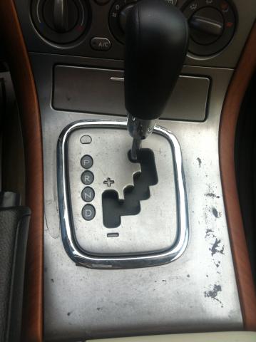

Auto-Gear Shift Cover on 2005 Outback
I just purchased another outback to add to my collection and am in need of some help from board members. Can someone help tell me by looking at the attached picture if the scratched up part is easily replaceable? If so what is the part number? This is a 2005 outback wagon. I am also not internet savy so I hope the picture is uploaded correctly. Much appreciated!!
