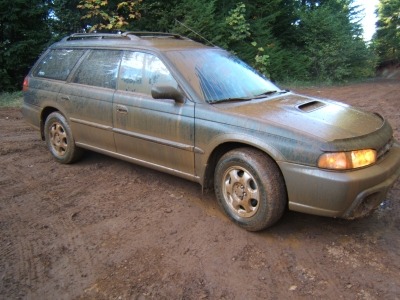

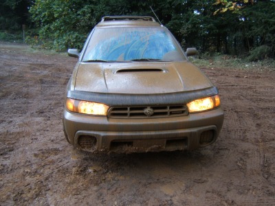

Wagons only - post your pictures here!
Bradsit replied to kevinsUBARU's topic in 1990 to Present Legacy, Impreza, Outback, Forester, Baja, WRX&WrxSTI, SVXYeah, its all still stock....for now. To find the mud I just went up in the hills on some old logging trails. There's quite a few around Oregon so it's not that hard to find one that leads to somewhere where people off-road a lot.
