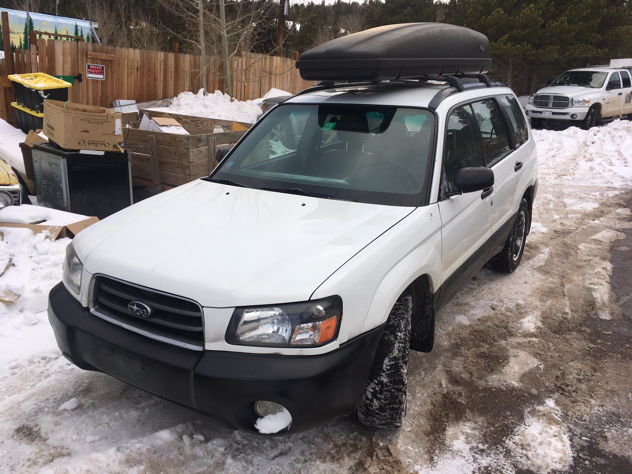

Just got this one. newest subaru I've ever owned 2.5x, automatic transmission (not my favorite, but it'll get me around) Mostly, it's a 18 year old subaru, so it doesn't look great (photo looks way better than reality unfortunately) and it runs through snow great, which is what I got it for. Needs new snow tires for sure... the fronts are almost bald, and it was still going through the snow fairly well, but would not steer well... Getting a set of Sumitomo ice edges studded up next week. 206k miles. Previous owner said the head gaskets were done about 3 years ago. Biggest issues so far is the horrible smell -- previous owner was a cigarette smoker, so I need to shampoo the interior, then do an ozone treatment on it, to see if I can get the stench to go away. But next two issues are no lights on the dashboard at night, and drivers side window does not go up or down. I cannot find any blown fuses, so am wondering what to check next for the lights. All the other lights that I can see work, but none of the dash lights -- gauges, hvac controls, etc. It has an aftermarket radio, so maybe someone did something when installing that? For the window regulator, how hard is it to just replace that? if it's that, and not just a switch issue. Thanks Zeke

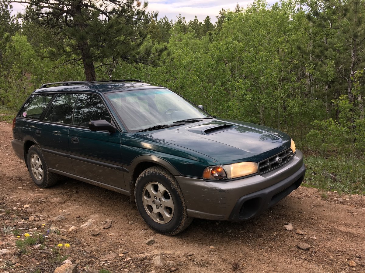

Just got a new subaru (new to me 1999 Subaru Legacy Outback 5MT This is my 11th subaru I think (mostly 80's stuff, but also had some other legacies over the years). It's already had a head gasket job done, and runs pretty good. But, the odometer and speedometer are intermittent. When they work, they work fine -- no wiggly needles or anything. But then they just stop working sometimes (about 2/3 of the time it seems) -- odometer doesn't turn at all and speedometer stays at zero. Any ideas on whether this is likely to be a cable issue, or in the gauge itself? Driving on washboard for a few miles actually made it start working. Had to hit a few trails on the way home. Nothing severe but it did pretty well. New General Grabber AT2 tires, 205/75/R15. Nice and quiet on the highway, and seem pretty good offroad too. Thanks. Zeke
