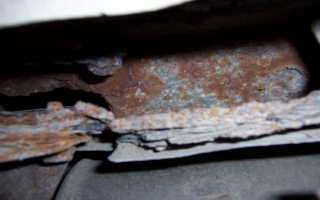

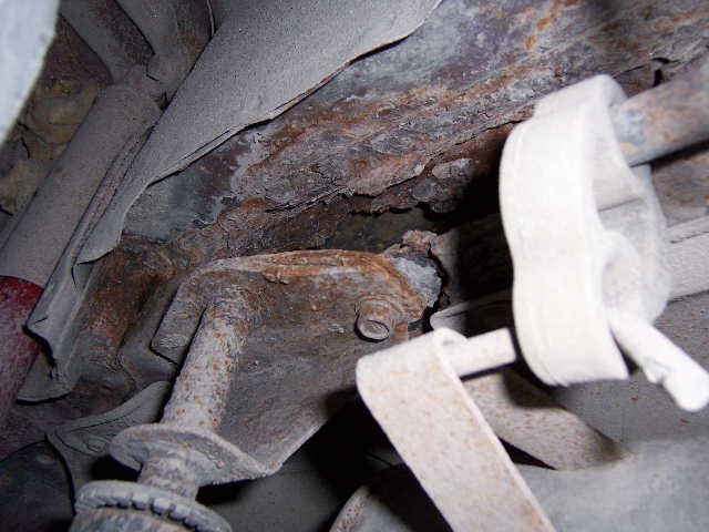

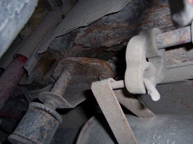

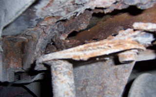

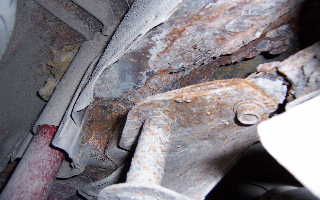

  1. Thanks for the replies. I appreciate it. Yes, that spot is rotted through all the way around, except for a small spot on the front side of that support (maybe 1/2-inch). That is all that is holding that moustache support bar up on that side. If I grab that bar from underneath I can move it back and forth fairly easily. And when i do that, that rotted area moves up and down with it. The car still drives fine though. No problems with handling or anything. But I guess that could change in a hurry.
  2. I'm guessing it isn't all that bad, judging from the lack of responses. Can't imagine you guys letting me drive an unsafe car. ;-)
  3. BTW, if you got a link to those 89 RX pictures with the collpased rear end, I'd like to see them. Can't seem to find them on the board...
  4. Ok, guys....took some pictures of the rotted places. Let me know what you think. This is just one of the worst spots. There are others like it.
  5. Thanks everyone. Has anyone ever experienced the unibody collpasing on one of these cars? Nobody seems to talk about that much. Just curious. Any symptoms to look for?
