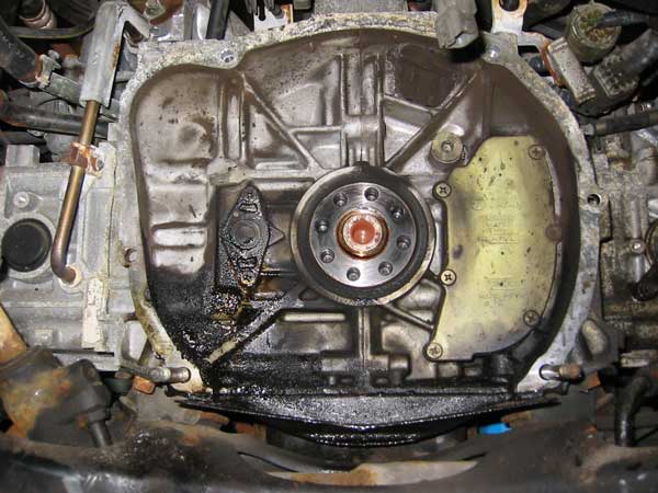

KMR replied to KMR's topic in 1990 to Present Legacy, Impreza, Outback, Forester, Baja, WRX&WrxSTI, SVXIt was just really corroded, with a combination of the suggestions here and from searching other threads I was able to get them apart. I took some screw drivers, pen-oil and kind of levering the two halfs at the split to get them apart, thanks! Now the next question, What is leaking here and how do I fix it? I bought a rear main seal beforehand but it does not look like that is what was leaking.

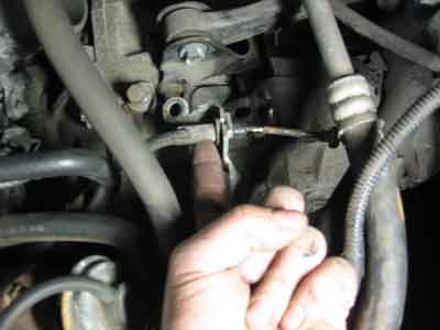

KMR replied to KMR's topic in 1990 to Present Legacy, Impreza, Outback, Forester, Baja, WRX&WrxSTI, SVXOk, I went back out and pulled the speedo cable, there was no spring clip, I think it may be an aftermarket one. Disconnected that barbell thingy, the rear trany support and everything else I could find. My question now is: are the two long bolts at the top of the bell housing (one of which is the starter bolt) and the two nuts on the bottom the only thing that holds the trany on? I pulled all that stuff and wanted to make sure I was not missing anything before I started prying on it.

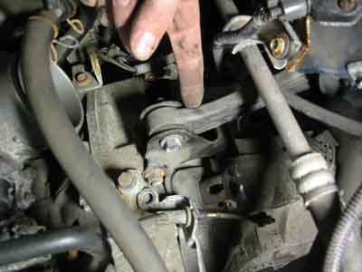

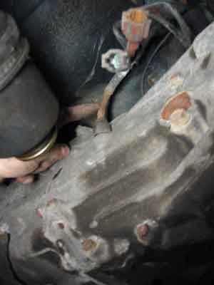

Hello all, Working on replacing the clutch on our 93 Impreza. So far it has been going great, Subaru definitely made these cars to be worked on. I would really appreciate if you guys could answer a few simple newbie questions for me. 1st. Is this the hill stop thingy? Can I just leave it disconnected? I do not like it. http://www.ultimatesubaru.org/forum/attachment.php?attachmentid=4492&stc=1&d=1166308178 2nd If I disconnect this barbell thing can I use that bracket as a lift point to lower the transmission out of the car? (I have a lift and a hoist) Or is that silly? http://www.ultimatesubaru.org/forum/attachment.php?attachmentid=4493&stc=1&d=1166308283 3rd Is this the speedo cable? If I unscrew the plastic nut/plug that is under the rubber boot can I just pull it out? I tried and It did not seem to want to move. Thanks! http://www.ultimatesubaru.org/forum/attachment.php?attachmentid=4494&stc=1&d=1166308371
