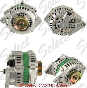

  1. Great information. So the direct fit is the 3rd gen maxima 90 amp alternator with the grooved pulley. Change the pulley out and presto, it fits perfectly. As far as changing the pulley, can I use the pulley from my 79 brat alternator (I doubt that it will fit from what I've read using search), or do I have to order one? Would I have to bore, key and machine a pulley, or is there something available off the shelf?
  2. Looks like any maxima 85 and above has a serpentine belt pulley. Do you just change this pulley out? The 1984 and below maximas look like a better fit (from pics on rock auto) but those are 60 Amp alts. Which one is the right one? Attached are the pics of the 2 alternators from rockauto. I probably need the 90 amp alt, I have fried 2 stock subaru alternators already. Lots of lights. I just want to make sure it fits with little to no problem. A little fabrication is not a problem, I've got the tools.
