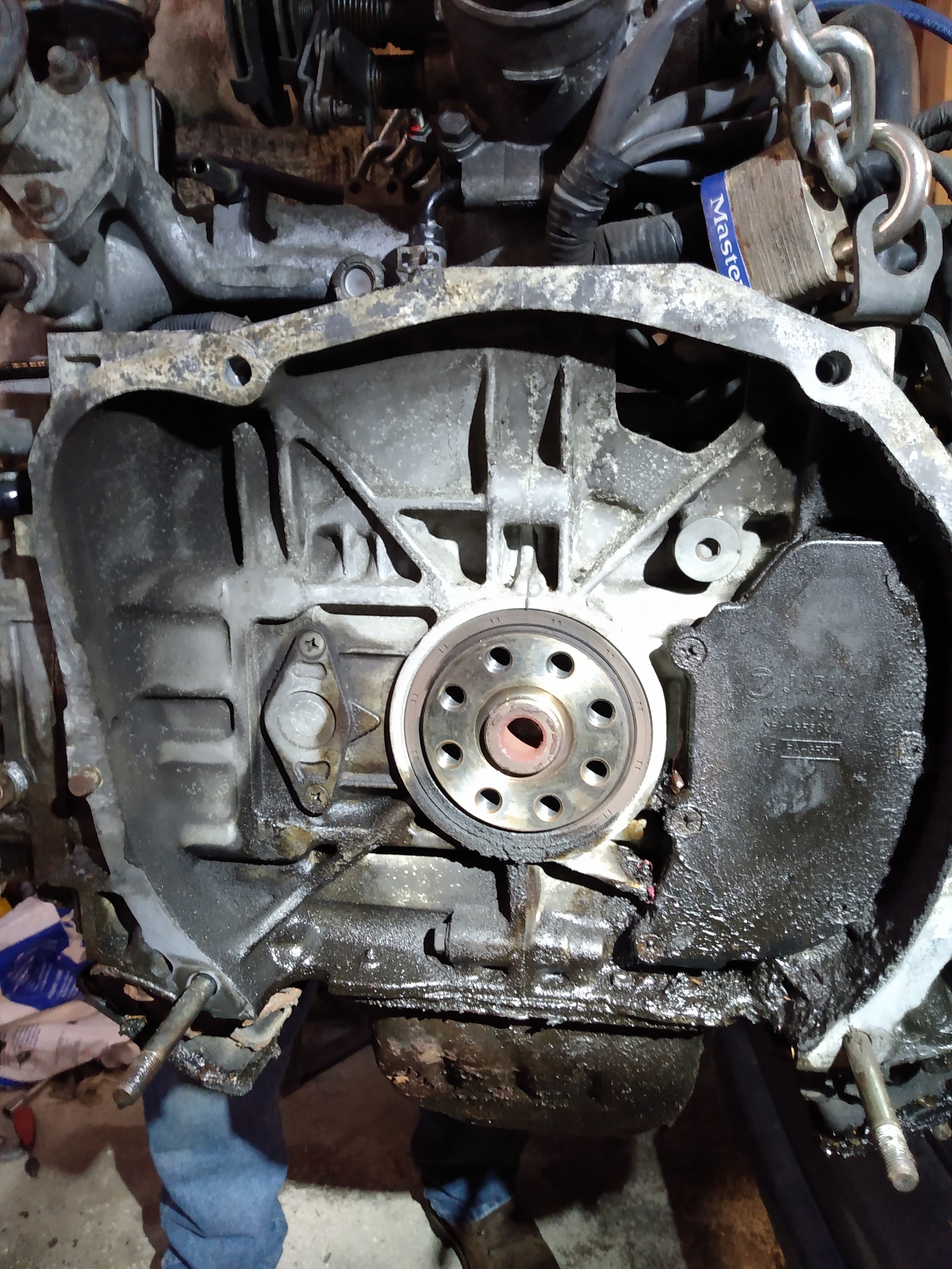

mickytrus replied to mickytrus's topic in 1990 to Present Legacy, Impreza, Outback, Forester, Baja, WRX&WrxSTI, SVXGlad I changed it. When the seal was removed. inside the two lips of the seal was completely black. and it was hard as a rock. If I find it, the seal.. I will take a picture and post. Don't know what happened to it after I took it out.
Have to do a clutch and rear seal
mickytrus replied to mickytrus's topic in 1990 to Present Legacy, Impreza, Outback, Forester, Baja, WRX&WrxSTI, SVXThanks! Yeah, It looks to me like it is leaking. how much is questionable. Nonetheless, it is leaking and has 230K on it. New clutch old weeping seal, not a good match. Ok, I will go put it in now.
mickytrus replied to mickytrus's topic in 1990 to Present Legacy, Impreza, Outback, Forester, Baja, WRX&WrxSTI, SVXWrist pin access cover thanks!.... an o-ring..... pretty standard on size ( I should find it in my kit of 100 o rings?) Yeah, I got one ........ and then the rear cam plugs.... got them coming... So like you are kinda spooking me on this rear seal....... You don't think it is leaking.? and I shouldn't really change it..... I mean I am all for the minimal approach and if OE is still working then it is better... than redoing it.......... but, the leak sorta looks like a gootee underneath the seal..... AND....... Really the proper way to do that seal........... is it to split the case? the concern is tapping it in and the inner lip sitting properly...... (even if I use that really slippery assembly luber??) Please, chime in.... thanks, Micky
mickytrus replied to mickytrus's topic in 1990 to Present Legacy, Impreza, Outback, Forester, Baja, WRX&WrxSTI, SVXOk, it is not an advertisement for Master Lok... Seemed like a quick and easy solution.... Looks like I have three things leaking It is a plastic oil separation plate.... got a metal on e to put in and looks like the rear seal is leaking....... so I should replace this as well what is the other thing ?? ??? left of the crank... Also what are the names of the rear seals on the heads? and left is like a Mushroom seal and the other is a flat seal that is bolted in. thanks, Micky
