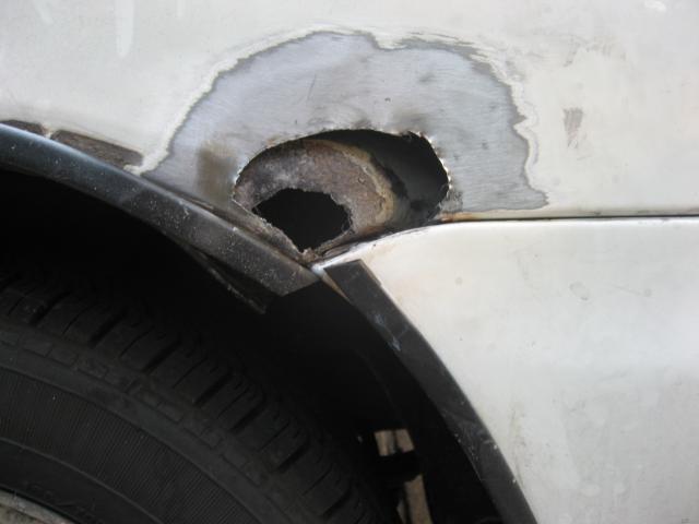

Yes, if the hose leaked then there would be no alternative to dropping the gas tank. But I feel certain that 99% of the leaks that develop of the fuel filling system are on the carbon steel filler tube because the plastic guard becomes filled with dirt that retains moisture, leading to rusting of the tube. A good question would be why don't ALL the 2.2l Subarus' eventially develop rust leaks on the filler tube. As a previous posters said, it is a good idea to remove the plastic guard. The whole problem is quite dangerous for the dealership because any future gas fire associated with the car could result in $million lawsuits even though the dealership didn't do anything wrong.
