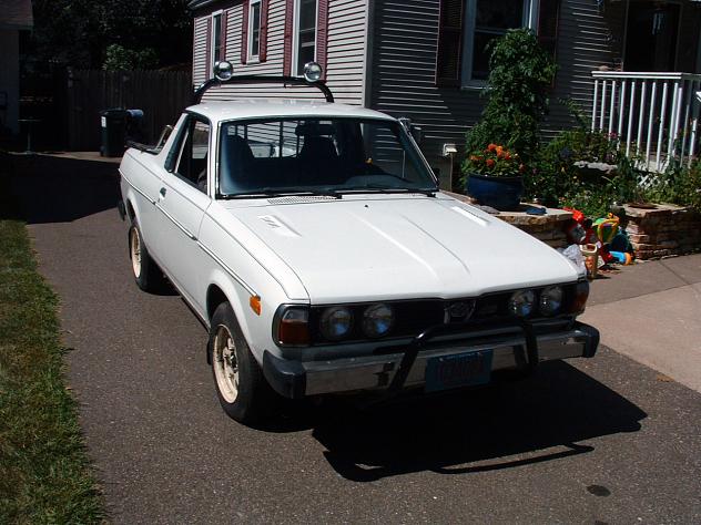

  4. Just thought I'd share my Brat w/you all. Originally from Arkansas, but now in Wisconsin. It's been sitting for a couple of years and I'm now ready to goto work on it. Just got it going this weekend -- a LOT of electrical problems -- but a new fuel pump later and it's ready to go. At least until winter, when I plan to build and engine for it. I'll need plenty of help, so I'm glad for this forum!
  5. Great-looking car. I love the color too, but it should be fun painting it.

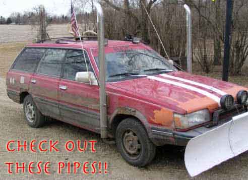

  22. Thought you all might get a kick out of this...don't know where it is...just got it in my e-mail from a friend! Hope I loaded the pic correctly...
