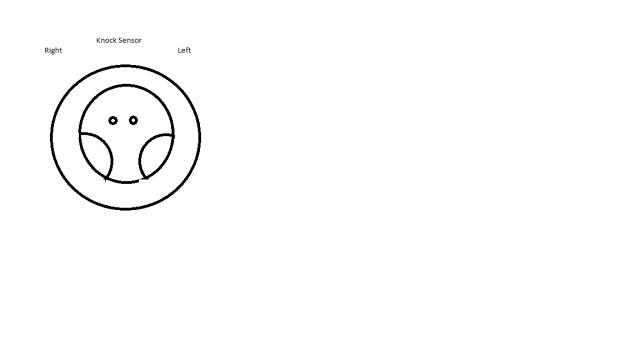

Hey there- I have an 86' 4WD GL-10 Turbo with a white two-prong style Knock Sensor. The connector broke off and I can't find it. Found a new one, but now I don't know which way to wire it. Does anybody know the orientation of the red and green wires? Or, does it matter? I know the Knock Sensor is sensitive.. Thanks! Note: The horrible picture is an attempt to draw a top view of a knock sensor (when it's installed on the engine) What I need to know is which sides (right or left) do the red and green wires go?
