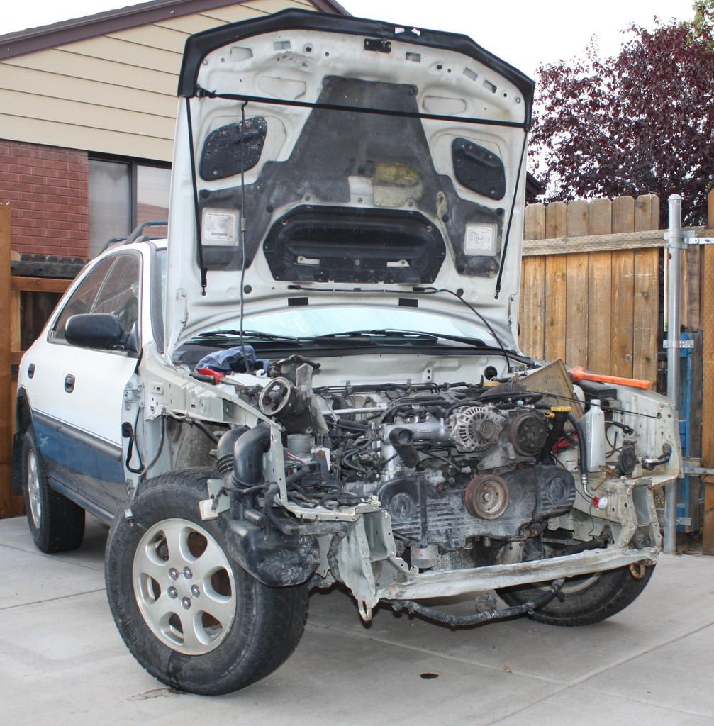

  3. I think I warped the heads when I lost radiator fluid from the deer encounter. Now its waiting for a new Frankenmotor. Ported heads, Delta torque cams, STI high volume oil pump, 6 qt Morroso oil pan, Forester water pump and oil cooler.

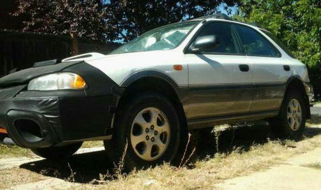

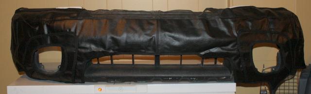

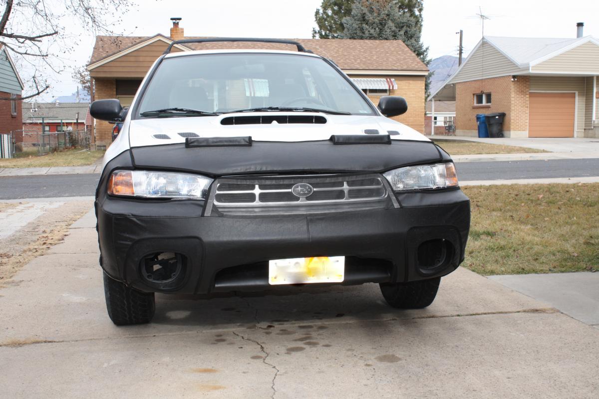

  6. <p>the hood doesnt slope at the front lip like the legacy outback does, so there is a bit of a gap when lining up with the grill. the fenders needed to be trimmed for the outline of the indicator lights, which left a gap where the stock lights mounted but covered well with the bra until I get around to patching it.</p> <p></p>

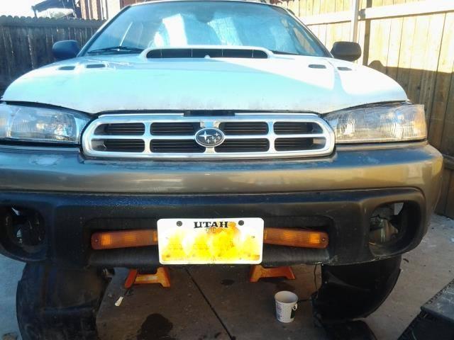

  7. loose fit and without fenders. Finally able to delete the stock 97 bumper mounted indicators/running lights since the headlights have a bulb to replace them, just needed to wire them in using a 96 plug and splicing the hot wire in while grounding the extra ground wire thats left over from the stock bumper lights.

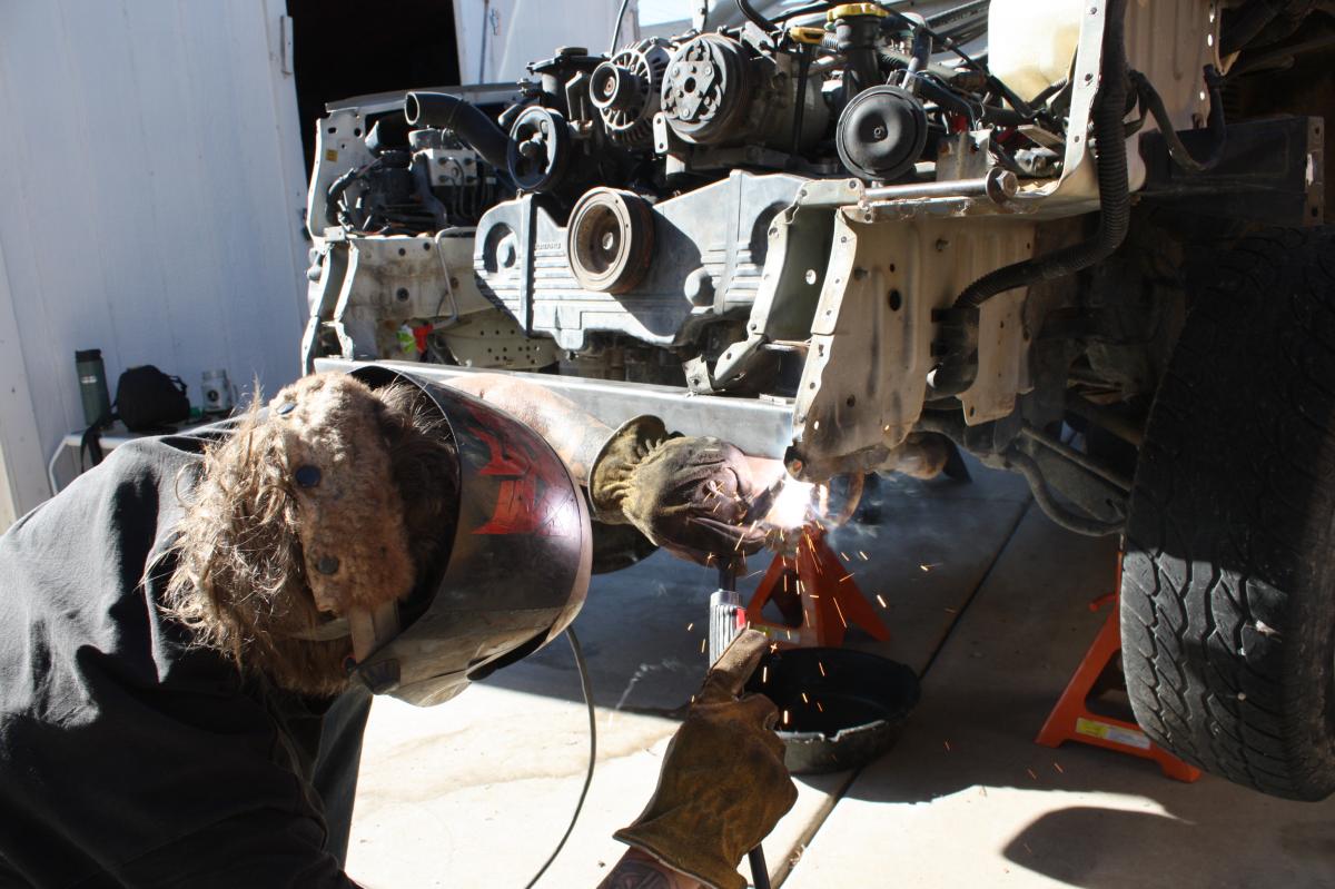

  8. Heres the 1996 legacy Outback front and top mounting. Plug welded into place and ready to roll.

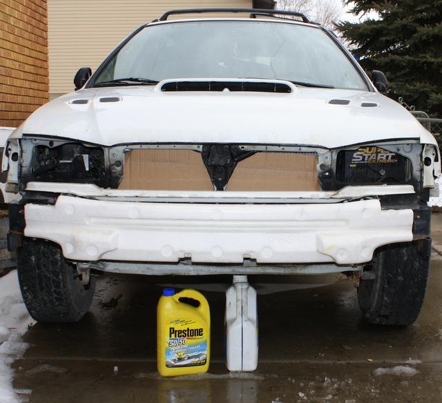

  9. I replaced the twisted bottom radiator mount/ cross bar with a piece of 2x2 square tubing. A skid plate will mount to it nicely in the future too.

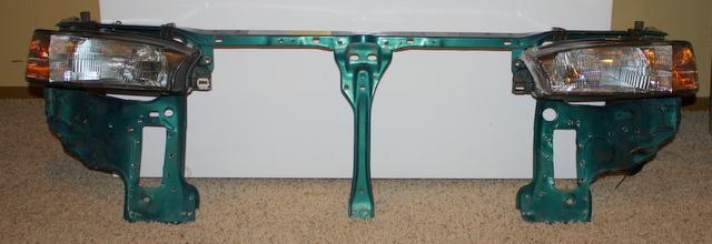

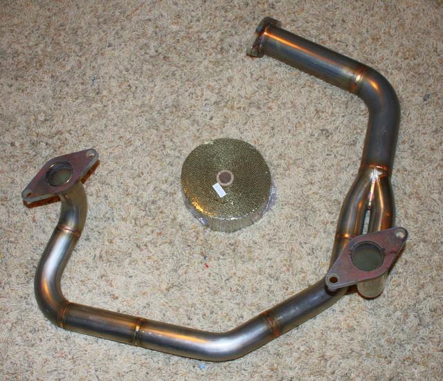

  13. Progress being made slowley, but surely. The front headlights mounting bracket is off of a 96 legacy and I picked up a new/used front bumper off of a 98 outback. I still need to remove and replace the bottom radiator mounting bracket/crossbar due to bend and warp. I could try to bend it back more but figured I might as well just replace it and do it right. The exhaust header is an e bay special but Im satisfied with the welds and bends so far, we'll see once its mounted. It ought to breathe real nice with the WRX exhaust I'll have behind it. I still need to find a front grill off of a 98-99 outback too.
