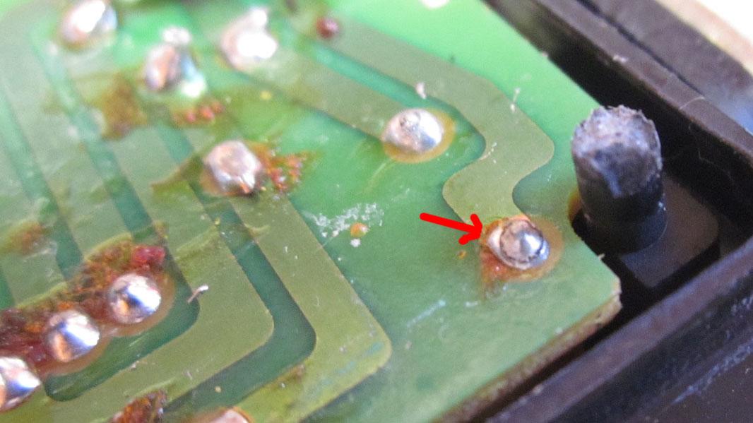

I had to snip off the plastic studs to open the control box where the pc board is. This is what I found: You might be able to see the connection that has a failed. The solder has cracked and it is intermittently making connection with the pc board. I reflowed the solder there and some other places as well. I was just wondering, how are you supposed to securely reattach the cover to this mechanism once the plastic retaining pieces are cut off? I can't believe there aren't a couple of screws holding this together. I wrapped electrical tape around the box a few times. I tested it on the bench and it worked ok. I reinstalled it in my car (what a p.i.t.a. that was) and so far so good. Thanks for your reply.

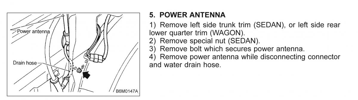

Once I took the nut off, it all became much easier. I needed as much wiggle room as possible so I removed the bracket with the 3 screws. I found the release pin for the electrical connection. There is a drain hose that's connected to the assembly and it's secured very tightly. I maneuvered the whole thing into position to get the best angle to pry off the hose. Then I realized that the other end of the hose isn't really secured firmly to an outside drain line with no hose clamp in between. (At least I think there's no clamp in between.) Then it all came out easily. Thanks for your reply.
The problem is that the antenna motor is intermittent. Sometimes when you turn off the ignition the antenna will lower completely, sometimes not. If it hasn't lowered all the way, then sometimes a few minutes later when I've exited the car and its locked, I might hear the antenna motor energize and lower the antenna the rest of the way. Other times, the antenna will not fully retract no matter how much time has passed. Initially, when strange things started happening, I would hear the antenna motor energize, but the mast would only go part way up. Now, I'd like to remove the whole thing and give it a good inspection. Attached are removal instructions for the power antenna in my 1997 GT Wagon which don't seem to match what I've found in my car. Maybe I've got the pdf for the wrong model/year. What I do have in the rear of my wagon underneath the trim are 2 screws (not just 1 that is pictured in the diagram) that are attached to the mechanism. Those 2 screws go through an L bracket and then into the mechanism. There is a third screw that attaches from the bottom of the L bracket, which is incredibly difficult to access, that also is attached to the mechanism. I was able to remove all 3 screws but things are still kind of tight in there. I can barely reach the electrical connector to unhook it. It's also difficult to see where the release catch is on that connector. Does anyone have any tips on how to remove the whole assembly? Do I need to remove the nut on the outside of the car that holds the mast in place? Thanks for your reply.
