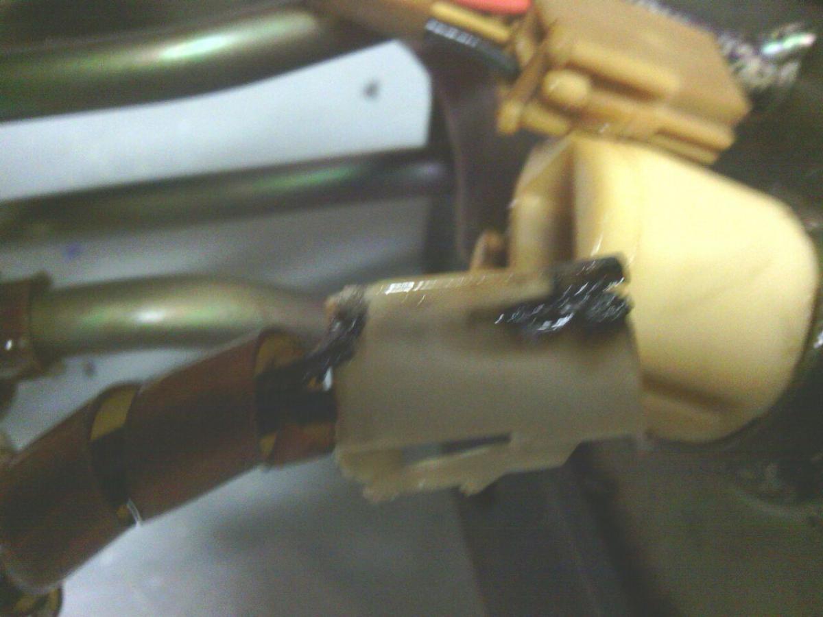

  2. Hi guys, been a while since ive been here.. Anywhoo, my subaru has been having fuel pump issues so I pulled it out today and found out that one of the harness connectors that plugs in to the bottom of the fuel pump harness connector on the inside of the tank side was burnt. I have been looking all over the internet and I cant find that harness connector anywhere to replace it. does anyone know where I can find one or if there is a way I can just repair the one I got? Its pretty bad but It still plugs in. Thanks alot! Scott

  6. okay well i cleaned up the burnt conector and made it so it made a connection again and put the pump back in the car. the pump works now and the car starts but its ticking really bad.. i think what could be due to alot of atf from the leaky power steering pump getting down in the oil through the spark plug hole that i had the spark plug out of when i was towing the car.. (stupid me) and also all the plugs are really black so im gonna replace them and change the oil and hopefully that will stop the ticking.. the idle rpms are also at like 1.5k when i start the car up.. also there is this buzzing noise which sounds like its coming from the Coolant temp sensor that runs for a couple minutes after i shut the car off..
  7. i bench tested the pump with a 12v battery and it ran fine.. i checked the relay and fuse both were good

  9. but i dont have alot of money at the moment and wanted to test it because im only getting 10 volts to it so it may be a wiring problem and not the pump. *EDIT* okay i unplugged the red and black electrical connector that goes directly to the fuel pump and the other 6pin connector the red connector is black and burnt and the plastic connector is melted a little on the red side. the black connector is silver and not burned and intact.
