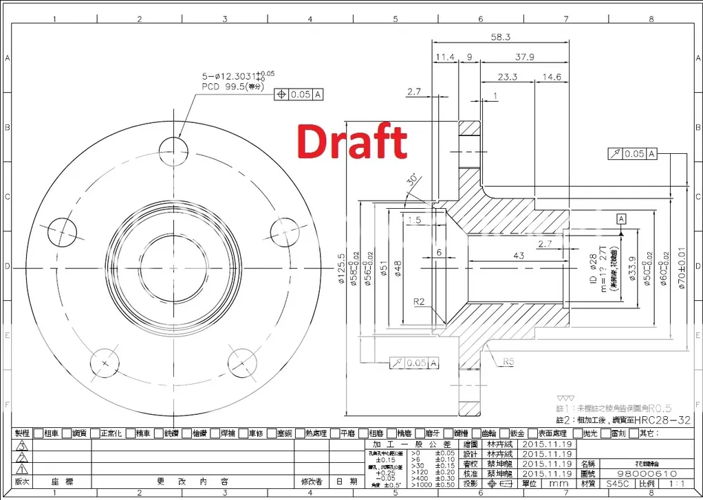

  1. Well.. I've run into a little bit of an issue. I've developed the final version of the rear hub, but the only machine shop in town that can do internal splines wants $1,500.00... I'm not complaining about the price, I'm sure it's worth it for the maount of time they will have to put into it. However, there has to be another way. If only I knew the actual dimensions of the Gen 1 Brat rear CV splines I would be able to cut that fee in half. I've been working off the attached drawing that was posted on USMB over a decade ago by a guy in Australia. The issue I have is I don't speak mandarin, and the spline dimensions don't seem to be on the drawing. Unless I'm missing somthing. Thoughts?

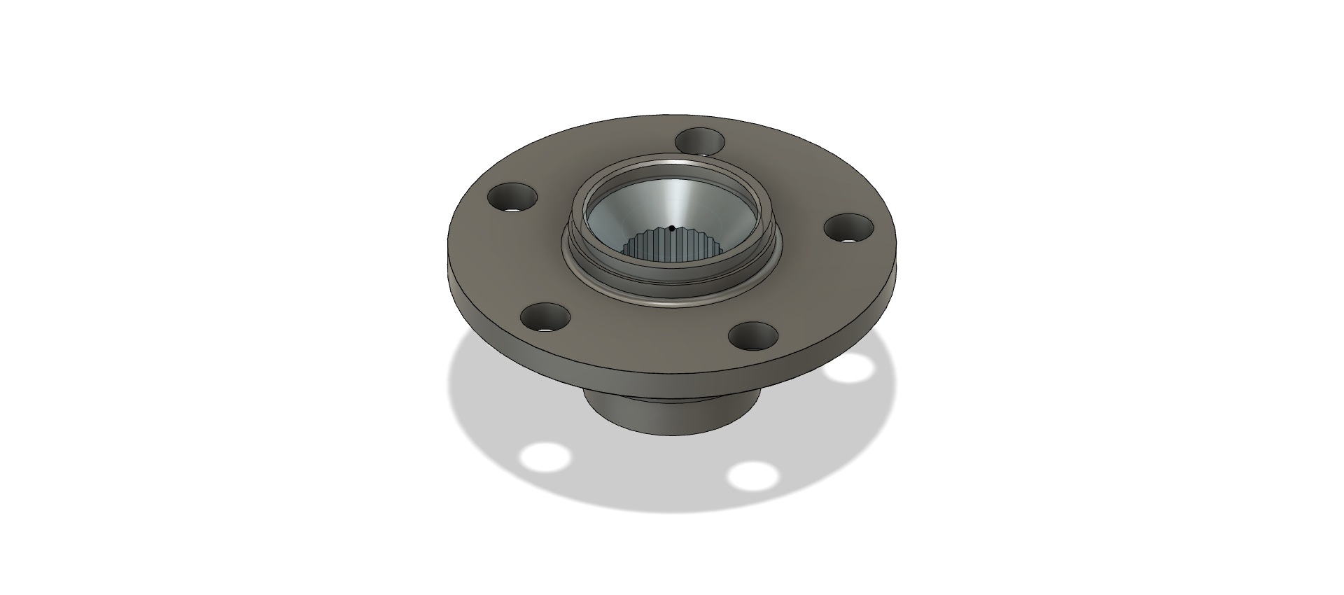

  4. I was able to successfully print the backing plate spacer this weekend. It's 20mm thick and spaces the backing plate just enough to clear the BRAT trailing/control arm. I also printed version 2 of the rear hub. Everything mounts up nicely, I just need to install the caliper and check spacing.
  5. I found an old thread on here that shared the dimension of the XT6 hubs. I then modified it from there to suit the Gen1. There are a lot of similarites. The spline count is the same 27T. Thank you! I use Fusion 360 and have been learning on my own for about a year now. Much to learn.

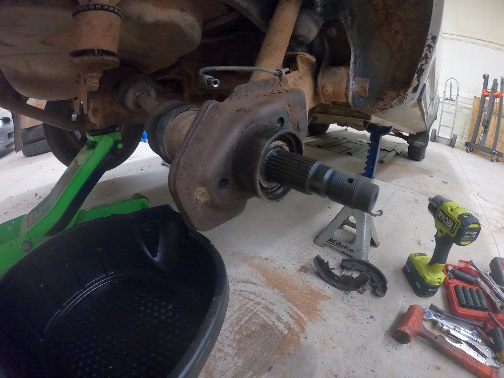

  8. Hello everyone, I'm on a mission to 5-lug swap my 1981 BRAT. The goal is not to make any modifications to the existing BRAT components. If it has to be made or cut, it has to be removable. I've been following the Subarino videos and website for some time now. Dave said they had yet to do a lot of research on the Gen 1, so I didn't bother buying their kit. I've decided to make my own. I've purchased backing plates, rotors, and brake calipers from a 1994 Subaru Impreza(GC8). This era seems to be the most versatile for this type of swap, and parts are readily available. For reference, I've attached a 3D rendering of the 5-lug hub and backing plate centering ring. Remember, these are not final, and I still have some minor tweaks to make. I went to test fit my backing plate centering ring today. While the ring works, the backing plate hits the BRAT trailing arm/control arm, where the caliper bolts to the backing plate. I'm curious to see what others have done or if anyone has some ideas. I was under the assumption that the Impreza backing plate would work, but I just realized the Gen 2 cars have a different style trailing arm/control arm. I appreciate any input and plan to share my updates and final materials once done!

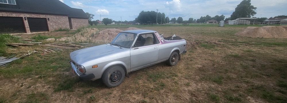

  11. Hello All, This is seems like a very odd question, but I'm getting conflicting answers. I purchased a 1981 BRAT last month, Title says 1981, VIN says 1981, but all of my research says a 1981 BRAT is a Gen 2. Mine looks like a Gen 1. See Picture. Thank you!
