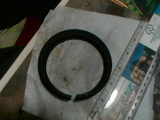

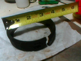

Thanks guys. Now, what to do about it?

My '86' Subaru GL has been sitting for several months. When I got it running and moved it I found this where it had been parked, sort of in the middle Anyone know what is? It's about 3.5" diam. and 1" wide and broke
