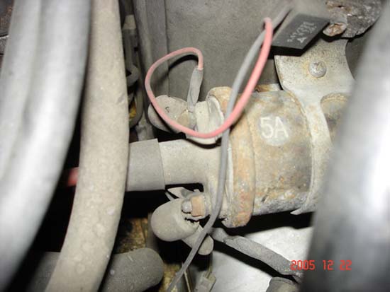

  9. Ah ok. Never thought it would look like that. Any idea what I can do about the spark? It seems like the rubber housings came loose. I'll try pushing them back onto the screws to see if it eliminates the spark issue.

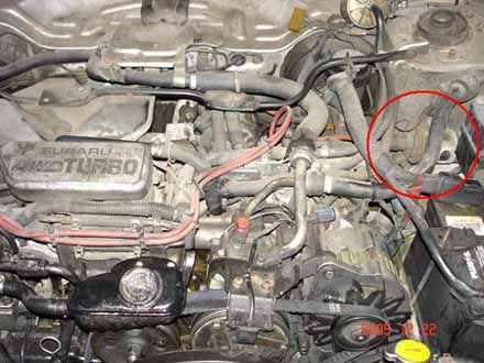

  10. Hey guys, Just replaced my belts yesterday with the help of some of you. I have another question. Check out the pictures below. What is this part for? It has a 5A on it and is right by the coolant reservoir. It seems like it's a major electrical connection point. The reason I ask is because I was inspecting the engine while idling and noticed there were sparks traveling between two screws there. I don't want to touch it before I know what it does. Anyone recognize this part? Thanks!
