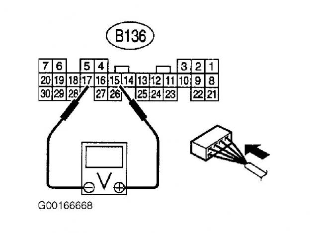

schekan replied to schekan's topic in 1990 to Present Legacy, Impreza, Outback, Forester, Baja, WRX&WrxSTI, SVXOK this thread this person had the same issue, Seems that the pins you check are 16 and 17. not 15 and 17 as the diagram shows. http://forums.nasioc.com/forums/showthread.php?t=1060234 I did that and got it adjusted. Seems to be working ok for now. Thanks for all the help offered by everyone. I appreciate it.

schekan replied to schekan's topic in 1990 to Present Legacy, Impreza, Outback, Forester, Baja, WRX&WrxSTI, SVXI found the following listed below in another forum. I have a 4 wire TPS. I think this is the info I am looking for. As per the first link it states voltage should be 4.7 closed. Any other ideas? At least this is in the balpark of the voltage for my unit. I can get to go from 4.4 to 5.1 by moving it. Also my car is Cali emission if that means anything. Unless you have the 4-pin TPS, you don't need to adjust anything. The TPS is simply a potentiometer that is hooked up to the throttle plate. As the throttle is opened, resistance is changed. That information is sent back to the ECU to know what position the throttle is in. The reason I say it's not necessary to adjust the TPS is that the ECU will take a reading of the TPS's resistance at startup. It then uses that as it's "throttle closed" benchmark. If you adjust the TPS while the car is running, you can make the idle go up and down. If you leave the TPS adjusted so the idle is high, turn off the car and turn the car back on, the idle will return to normal. However if you adjust the TPS too far, its readings will be outside the set limits in the ECU, and the ECU will throw a CEL. On the 4-pin TPS's they had the idle switch in the TPS as well. The newer cars have a separate idle switch. So on the 4-pin TPS's you would adjust the TPS based on the idle switch to make sure it's readings are correct. here's the test procedure. Last scan tells you how to adjust the TPS via the idle switch http://www.main.experiencetherave.co...S_testing1.jpg http://www.main.experiencetherave.co...S_testing2.jpg http://www.main.experiencetherave.co...S_testing3.jpg

schekan replied to schekan's topic in 1990 to Present Legacy, Impreza, Outback, Forester, Baja, WRX&WrxSTI, SVX02 outback, 2.5L. And these are the pins I am checking. So either the diagram is wrong or the voltage is not listed as correct. Does anyone have a different diagram for the pins?

schekan replied to schekan's topic in 1990 to Present Legacy, Impreza, Outback, Forester, Baja, WRX&WrxSTI, SVXOK, I install it as per Subaru, And adjusted my TPS and the idle surge is gone. So TPS is messed up. I have a couple I pulled from the bone yard that looked like they were never messed with (Still had the white paint on top screw) My problem is that according to Mitchel On Demand, the voltage at ECM B136 connector terminals 15 and 17 must be between 0.45 and 0.55 when fully closed. This has to be a misprint, i have between 4.5 and 5.0 when fully closed. When the throttle is opened it drops as expected. I am connecting it to the correct terminals according to the diagram. Does anyone know what the correct voltage should be when closed?? Or a link to the adjustment procedure.
