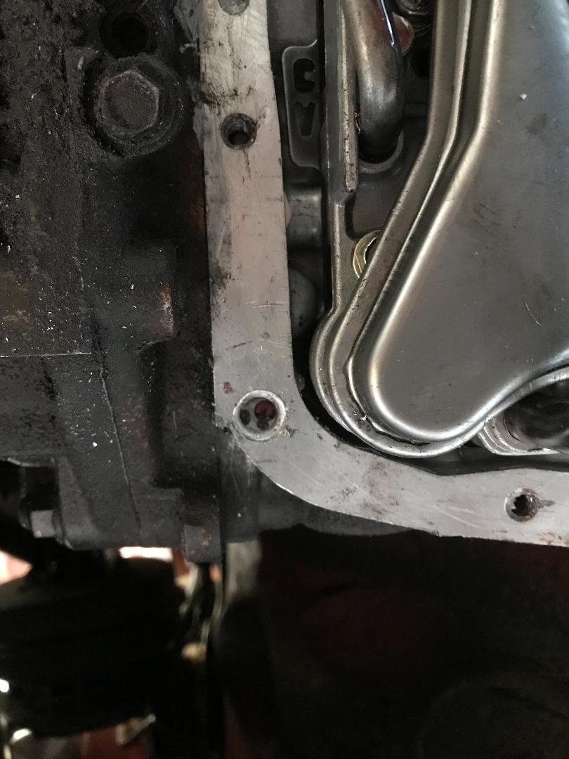

That was my impression which is sort of the struggle because I can't tap the hole. Seems the metal is so soft the hole just widens on me. If I could tap it, I'd just drill out the hole in the pan and use a larger bolt. Maybe I can get the coil to bite just enough to thread a bolt. As mentioned, there is very little torque on these bolts, just need it flush to prevent a fluid leak
