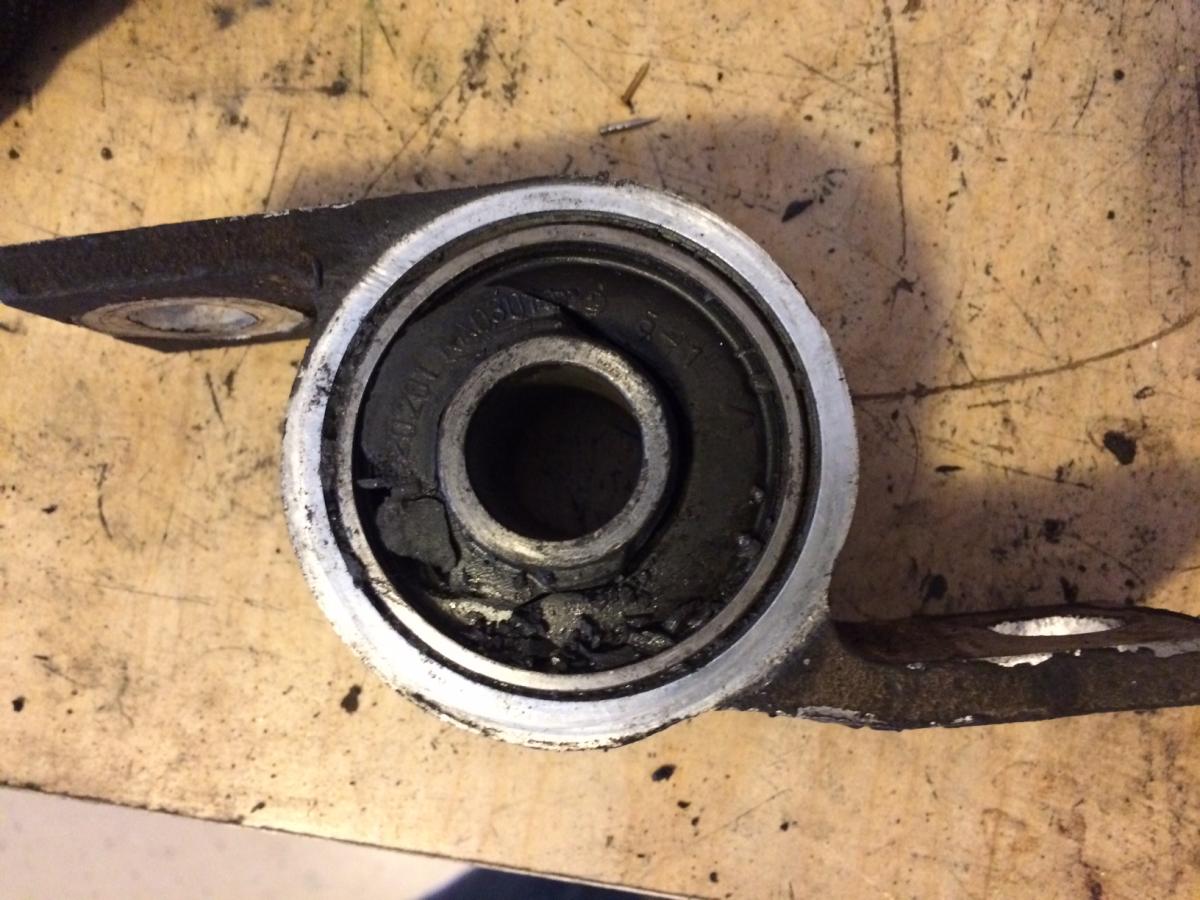

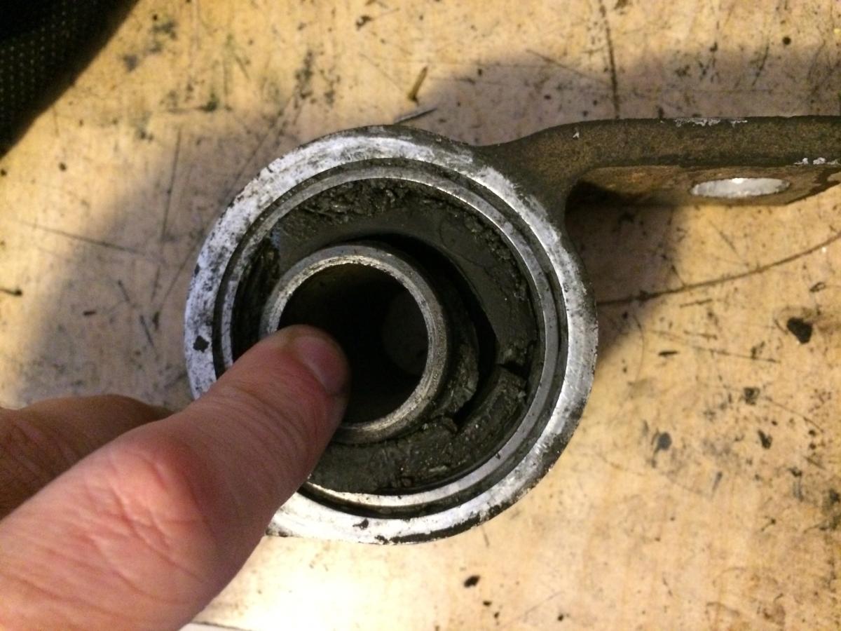

palfer replied to palfer's topic in 1990 to Present Legacy, Impreza, Outback, Forester, Baja, WRX&WrxSTI, SVXI couldn't get to that nut with anything substantial enough to break it loose, so I pulled the control arm Take a look at the bushing in the pics below.. pretty hammered. Still don't understand how the bracket moved. Anyway, I don't have a press to push out the smaller bushing. Is that one critical to replace?

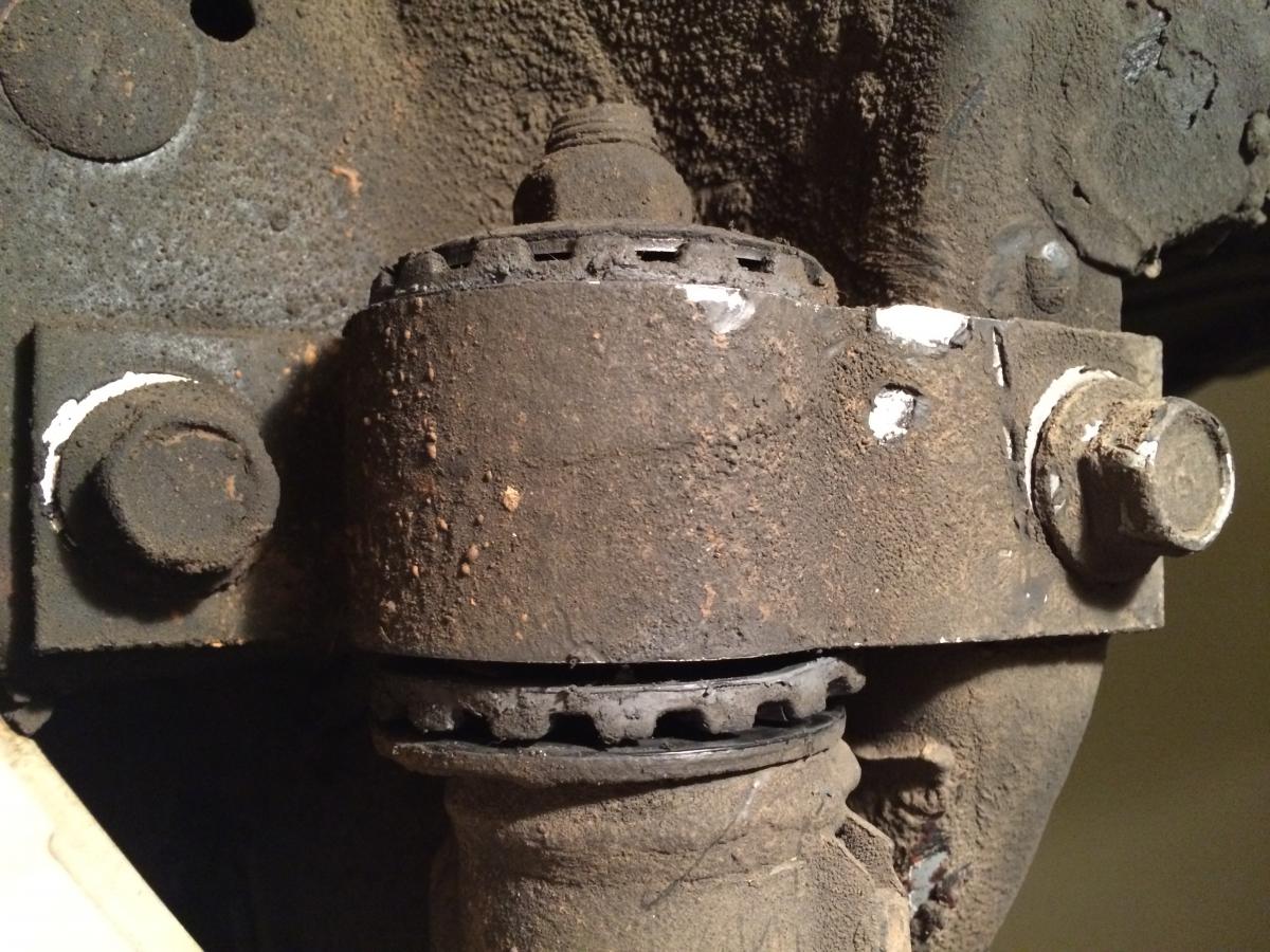

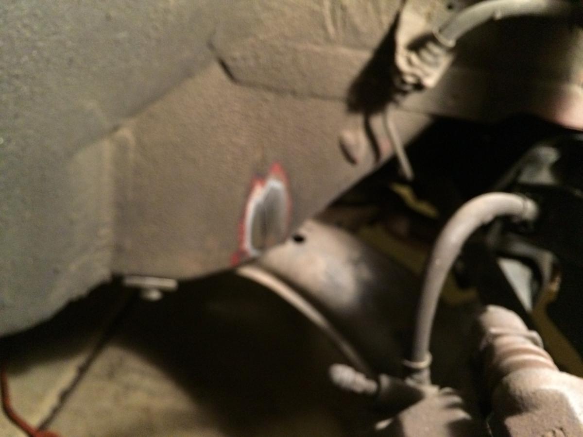

palfer replied to palfer's topic in 1990 to Present Legacy, Impreza, Outback, Forester, Baja, WRX&WrxSTI, SVXThink I might have figured this out but wanted to run by the group. Got under the car again this morning and took these pics of the passenger side. In looking at the control arm bushing, it appears from the shiny parts near the bolt heads that the assembly has shifted. Also noticed a rub mark on the inner fender well presumably from the tire on a right hand turn. Driver side has neither of these type clues/indications. Control arm bushing failure?
