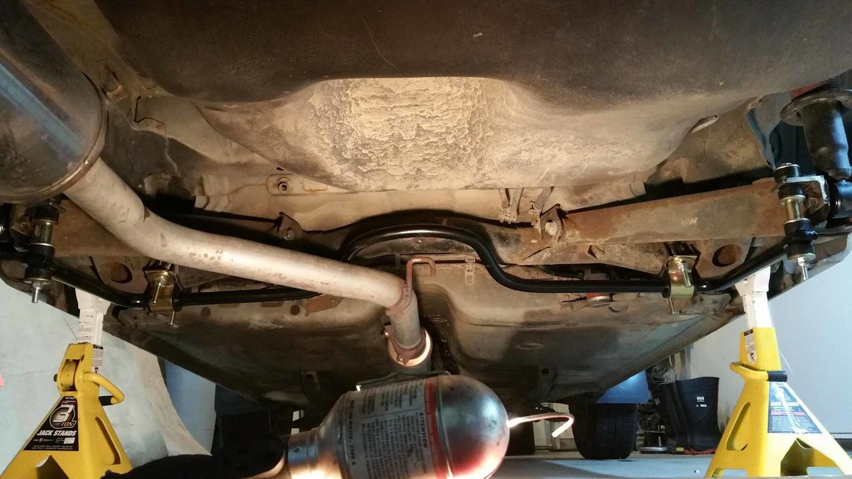

  2. Thanks for the heads up! I usually go through a set of wheel bearings in the front every year or two... I'm sure they weren't designed for the track width and lateral forces they are experiencing. I suppose as with most things on this car I will have to get creative with the rear setup. Awesome to hear you will have the coupe back on the road again soon!

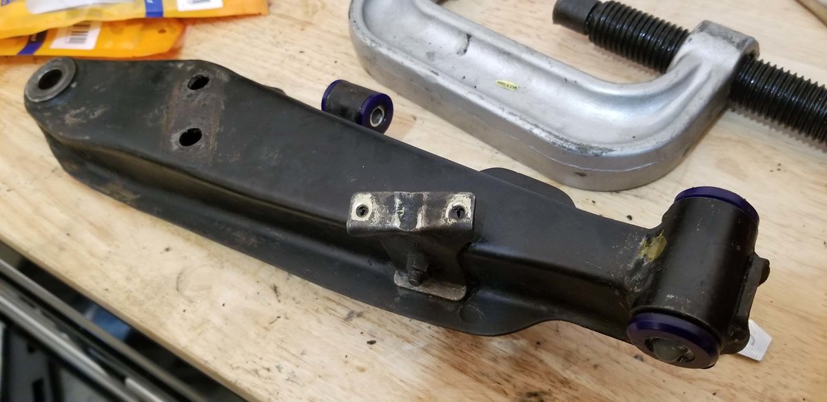

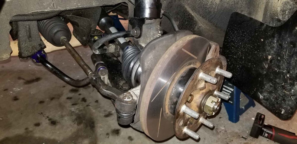

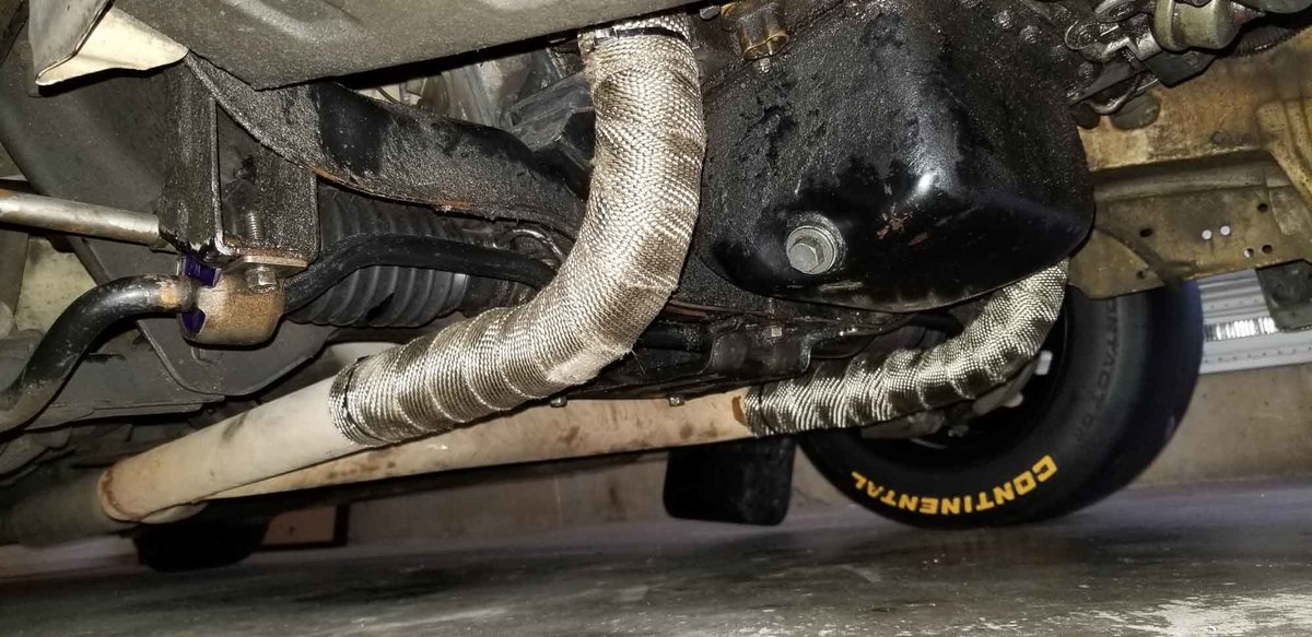

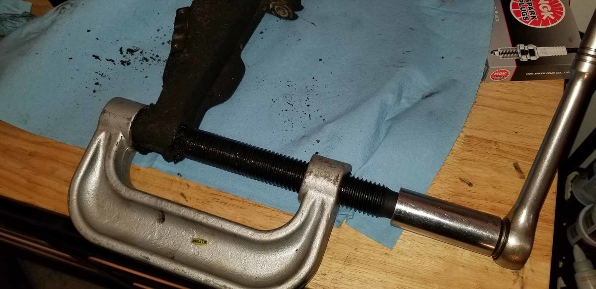

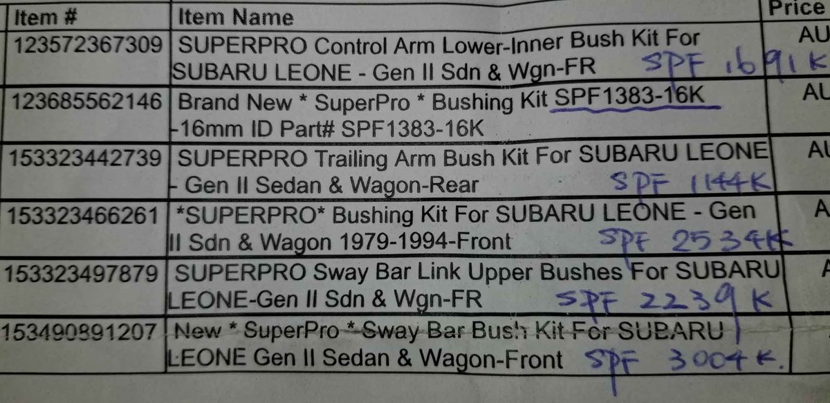

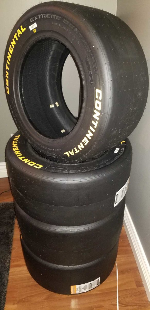

  8. After tinkering away for a few more weeks I figured Id post an update. I decided to swap the chassis bushings with poly Superpro bushes as it wouldn't make much sense running slicks with 34 year old bushings. The only bushings I was unable to find in the aftermarket were the transmission cross-member and the rear sub-frame bushings. Here are the part numbers from the ebay seller. I don't own a press but this tool was a life saver. It might be from launching on sticky tires at autocross but I seem to go through a CV axle a year and find the Cardone axles to be junk. I found this "heavy duty" set on Rock Auto from TrakMotive so we'll see how they fare this year. A rotor freshen up and new CV's, bushings, and semi metallic pads in... along with a power rack with lines looped as a manual conversion. While I was at it I decided to replace the engine and transmission mounts. In the past I've had problems with the exhaust heating up the steering rack boots causing them to crack so I decided to pick up some DEI header wrap to mitigate the problem. As you can see I had some leaky rocker cover gaskets that left their mark... rust prevention anyone? I've had great success using Remflex header gaskets on my small block chevy and wanted to give them a try on the GL manifold... this part number fits perfectly. The custom Diamond racing steelies showed up so I had the slicks mounted. The specs are 13x10 5.5" backspacing and they seem to just clear everything inboard with no rubbing. I think the setup looks pretty tough and can't wait to take them for a spin on course... til next time!

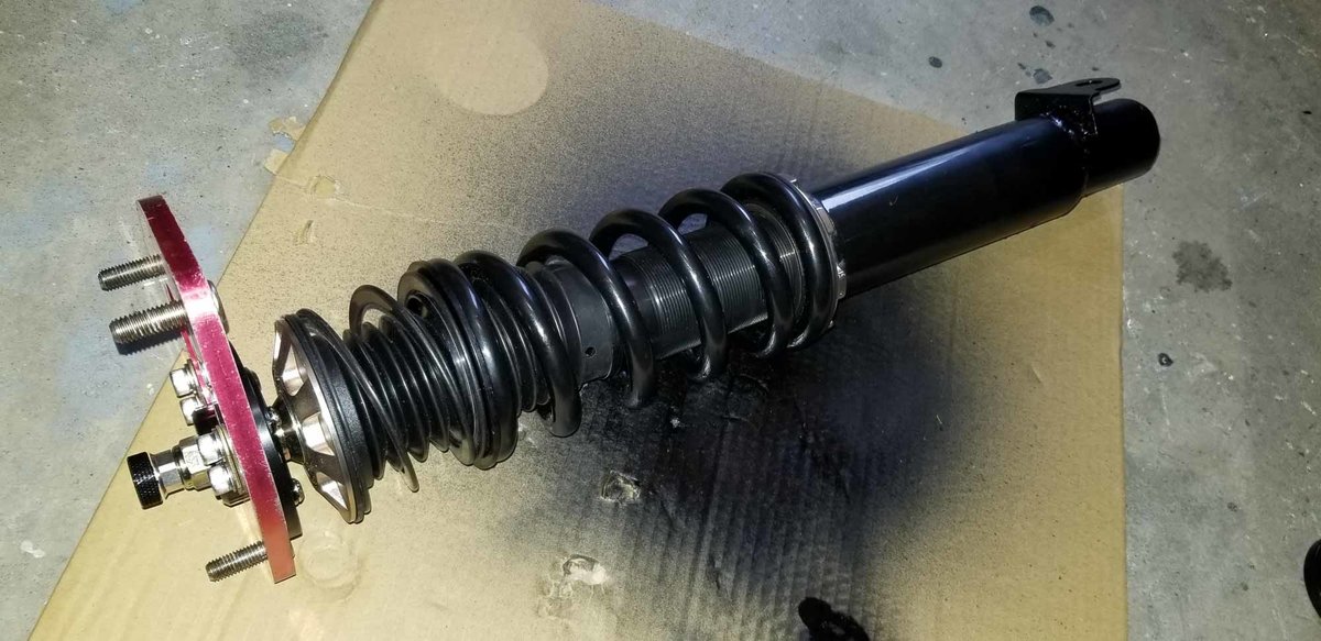

  10. Hey man, I love what you've done with your coupe... I actually just found a photo of our cars that I took at that meet and set it as my cover photo. After a quick drive on the street the car feels much more responsive with the BC's and surprisingly not too harsh. The first autocross is in March so we'll see how they hold up there. How do you like the Ohlins in your coupe? My pleasure! The car wouldn't be where it is today without the research people have done on this forum so it is nice to be able to return the favor for once. I hear yah, I'm always bouncing back and forth between this and my '85 c10... it's hard to "finish" a project vehicle when you have more than one. I look forward to seeing what you do once your '77 is complete.

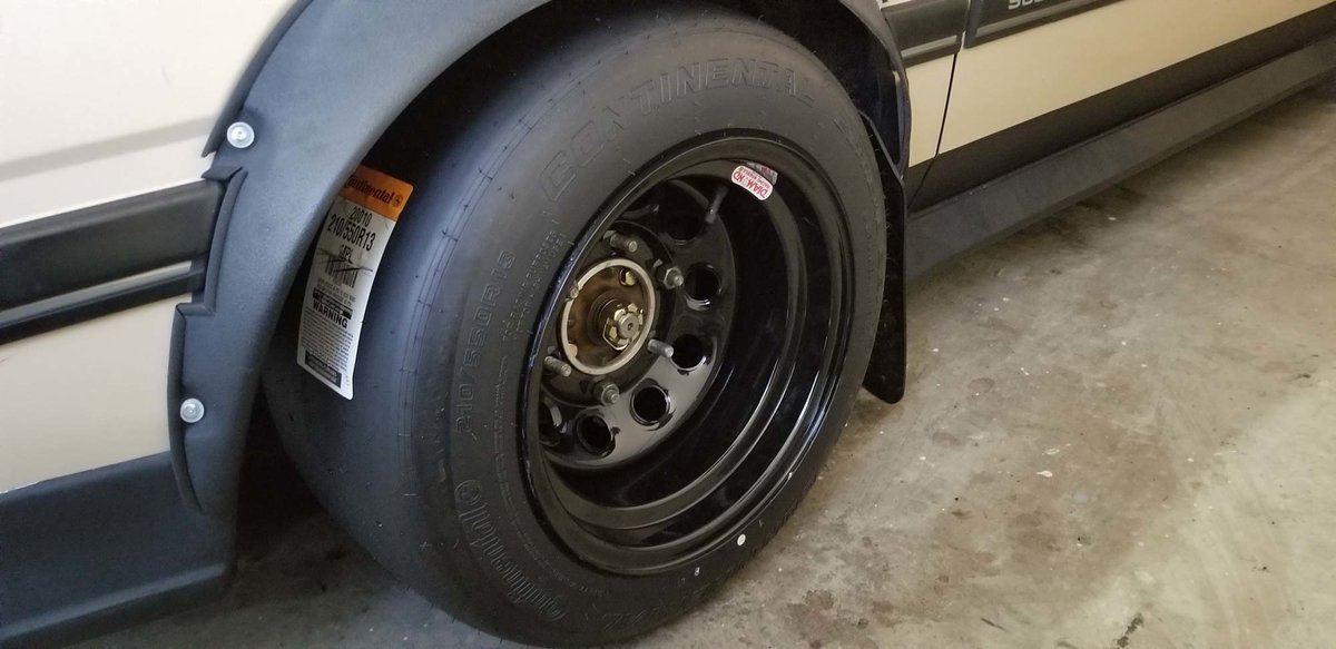

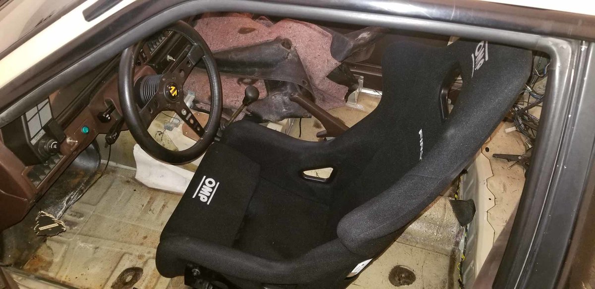

  11. Hey Everyone, I haven't posted on here for years and thought I would share my build progress and findings. The end goal of this build is to have a fun autocross machine and weekend canyon carver. To start off this car was given to me as a grad present from my grandmother 10 years ago and I daily drove it for many years before tinkering with it. The car is an '86 fwd coupe with a 5 speed. This is essentially what the car looked like when I received it at only 80,000 kms. Currently the car sits at 275,000 kms. For the past 4ish years I have been autocrossing the car on and off while making changes to improve the handling and grip. I feel this chassis does have potential and certainly has light weight(2100lbs currently) and a low center of gravity going for it. I have been asked why not jump to a newer platform such as a BRZ/FRS for autocross but the challenge of making this a competitive car seems to keep me hooked and will be far more satisfying in the end. Up until now I have made several undocumented changes to the car such as a Weber carb swap with a wideband o2 for tuning, 6 lug conversion, 15x8 -19 wheels with 225/45r15 BFG Rival S tires, Ground Control coilover sleeves with stock struts up front and KYB AGX NB Miata rears, 2002 WRX seats, slotted rotors with semi metallic pads, Momo Prototipo steering wheel, RX body kit and Datsun 240z fender flares. The car has been like this for the past couple of years but it is time to make some changes. Addco 7/8" rear sway bar added to reduce understeer and increase lift-off oversteer for rotation. Fabing up seat rails with original brackets to fit bucket seat. Omp First R bucket seat fitted to keep me in place. I have always struggled to find a decent suspension setup while maintaining stock hubs and I have finally come up with the answer. The BMW e30 chassis has the same diameter front strut tube at 45mm. This allows you to fit a BC Racing coilover weld-in kit designed for an e30 on the front along with GV Impreza coilovers for the rear. The folks over at BC Racing allowed me to place an order with the BMW fronts and the Subaru rears. If anyone else decides to go this route the part numbers are I-04-BR for the front and F-08-BR for the rear *You will have to use Impreza camber plates up front as the BMW bolt pattern is different up top and the stock shock mounts out back*. Since this car is no longer a daily driver I decided on 10k springs up front and 12k springs out back. All you have to do is chop off the factory strut, slide it into the coilover base and weld it in. I decided to chop an additional inch off the coilover side to get the desired ride height. Here is the finished product with GC Impreza camber plates up top and helper springs added to get the desired ride height. As you can see this setup allows you to gain much needed camber/castor adjustment as well as dampening/rebound adjustment. This is how the car currently sits with the new BC Racing suspension in. Next on the list is 10" wide slicks on a 13x10 6 lug wheel. I am currently having Diamond Racing wheels built to spec and will post an update when they arrive. Now that the suspension is in order and a racing slick setup is on the way chassis flex is going to have to be addressed. I picked up this roll bar kit locally off craigslist for an s10 pickup and it seems to be a pretty close fit. I have begun the planning process and will post more updates as the progress continues. Thanks for reading and feel free to ask any questions regarding the build. Cheers!

  13. Small update... Since adding the FJ60 wheels and flares I have added ground control coils and purchased some BFG Sport Comp 2s 195/50r15. Was able to get an inch or so lower and the car handles pretty good now. Also plastidipped the wheel centers and grille for a little more contrast. Next on the list is tracking down a rear sway-bar and replacing the worn out control arm bushings.

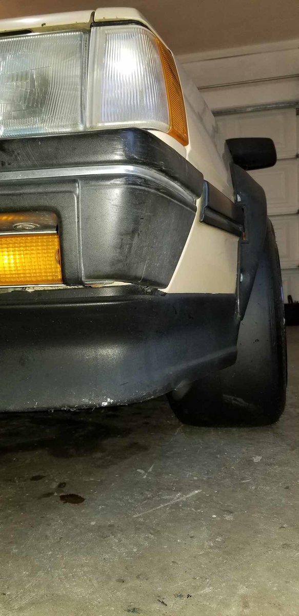

  24. Hey all, So, Ive been doing some searching on leveling out the front of my car with the back (front sits about 2 inches higher than back). From what I have read it looks like I just need front 2wd xt struts and springs and I should be good to go. Just seeking confirmation on if this is correct or not before I get into the project...Also, just wondering if the xt strut/spring combo is a direct bolt on or not and what year(s) will work. Thanks in advance, Chris PS. Here is a couple of pics to show the current ride height...
