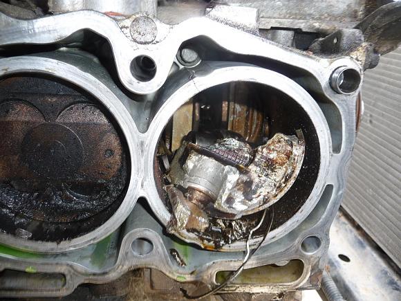

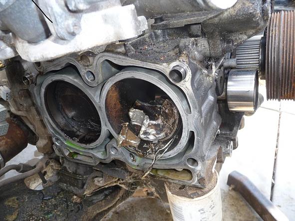

pulling EJ25 heads on 96 outback engine in car?
jelly man replied to jelly man's topic in 1990 to Present Legacy, Impreza, Outback, Forester, Baja, WRX&WrxSTI, SVXJust pulled the right head. I didn't even remove the intake manifold just undid the 4 manifold bolts. Dropped real easy. Thought you might want to see the results. What would make a piston crack at speed? The valves were retained with keepers in place. The wrist pin is still free in the rod and the rod has an s bend. Thanks much for the advice!
I've got an EJ25 with mechanical problems. The engine only turns over 90 degrees even with the timing belt off and the cams released(valves shut). The outer electrode on spark plug #1 was smashed over the center electrode. I can only take off one torque converter bolt. I don't want to make a mess by taking the torque converter off with the engine. I'll have to take the heads off afterwards to recover the torque converter anyway. Is there enough room to remove the heads inside the engine compartment????
