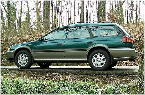

I have a 1999 Subaru Outback wagon, I believe this is the "generation 2" wagon (see attachment)
I'm doing new suspension all around, and I have KYB-GR2's on order and was looking to pair new springs with the new struts.
Will Springs from a generation 3 outback wagon work on my car ? I
believe this is the ~2000ish year Outbacks. Inquiring because I'd like
to put the Rallitek Overload springs in my car:
RalliTEK Rear Overload Springs 1998-2009 Outback / 3rd +4th gen Legacy - RalliTEK
They say 1998-2009 but say Gen 3 & 4 only. Had to google to find out my car was a Gen 2 Outback. -
