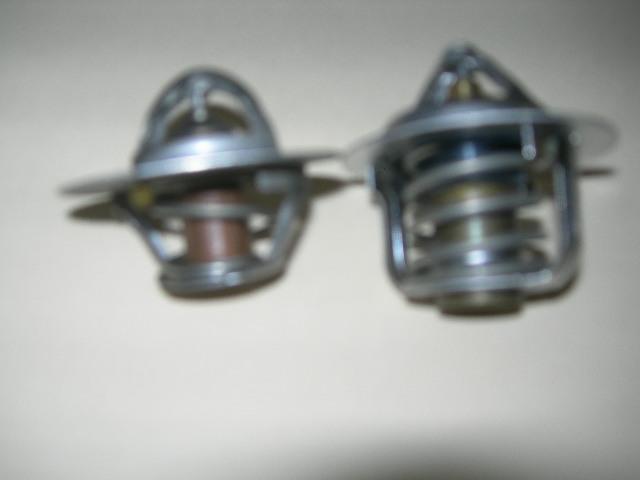

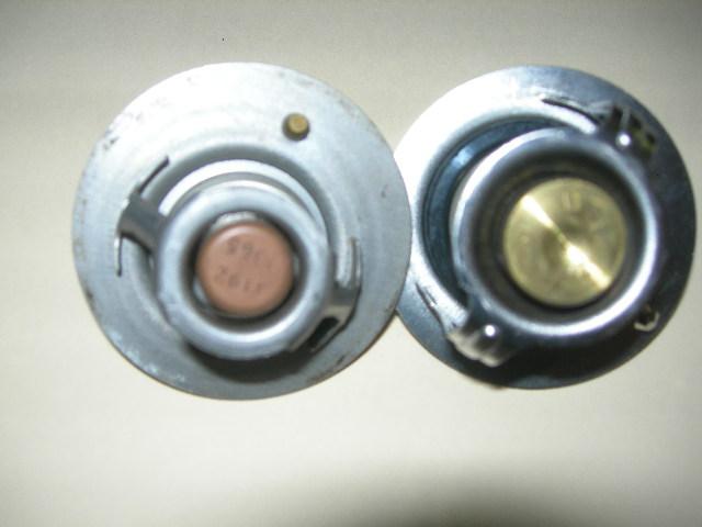

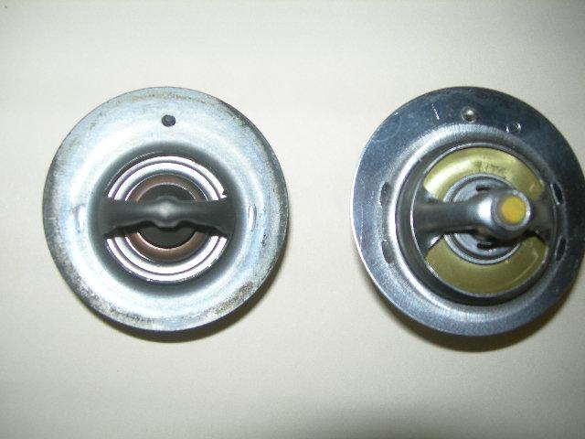

Just finished putting a 'stat in my 84 turbo wagon. You really want to spend the $22++ dollars to get a Subaru original 'stat. Very big difference in size of opening and much heavier construction. Much like my four way bypass and cow valve. Priceless !! Alan- 8 replies

Read all the advice on my overheat problems. Many thanks for the help. Bot a Subaru stat today. No comparision to the after market, or the one I took out of the Turbo. Size of opening, size of spring wire, diameter of heat element. Worth the $22.++ paid for the "original". Took out the fan clutch and its fan. Installed one fan from a SAAB. Had to trim the support arms, but went in fine.

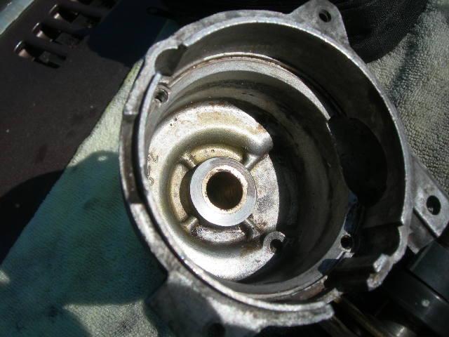

After much help from "The Guys" here, the wagon is a jewel. Two relays under the passenger carpet, I finally found them, were rusted to death. Replaced from O'Reillys. Still would not idle. Tach would bounce, then would stop running. Yes, it was the Dizzy. Worn upper bearing. Had it machined out and replaced with an oilite bearing, watching all tolerances. $3.58 at a bearing supply house. Friends work was a freebie. :-))) Pic of the installed Oilite. Now to pass California smog test. Quart of Lacquer thinner in tank, should clean out old gas and gum. Alan

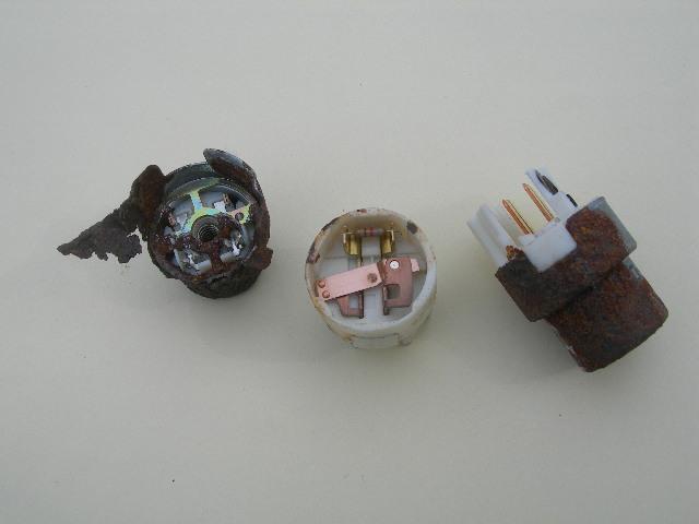

Found the answer !! Relays under the passenger seat, under carpet were rusted beyond function. Replaced both from Oreillys, at half the NAPA price. Plugged in, started up !! Runs fine. Just needs a little limbering up. Thanks to all that helped. -
