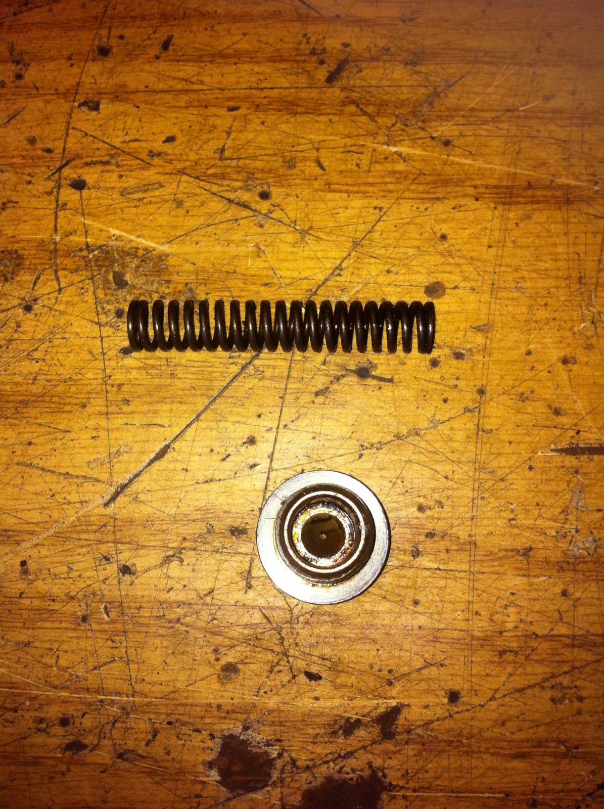

  2. it started very odd sequance of things going wrong first my battery was dead got a new battery and would crank but wouldn't start still and took a look under the good and noticed my driver side timing belt had shredded almost fillet it's self the oddest thing I've ever seen it do. I just changed the belts 4 months ago pretty much brand new changed the belts did the right sequence timing was fine. started it and it bogged wouldn't do go past 1000 rpms no matter how much I pushed the gas nothing and instantly after it started the oil pressure gauge jumped all the way to the top. then it erupted oil out of the first oil filter. and I've been stumped since. and yes I use fram micro guard but I've always used those and that shouldn't make my oil pressure rocket up like that. here's a pic of my oprv on the oil pump. does it look right idk what I'm looking for

  6. I have a 90 subaru loyale that I believe has a faulty oil pressure reliefe valve. I know of the one on the oil pump. I believe there are 2 more can someone tell or show me where these are and also what am I looking for when I pull them put the one in the oil pump has a spring and the I'll call it a hallow bolt that holds it. i don't know what a faulty one would look like.
