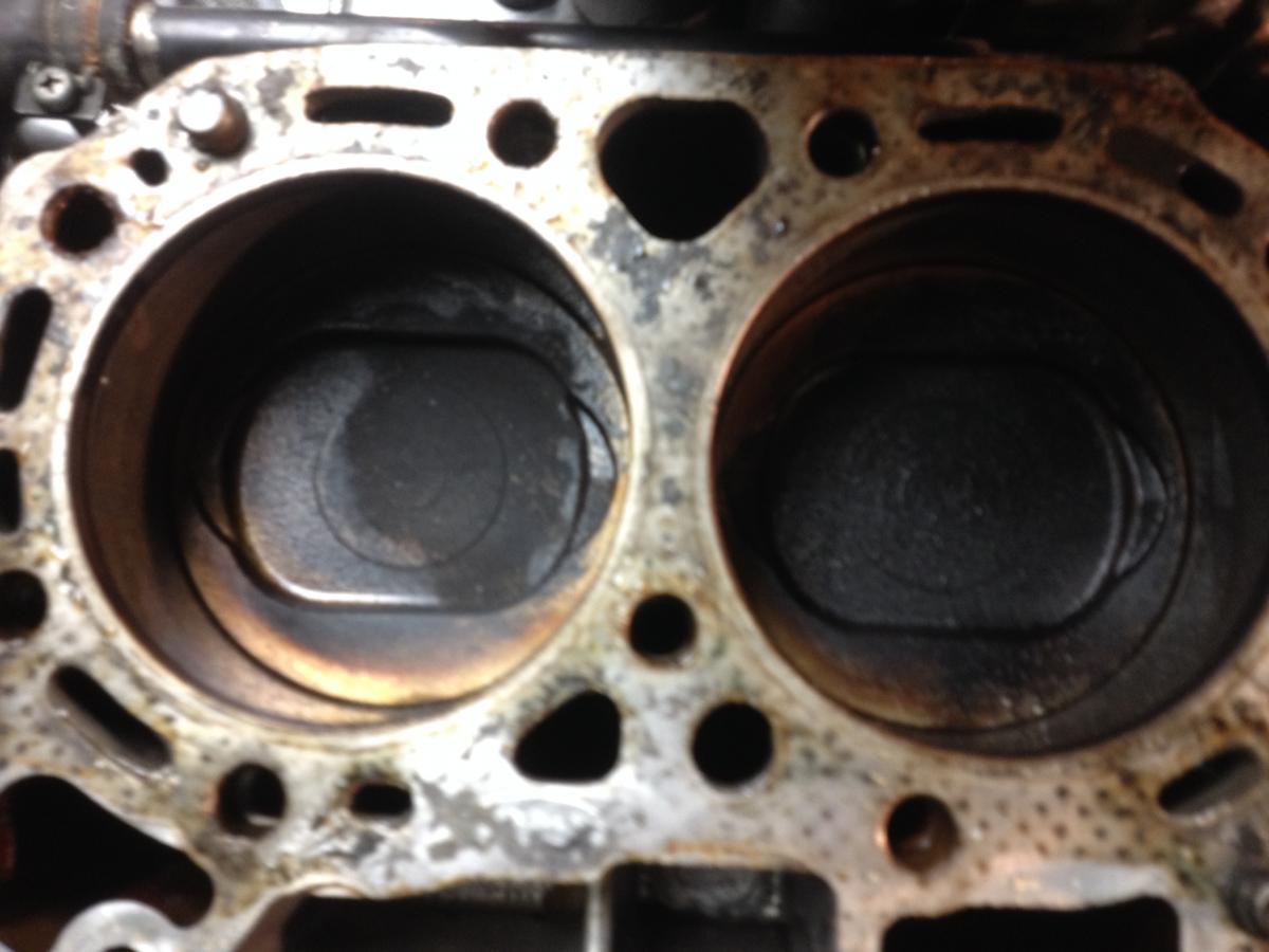

94 Loyale EA82 Turbo Head bolts
dherzog1984 replied to dherzog1984's topic in Old Gen.: 80's GL/DL/XT/Loyales...
Thanks, I will remember that. -
I see a lot of differences in sequences and torque specs that people are posting all over the web. I want to be 100 percent certain I am doing this right. I have a 94 EA82 Loyale Engine with turbo, blew a head gasket. Now I've got it apart and need to put it back together. I need Torque Specs \ and sequence. Is there anybody out there that can help a brother out?
