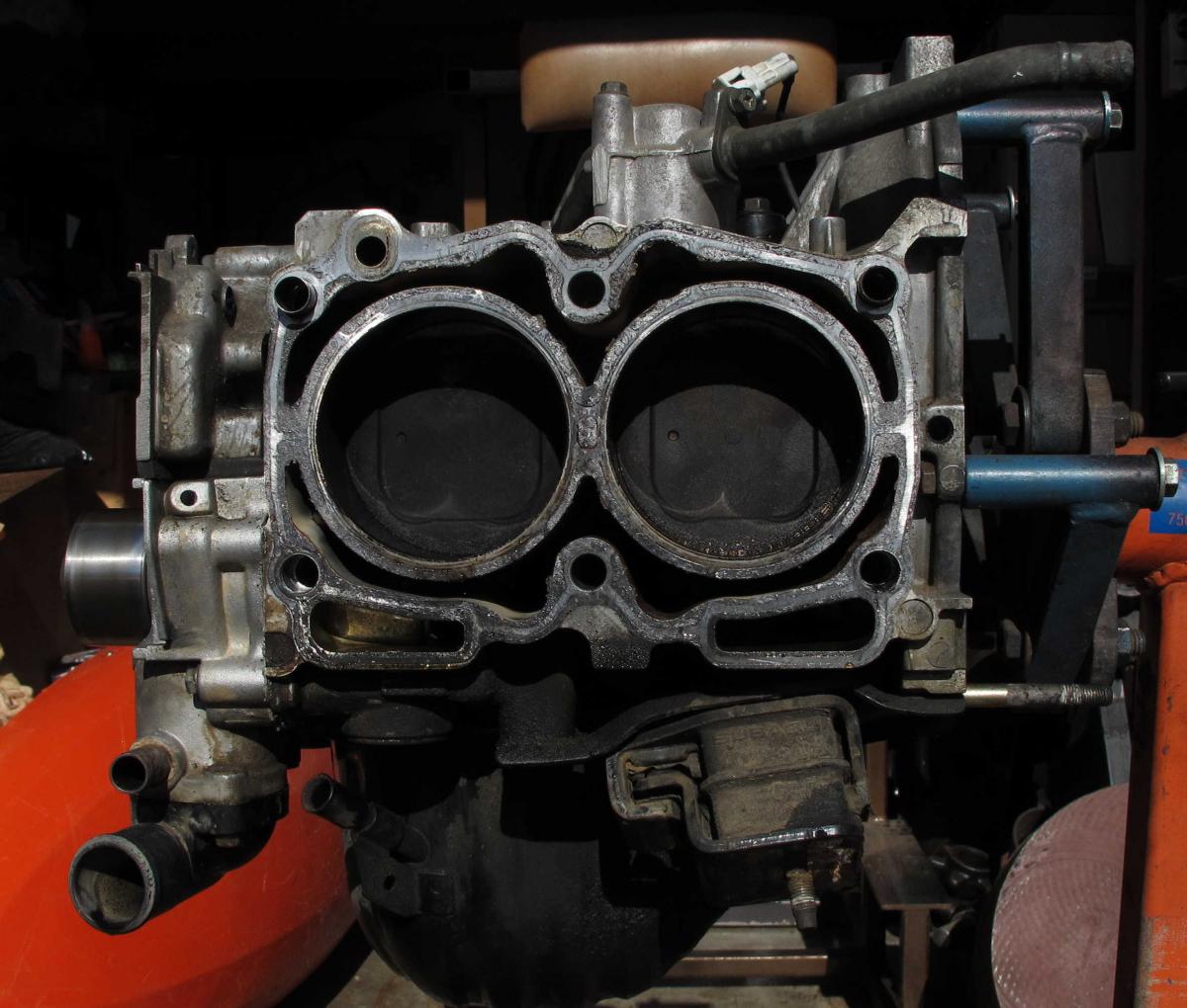

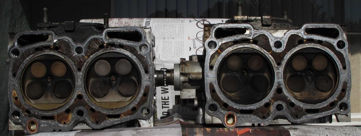

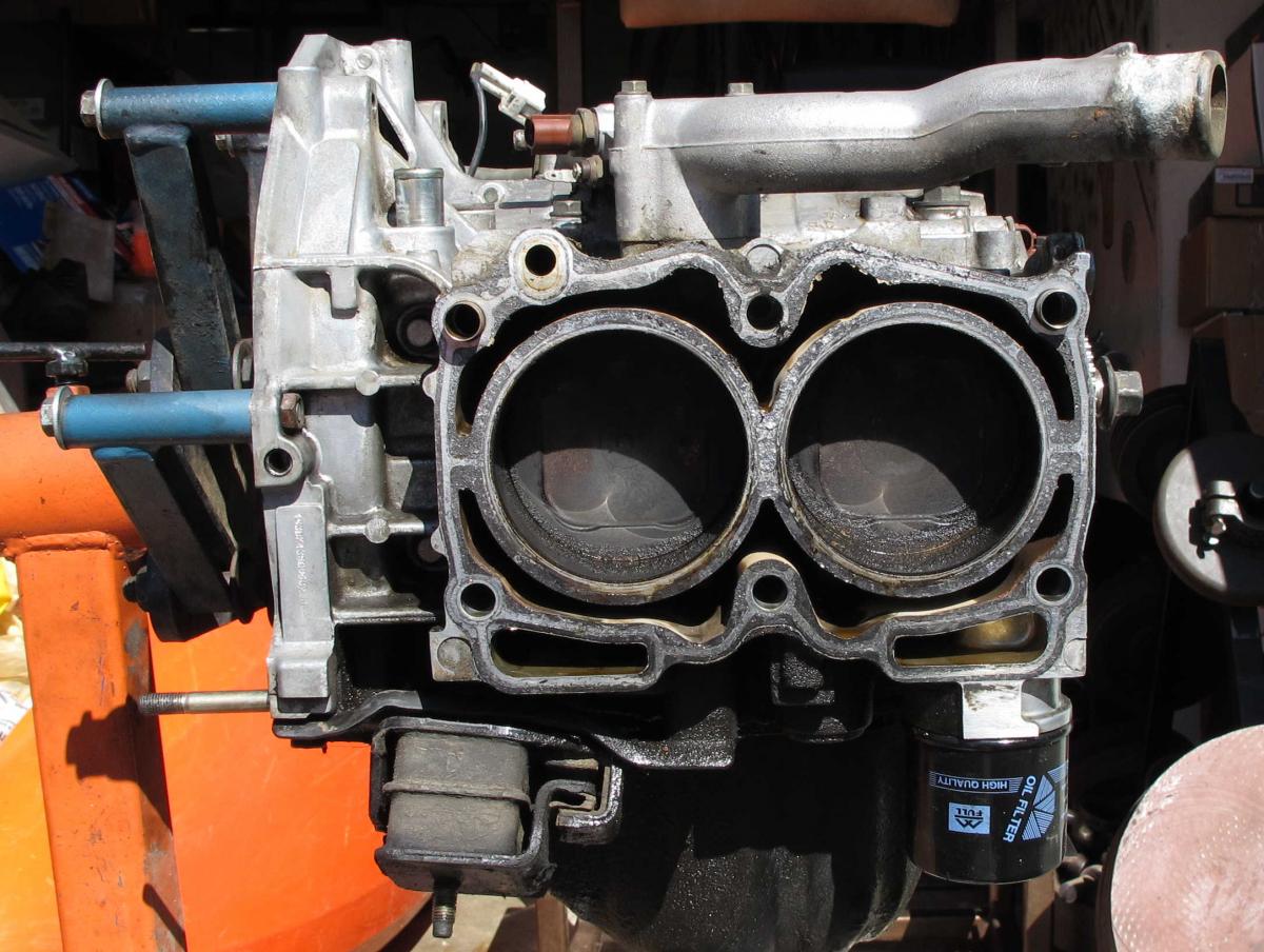

Thank you Fairtax! The heads are in the machine shop now. The guy took a look at the block and said that I'd rather change the rings "while in there". The block isn't perfect, there is a very small dip right in the middle on both sides, but he thinks it'll do.There is a line, so he can get to my order only some time next week. He said he would check the valves first and let me know before doing any resurfacing.

I felt something fishy when I saw a little bit of oil coming out at the bottom of the cylinders under the pistons on the engine right side while the engine on the stand. Is that from bad compression rings? The left side looks ok, clean. And the compression ring fix requires to take apart the short block ? If so, I'm not gonna do it. The seals that come with the mizumo timing kit, brown color, I believe for the front end components, they are ok, right?

Working slowly, I have taken the motor out of the car and disassembled it. Here are the things that annoyed me so much: 1. Right lower bolt that holds the engine to the transmission had the nut missing 2. Plastic covers in front of the motor are melted 3. Manual transmission, but an anti-bump cover that keeps the timing belt snug on the the crank pulley was missing 4. Idler pulleys sound like rollerskates. I looked at the PO's bill for the last timing belt service, and it said that only timing belt and waterpump had been replaced. And the belt and the pump do look newer and cleaner than all other front components! From what I've read on the forums and seen on youtube, the right HG was certainly leaking while the left one stayed more or less ok ? I've got no machinist straight edge and can't do the measurements yet. Please take a look at the pictures of the block and heads and let me know what you think. Is the engine still worth HG replacement?

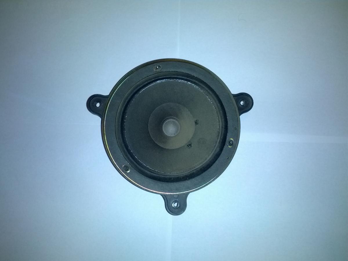

climbing4life replied to Bushwick's topic in 1990 to Present Legacy, Impreza, Outback, Forester, Baja, WRX&WrxSTI, SVXYou can use a flashlight and look through the grilles. Factory speakers look like this. With your amplifiers you would probably benefit from new speakers. I was really surprised that the original speakers were not junk. In most cars they are, and new speakers is the easiest way to upgrade the sound even when keeping the factory head unit.
