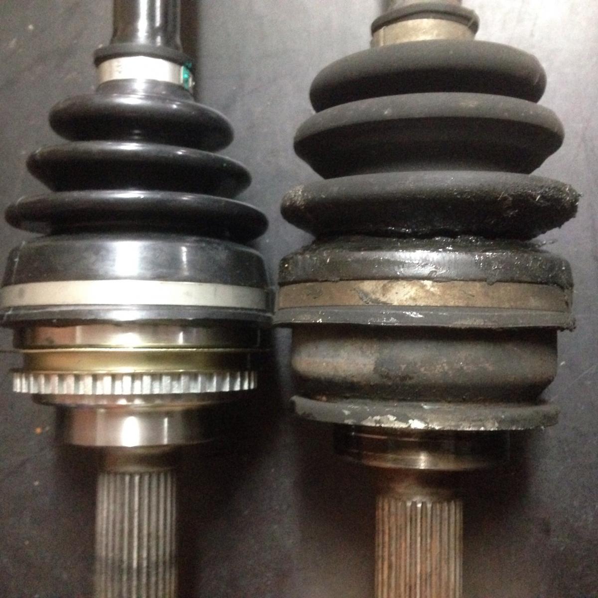

ScottAust replied to ScottAust's topic in 1990 to Present Legacy, Impreza, Outback, Forester, Baja, WRX&WrxSTI, SVXSorry the second picture is a little deceptive. The old ones were stretched out and the new were pushed in. Pushing them to the same position the New one is shorter but only by 5 millimetres. Checked the invoice and it says 1996 to 2003 outback and the part numbers in the box do match that

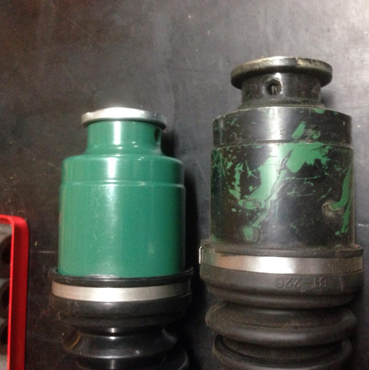

Hello all, I have just pulled the first Front CV shaft from my 1998 gen 2 outback and the new shaft I bought is different, The seller assured me it was correct but I couldn't know the difference until I put them side by side. Have I been stuffed around and given the wrong parts? Do I need to return these and get the correct ones or do these work just look different? Thanks Scott Ps. Being it's Sunday and I will have to return them in a weekday I am a little Sh@@@@d off that the car will have to sit in the shed for at least a week if they are wrong !
