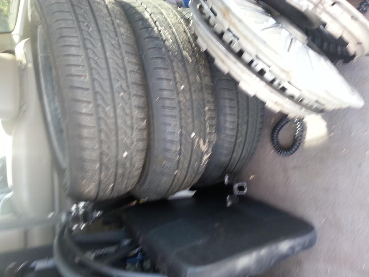

lstevens76 replied to lstevens76's topic in 1990 to Present Legacy, Impreza, Outback, Forester, Baja, WRX&WrxSTI, SVXmy pretty looking basically brand new set of toy eclipse I found on CL for $100. That was all 4 tires, rims, and hubcaps. they came off a 1994 Plymouth Sundance it was rear ended two weeks after the tires were put on.
