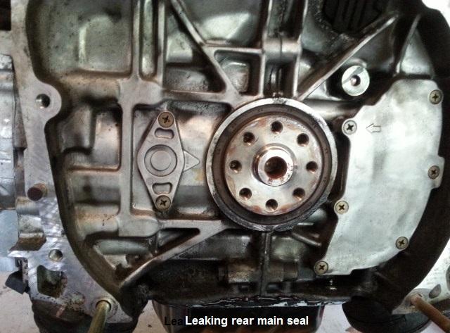

mkc1962 replied to mkc1962's topic in 1990 to Present Legacy, Impreza, Outback, Forester, Baja, WRX&WrxSTI, SVXIt was the rear main....I actually took this picture after i had already cleaned up all the oily residue that was all about the seal and its mating surface. But this was just a surprise find as I was pulling the flywheel to change out the pilot bearing. Nothing of any noticeable size was coming from this area.

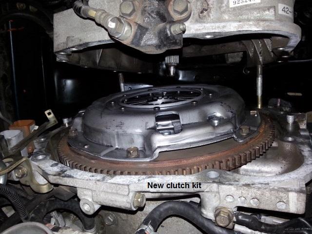

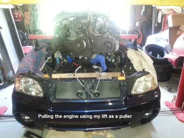

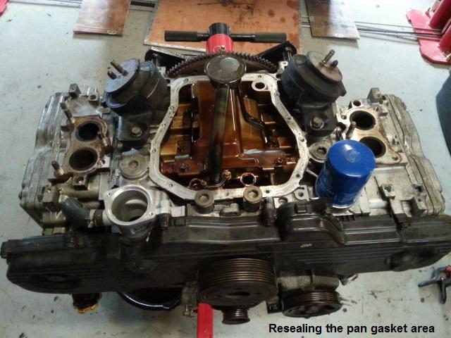

mkc1962 replied to mkc1962's topic in 1990 to Present Legacy, Impreza, Outback, Forester, Baja, WRX&WrxSTI, SVXThanks for the continued input and comments....yes I bought the 2005 I posted pics up two posts up. Spent this last weekend pulling the engine and doing a total reseal to deal with the head gaskets and other small fulid weepages. New Clutch kit, and all new rubber under the hood as well as full tuneup...she should be great to go for a very long time...so far really like it and not disappointed with my avg mpg which is sticking close to the 30 mark. The AC Compresor clutch went out yesterday, and it seems you cant find just clutches or clutch coils anymore, so a remanned compressor is now on its way. But at 11 years of age such is possible.

mkc1962 replied to mkc1962's topic in 1990 to Present Legacy, Impreza, Outback, Forester, Baja, WRX&WrxSTI, SVXWell its done and over and back to running like new....Pulled the engine and did a full reseal. Luckily so the decision to pull. Ends out the clutch disk was just about on the rivets, the pilot bearing was rusted and about to seize, so it got a full clutch kit. When pulling the flywheel came to find out that the rear main seal was also leaking. Both heads gaskets, with FelPro MLS kit. New head bolts. Rear n front main seals. Cam seals as well as cam towers resealed. Previous owner had only done the timing belt, so I went ahead and did all the rest of what should have been done when the belt was done, all pulleys and waterpump. One of the old pulleys has a near dry bearing and would have soon started to squeal or fail. All new rubber hoses entire engine bay, thermostat. Adjusted the valves while it was easy to do so ( all 16 were quite loose). New intake and exhaust gaskets, injector seals,throttle body seal. A few options added while going deep, a fumoto drain valve to make oil changes quicker and easier, a k&n air filter as it was in need of one anyway, both new drive belts, and a set of irridium plugs. Looking at the old ones which barely had any center electrodes left I feel they were factory originals. took about 3 days to accomplish but was doing other things at the same time, and there is no rushing perfection...yes I took a few pictures, and will post them. As for having a lift.....there is only one regret...I wish I had bought it long ago. An absolute recommended thing to anyone that does DIY. It will pay for itself in time and body saved in a very short time. Not to include makes working on things much more enjoyable. Other than I hooked the fuel supply and return up backwards at first, and it did not want to crank. Once corrected it cranked right up and purrs like a kitten. Now to enjoy for many years to come.

mkc1962 replied to mkc1962's topic in 1990 to Present Legacy, Impreza, Outback, Forester, Baja, WRX&WrxSTI, SVXAll parts finally in hand. Starting tomorrow it comes out for a total reseal.
