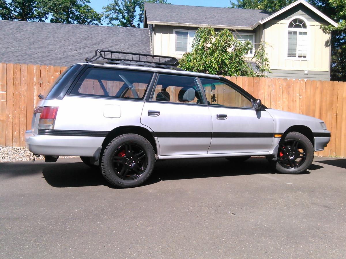

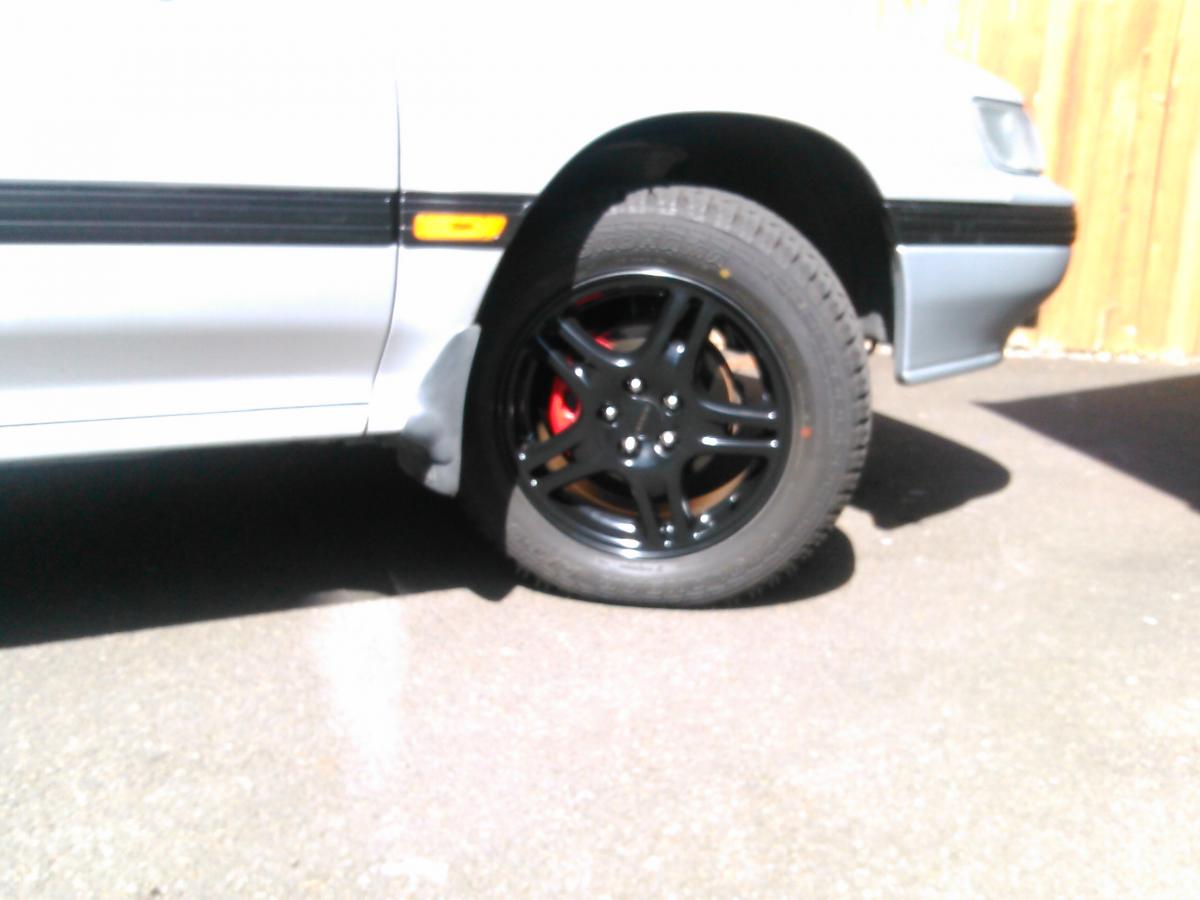

  4. New tires! I got some Yokohama Geolander A/T-S 215/60r16. Painted the wheels black and painted the caliper red for that Pop!

  6. The old struts make some noises every once in while when you hit a bump or pothole my guess is that they are original. So I decided to get new and give her a little lift with 1997 Outback struts. Struts and springs are assembled maybe next week I'll have time to install. Before I started my 1994 Legacy sat with the top of the wheel well at 26" Found time this week to install the struts that I had prepared earlier in the month. While installing I learned a few things on the way. 1997 Outback highhats are the same as 1994 legacy highhats but only in the front. The rear of the Outback is a one piece unit and the bolt pattern is larger where as the 94 Legacy is a two piece with a small bolt pattern. The shoulder for the Outback strut is much larger to accommodate the one piece highhat spring perch set up. I Found that a 5/8 Grade #8 split washer was about the perfect fit for a shim So my end results turn out with 28" so I gained 2" of lift and a new set of struts! And Clearance enough to drive over and empty bottle sitting upright.
