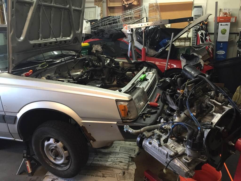

  4. So this last weekend i went & looked @ a 93 legacy turbo that i wanna use as my donor car! i'm picking it up saturday! i'm currently have a few conversations going with a few shops here in the Denver area. i have about 2 months for it. pretty much take everything from the legacy & put it into the loyale. i need to get a somewhat detailed list of what is required for this so that the shop can get a better idea too. do any of you guys have a link to good posts about what you or other guys modified . ANY help or push in the right direction is apprieciated. if you have friends or names of shops that arent too far away that is capable of tackling this project for me with be helpful too. thanks, chris

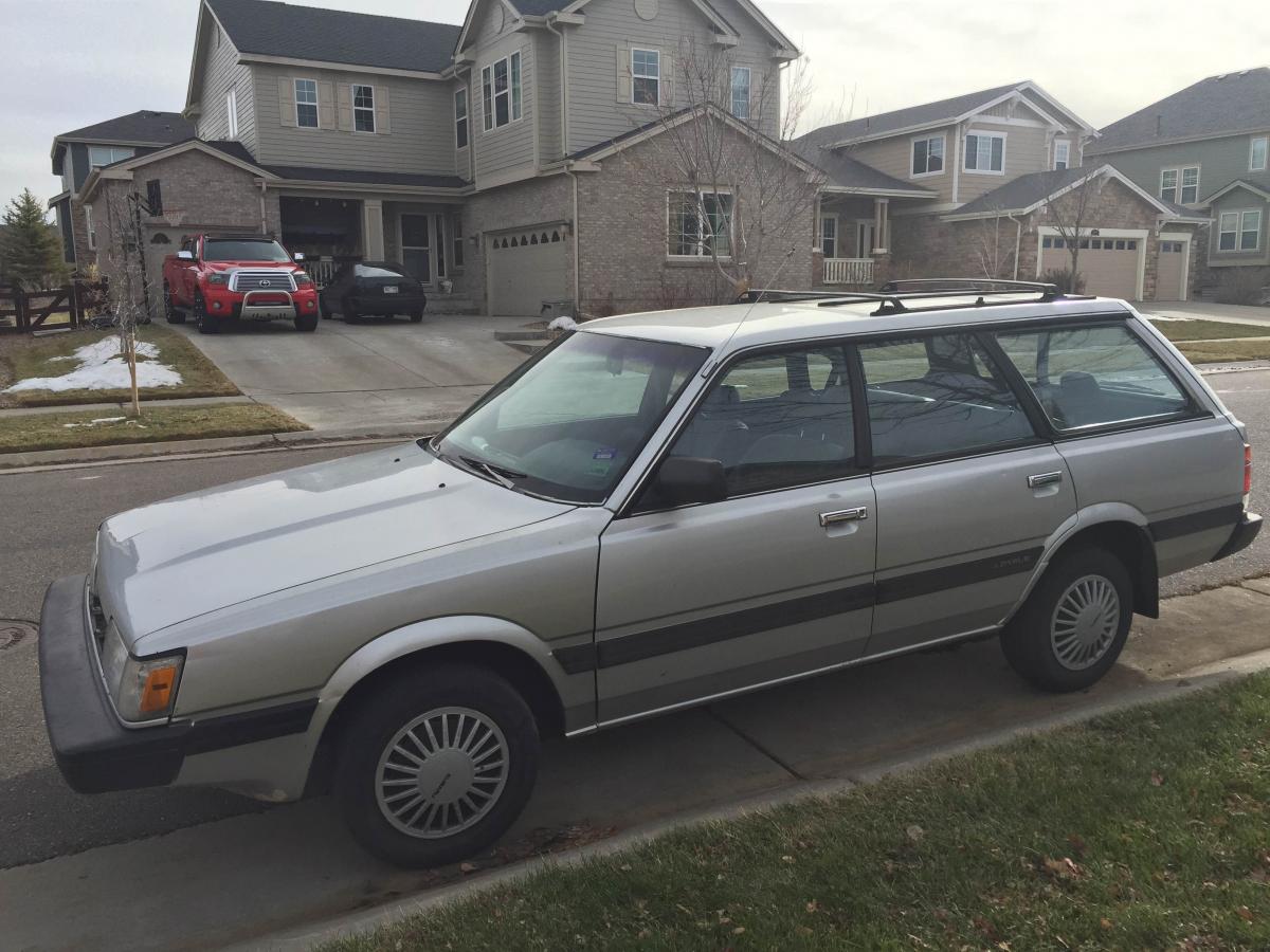

  13. A few months ago i purchased a 92 loyale from a kid who had gotten it from a family friend (88yr old Grandma) who babied it & was probly garage kept LIKE NEW,a fender had been replaced, im assuming Gma did quite make the garage...lol.. He had it for a lil over a yr when he tried to drive thru a high area of water & ever since it had been blowing white smoke. His mechanic said it was the transmission. It had 130k on it so we assumed it was the headgaskets or both, so I was able to get the car for $300. My buddy is a Subaru Tech but never worked on the older generation soob, so we replaced everything (Gaskets from the Heads up,cam seals, oil pump, fuel filter,timing kit, ect.) no valve job or valve seals replaced). We did all this & checked everything & it ran & then smoked. shortly after i drove it the smoking stopped for a few days,it smoked when i turned left or right. thats when i looked it up & found this site & found that i was burning AT fluid & tracked it to the Vacuum Diaphram on the side of three 3 speed trans. it had no fluid when i bought it we had only added a lil & forgot to put more in it somehow with all the other work we were doing. it was about $600 in parts & $600 to my buddy for the work, i helped with most all of it. As soon as we replaced that valve the smoking stopped after 2 min. we checked all the fluids & its been running really well ever since. so i might have dropped $1200 for something that could have only spent $50 on. I have tho noticed i have a lifter tick & it accelerates well isnt shifty but when i get up to 55 it wants to huver there for too long i feel . atleast a mile or so down a straight highway. The gas peddle wont do anything when i feather it or press way down. when i do manage to get it to do something it revs to almost 5k for maybe 1-3 seconds & wont hold rpm? It seems like once it gets about 60mph i sorta feel like something kicks in & the peddle responds. i feel like it could be a vacuum thing. We've checked & replace like every hose or vacuum lines. when im in traffic & everyone is getting on & off exists going 55 & not having to get up to speed fairly fast everything responds well. i just know something is a lil off & trying track it down. i know its a slow car & i'm not trying to get anywhere that quick but . other than all that its doing great & looking forward to lifting it & turning it into my adventure vehicle. thx, chris
