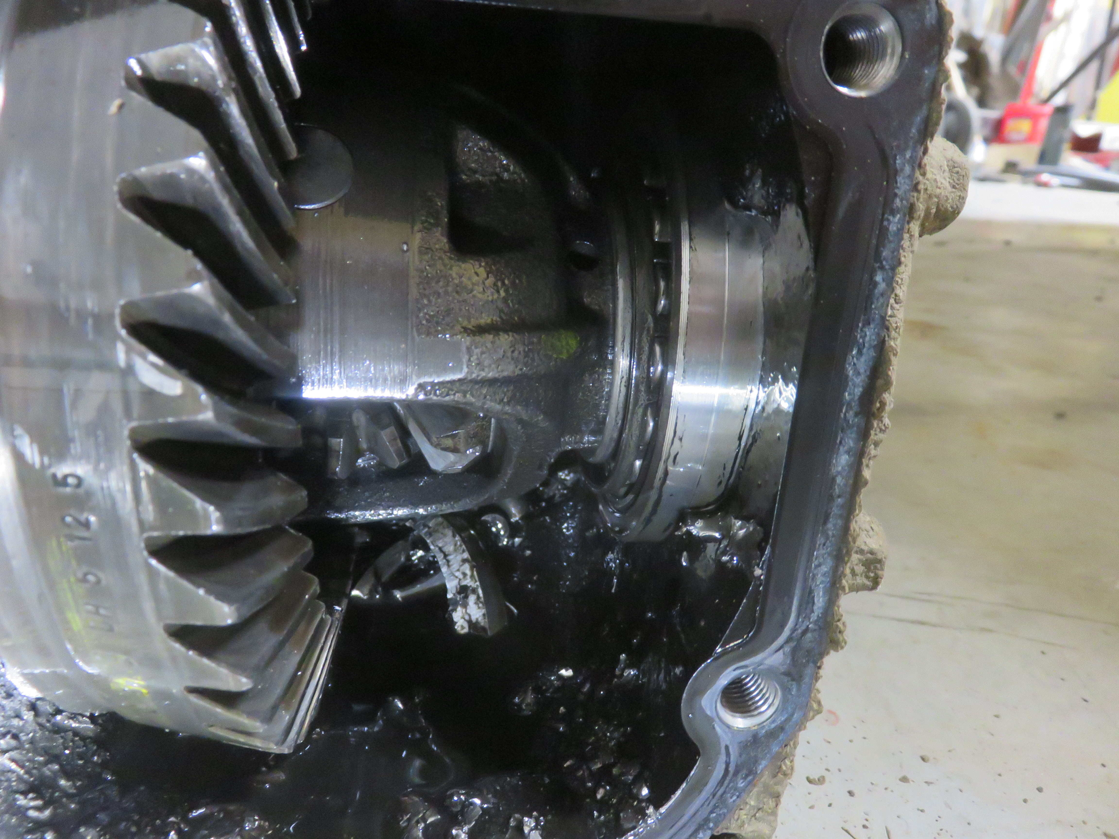

The pinion bearing looks OK. Looks as if the driver side bearing went out, wiped out its seal, let the oil out, got totally chewed up, and broke its outer race and the cap that holds the race. Unless those caps are replaceable, I think that differential is done. On the other hand, the ring and pinion gears look undamaged. That's a surprise. Anyway, I'm going to replace the diff housing minus the ring, carrier, etc. and try to have this ready to drive out of the shop tomorrow as an FWD.

It turns out that the differential is structural! I'm going to have to put it back in there in order to be able to drive. I figure I can take the outer ends of the axles off to be able to hold the wheel bearings together. The outside boots are cracking, so they were going to have to be replaced anyway. I'll take the diff further apart, see if I can figure out what else went wrong, and what, if anything, is salvageable. Then it goes back in until after Breakup, when I can get at that parts car.

I got the differential out. The passenger side bearing looks OK. The driver side bearing is a pile of shavings in the bottom of the differential case. By the way, is there a way to remove a picture once it's been uploaded? Somehow I uploaded a 1meg pic that turned into almost 4megs, and it's taking up a 1/3 of my quota.
