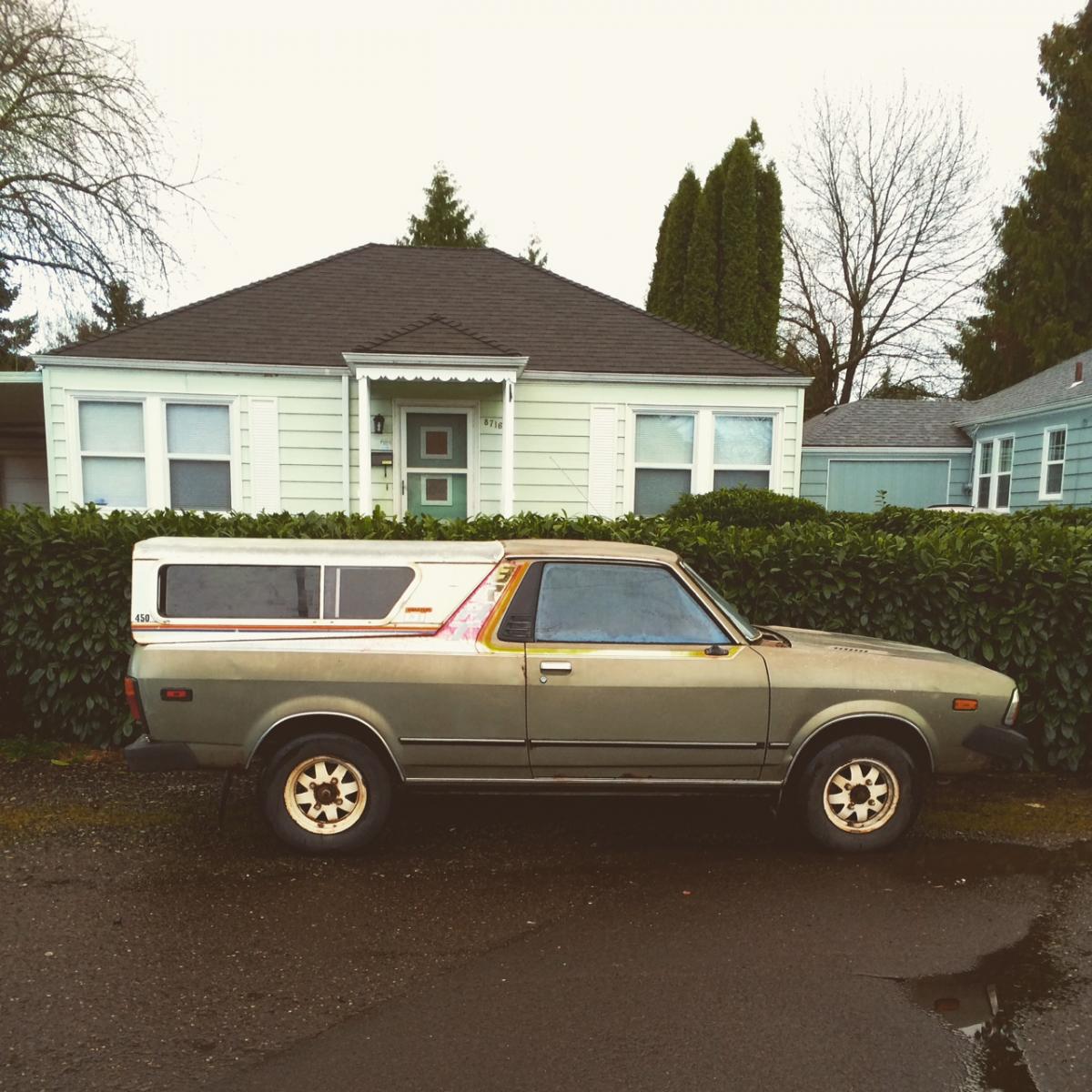

can an ea81 and drivetrain swap into generation one brat?
Are those 14" wheels? If so, did you have to lift it? I really like that stance. Most posts I see about 14" look more like monster trucks ha.
New guy, in Portland Oregon, with a first gen brat
I figured I would probably put a weber on it eventually, so the single carb intake made more sense. Also this one was a little cleaner, less rust, less missing parts, etc. I already have a list going of things I need ha
Hey everyone! I just picked up a 1980 Brat GL. I've wanted a first gen brat for years, and the right one finally came up for a price I could afford. It needs a pretty thorough going through, but will be my daily soon. When I'm not riding my 74' BMW R75 that is. I look forward to becoming part of the classic subaru community out here in the PNW. I'll buy the beers if you wanna come over and help turn some wrenches! -Hunter
