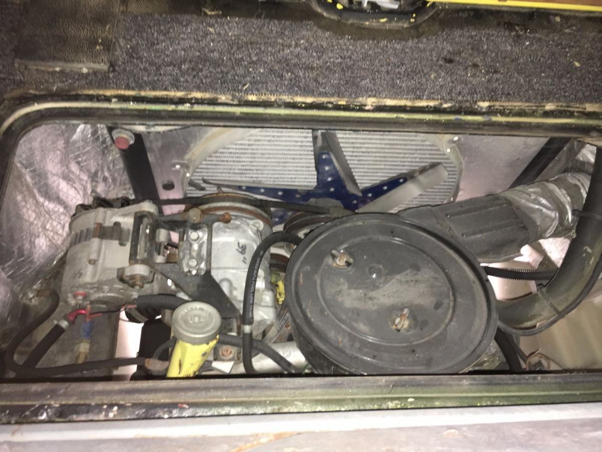

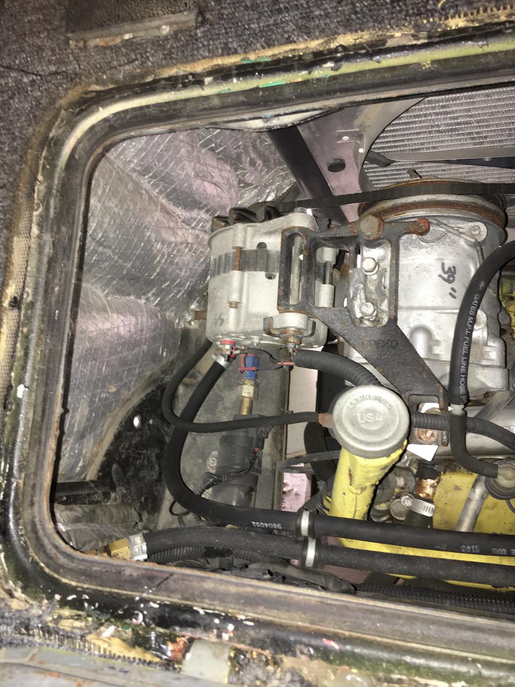

  19. Ok, can you point me to a picture of the series ID casting code so that I know where to find it? Or can you definitively tell that this is an EA81 - if so what are the cues?
  20. thanks - is there a way to tell if its 1600 or 1800?
  21. I bought a vw bus with a subaru conversion. Its in storage out of state and I can't get to the engine to read the codes. Can someone help me identify what this is? I need to buy a water pump for it. Thanks
