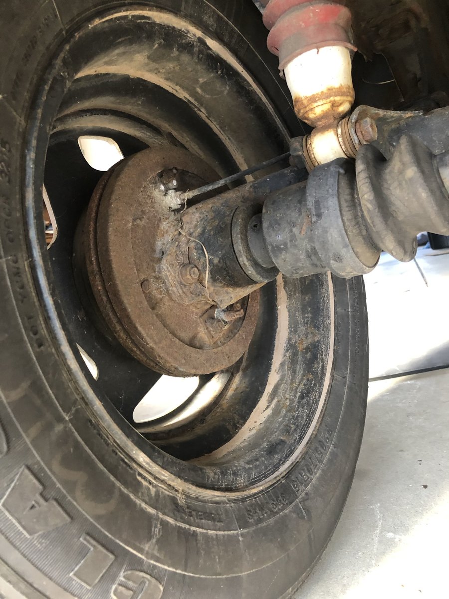

  4. I have looked through a few forums on adjusting drum brakes, but am a little confused. Can someone help me understand how to adjust these things? I have attached a photo to be able to see what I am dealing with. 1982 Brat.

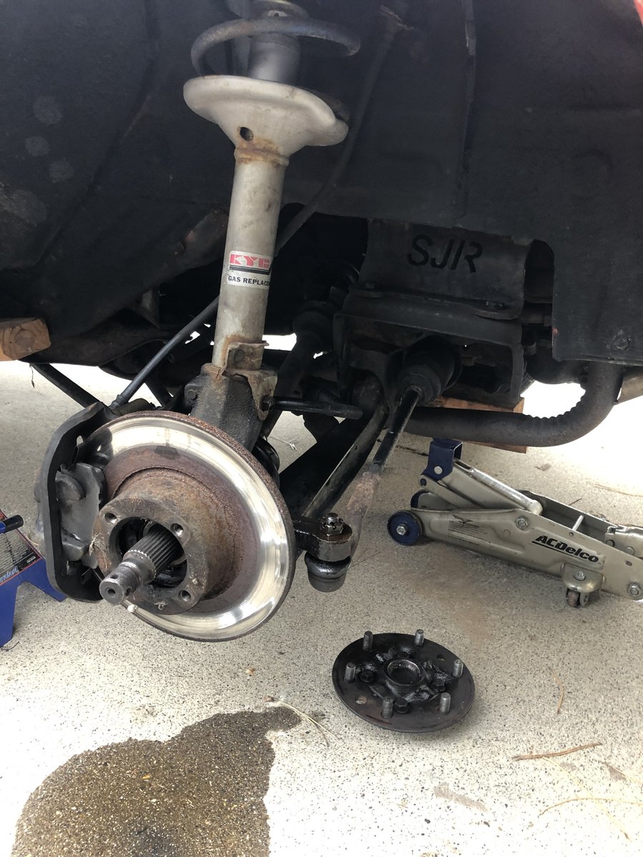

  7. Second gen brat. The other day I was driving and heard some crunching from the passenger wheel well and figured my CV axle had finally gone. The boot was torn and I was waiting for it to happen. I put it in 4wd to get it home, which luckily was around the block. Just took off the hub and noticed the splines are very stripped. This is the same problem I had to fix on the drivers side to get the thing running again. This brat came with 4" (ish) SJR lift blocks that seem to make the wheels tilt in excessively. The question here: are the SJR blocks throwing the geometry off so much that this problem will just keep happening (stripped hubs)? Is there a solution besides just taking them off? Thanks!

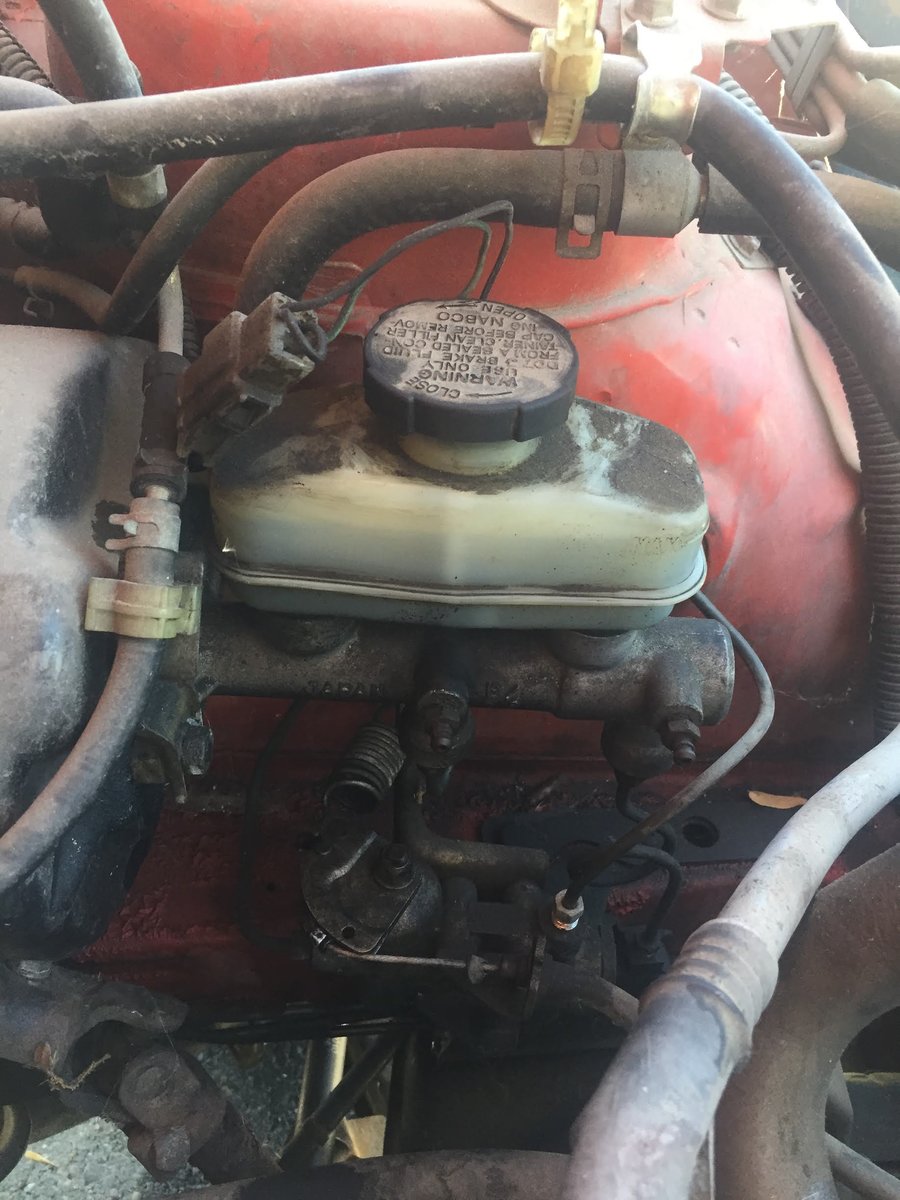

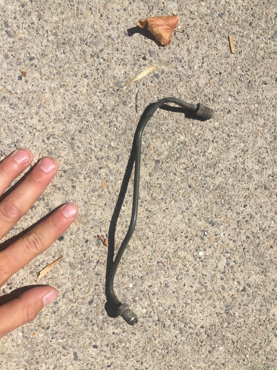

  11. The only place that looks relatively damp is where the master cylinder and the brake booster connect? I have attached pictures, but can't really see much in this photo. Another thing I keep wondering about is what appears to be a part a piece of steel brake line that I have found in the engine bay. After following the brake lines I cannot see where it would connect, but maybe I am missing something. Photo also attached.
