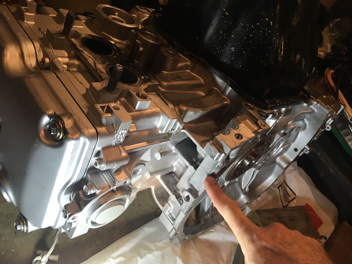

Thanks Numbchux, The engine is clean and sitting in my garage, so a number should be easy to find. I checked around and found no number. But I found this vertical space under a tranny bolt hole on the pass side that would be perfect for stamping a VIN # on. Am I missing it or is the engine missing a VIN? Thanks for your help. i'm a newb to the Subaru. The only thing I know about this engine is that it "will work with a harness from a 2002."

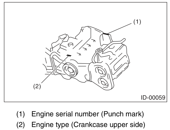

Is there a way to better identify what kind of ej25 I have? No VIN number that I can find. How do I tell is this is a 2.5D or 2.5L? I have been doing a boatload of work on the VW Westfalia that this engine will go in (even rebuilt the top half of the 1.9L waterboxer currently in there, along with a ton of other work), but am VERY new to the Subaru world. Green as can be. Trying to do as much intel gathering as possible before I get to turning wrenches.
