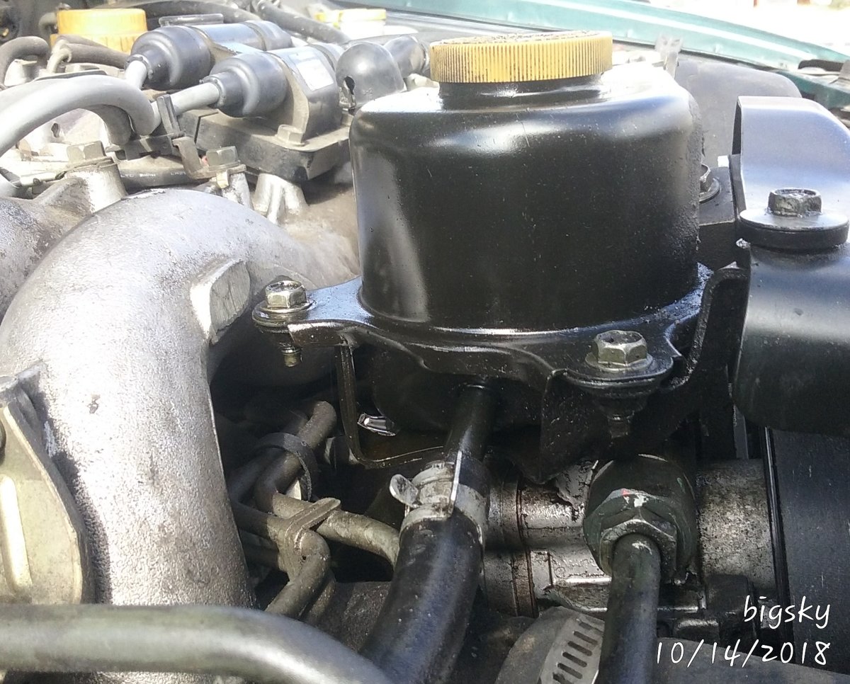

Bigsky replied to Bigsky's topic in 1990 to Present Legacy, Impreza, Outback, Forester, Baja, WRX&WrxSTI, SVXThe leak is on the back side between the hose and the bolt you can see a bit that pools on the bracket then drips on the manifold. Probably the o ring i hope. Im searching how to remove the reservoir so i can change it. Ive done lucas stop leak but its not workin. But to be fair ive only been able to put a minimal amount in there. I have a big syringe that ill suck some of the old fluid out with, and ill check the link for the o ring i may need. Unless it seems like there is another direction i need to start at

Bigsky replied to Bigsky's topic in 1990 to Present Legacy, Impreza, Outback, Forester, Baja, WRX&WrxSTI, SVXMy power steering res. Is leaking on the bottom so it drips on my manifold and smokes when the engine heats up. I thought of running a toggle switch to my wiper motor but the part is only like 80 bucks. And i found shocks and springs for like 200

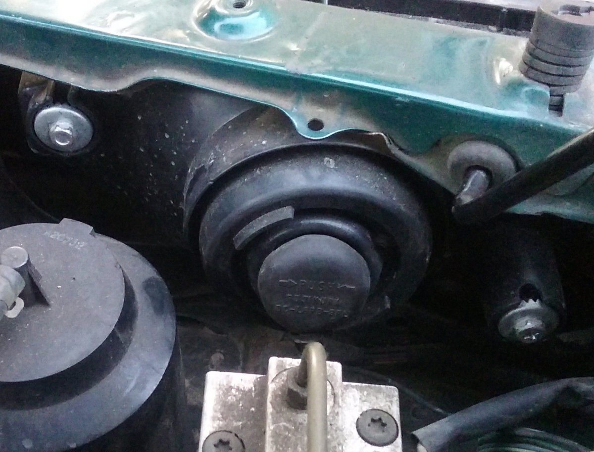

(The dude before me installed new headlight assemblies on my 96 subaru impreza lx. I have searched all over but cant find anything about them . On the lenses they say sae hr06 dot 13v h4 vor FeBerg srip95.0 on the cover. I am trying to adjust the passenger side headlight as its too high up. But i cant find info so im not sure excatly what to do. There is a bolt on the back (upper inside) and one on the lower back (towards outside) i have turned both but neither seem to move my beam. Ill go take a picture of the front and inside in hopes someone can tell me what im doing wrong. I feel stupid asking but am at my wits end. Maybe its broke? Pictures to come - Why cant i find the maker of my headlights?
