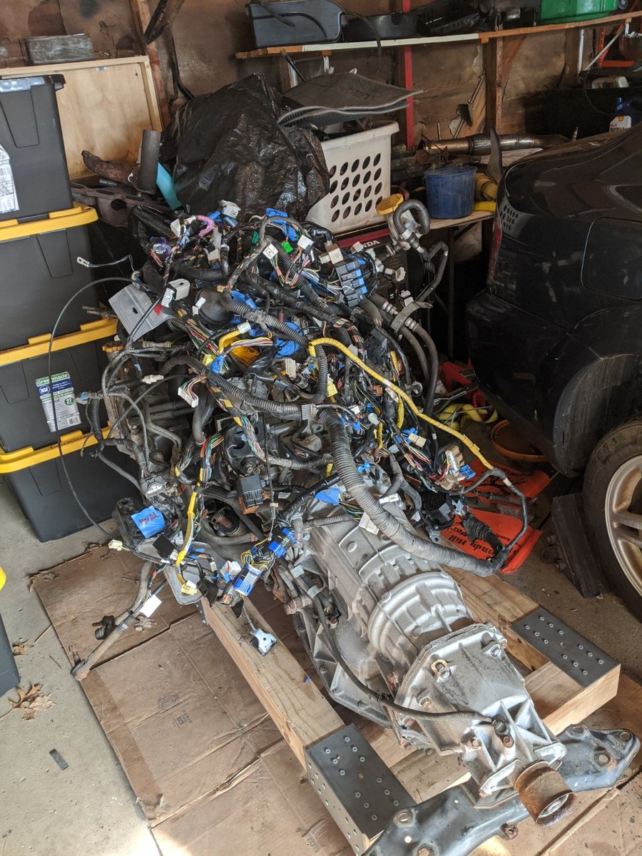

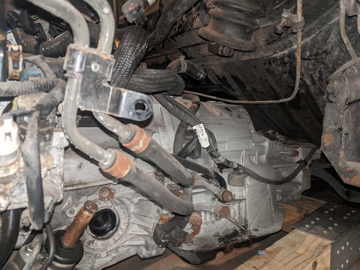

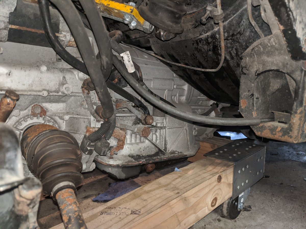

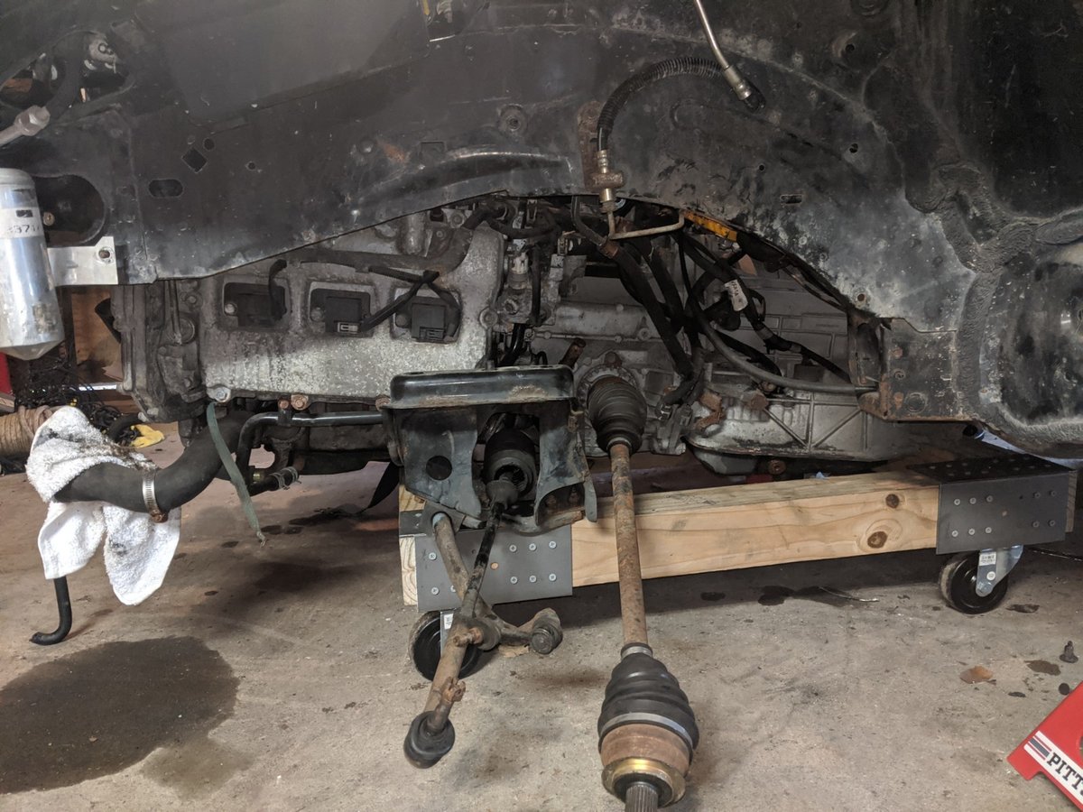

I got happy with the angle grinder and cut out the top section of the tunnel to tuck the transmission up. The Engine/Trans oil pans will stick down, but I'll just cover them with a skid plate. Otherwise, it was pretty easy to get it up to the position I wanted.

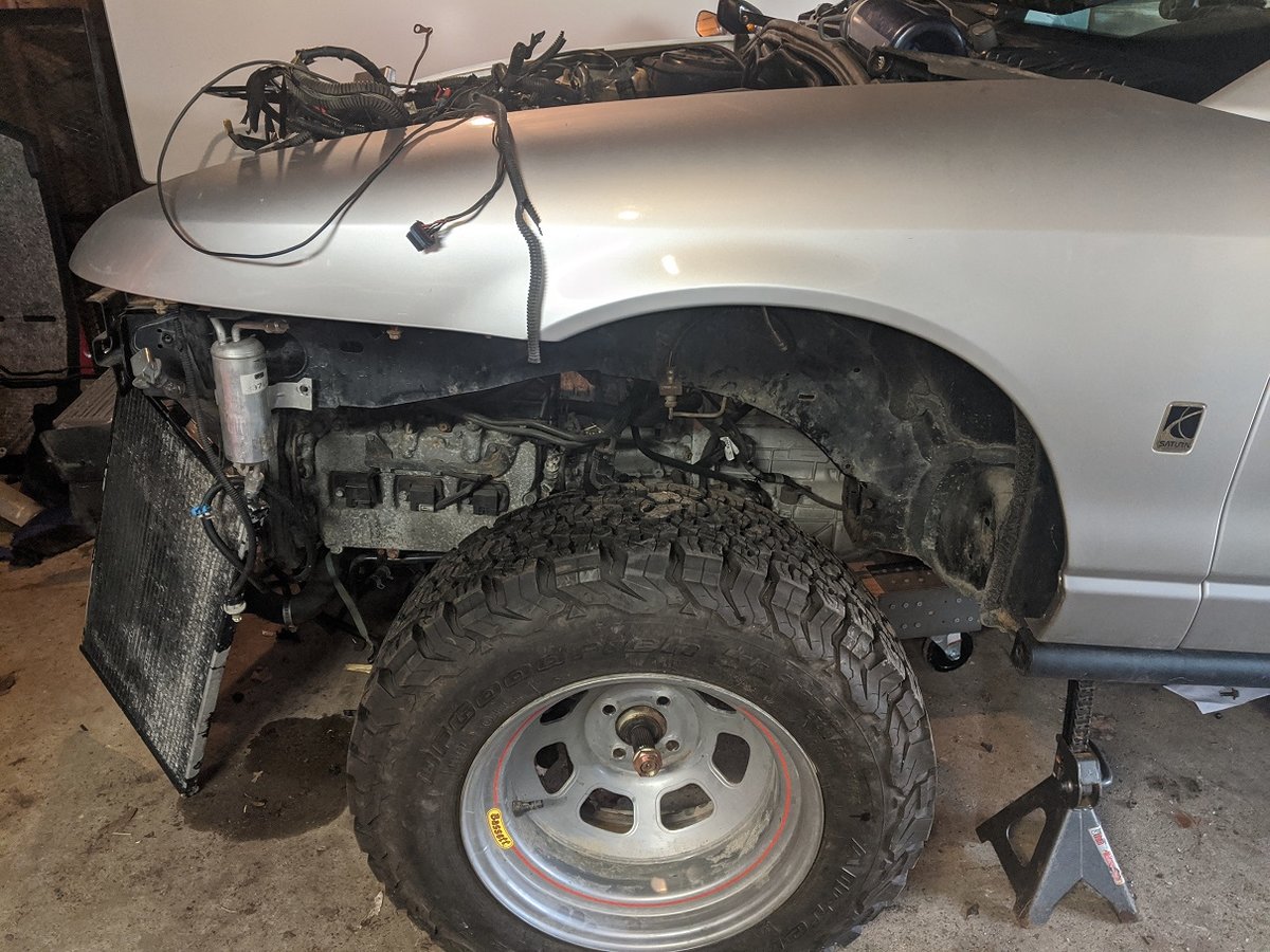

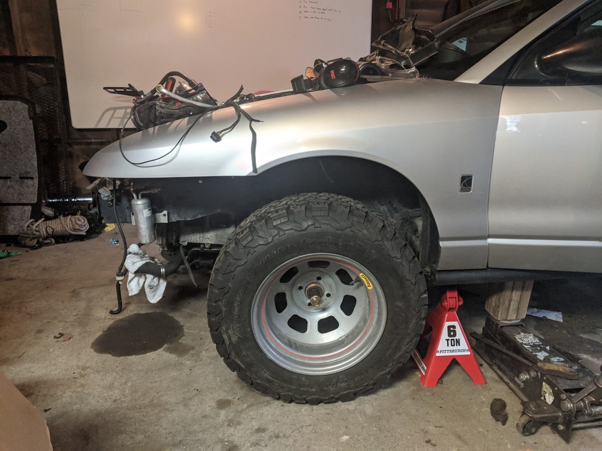

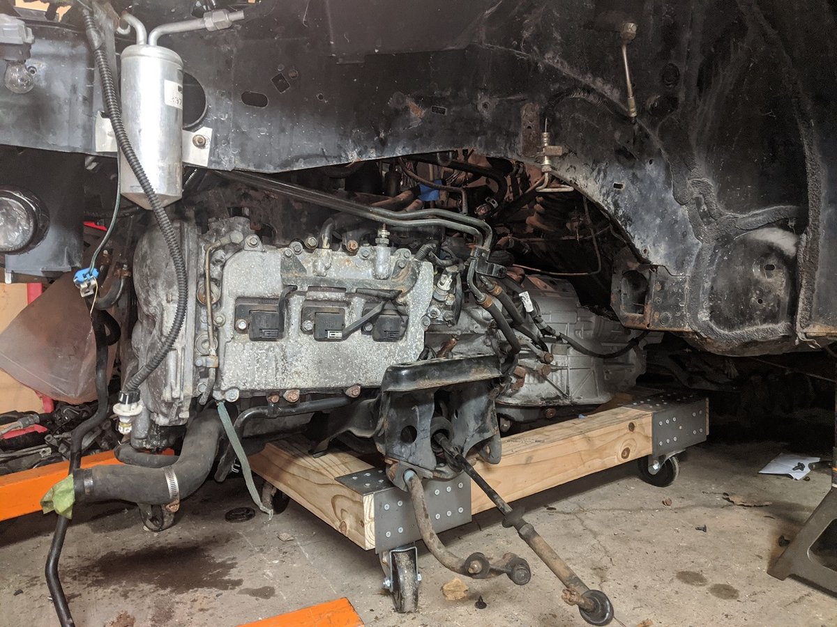

Time to cut some sheet metal to tuck the trans up a bit more. I'm torn on how far forward I want to end up mounting this thing. The 3rd pic has things positioned roughly where Id need them to be able to run 32" tires. IMO, thats much too far forward and would probably make this much too nose heavy. The previous car I messed with could only manage 28" tires due to how close they were to the wheel wells. I'll keep playing with the position of the Engine/Drivetrain after I cut a hole for things to go up higher. -Alex
Offroad Tupperware [EZ30"R"/5EAT]
You might want to specify the types of pictures you want. *Giggity* I'll be cutting out the radiator support and rolling the Engine and trans under the car tonight to see how much lower they need to be mounted in order to clear the lack of trans tunnel in that car. Also mental note: Drag both the Legacy and Saturn gas tanks outside before the sparks start to fly.

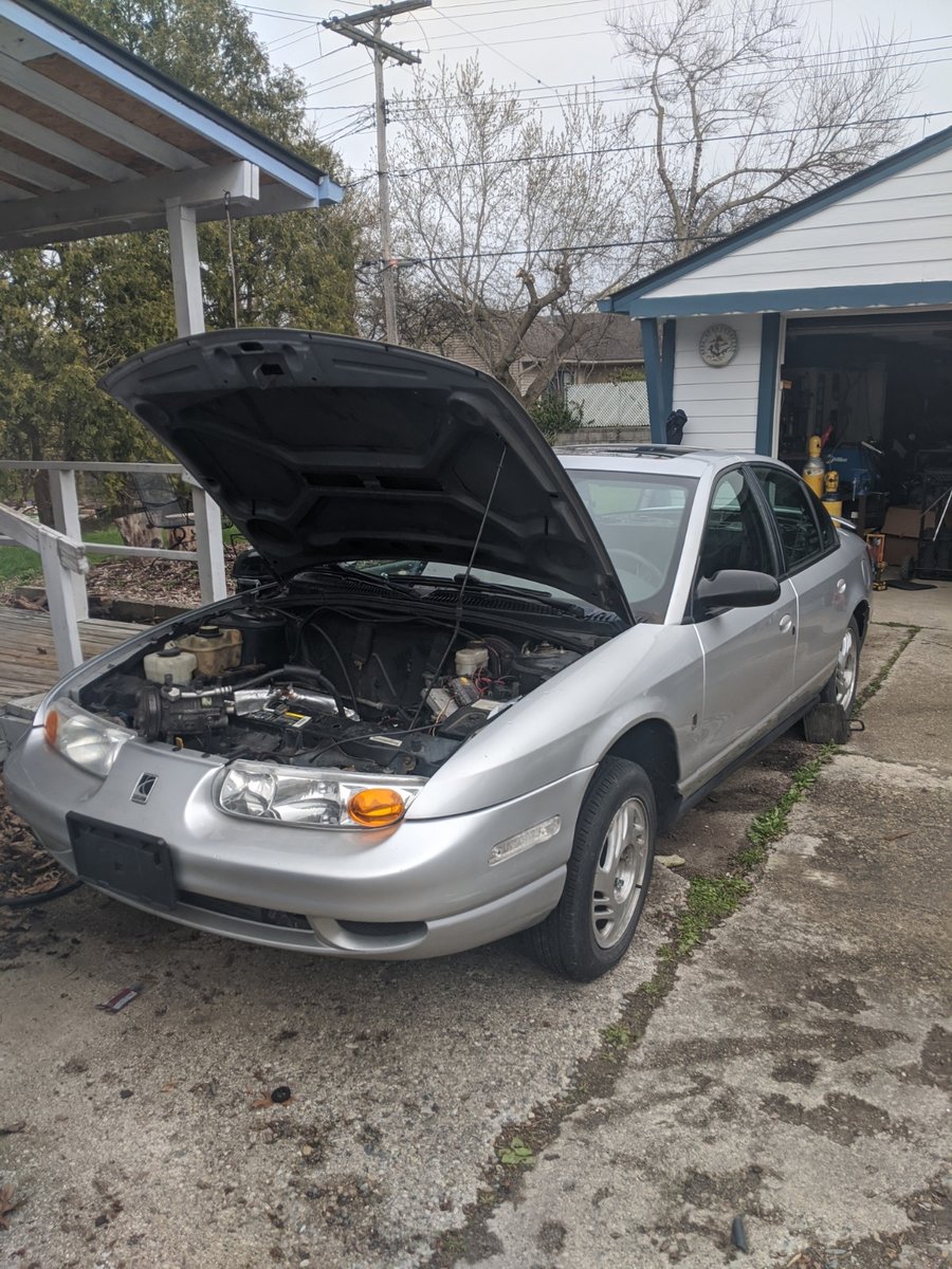

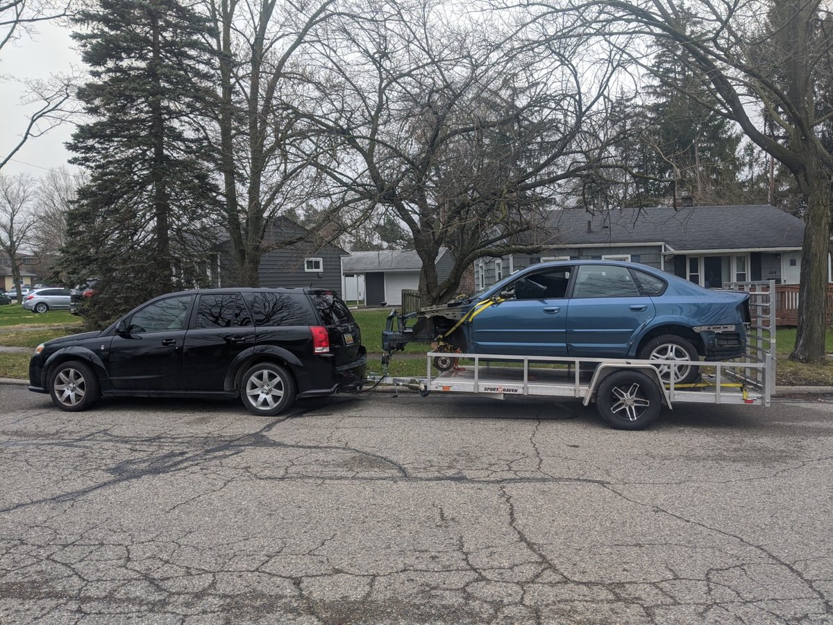

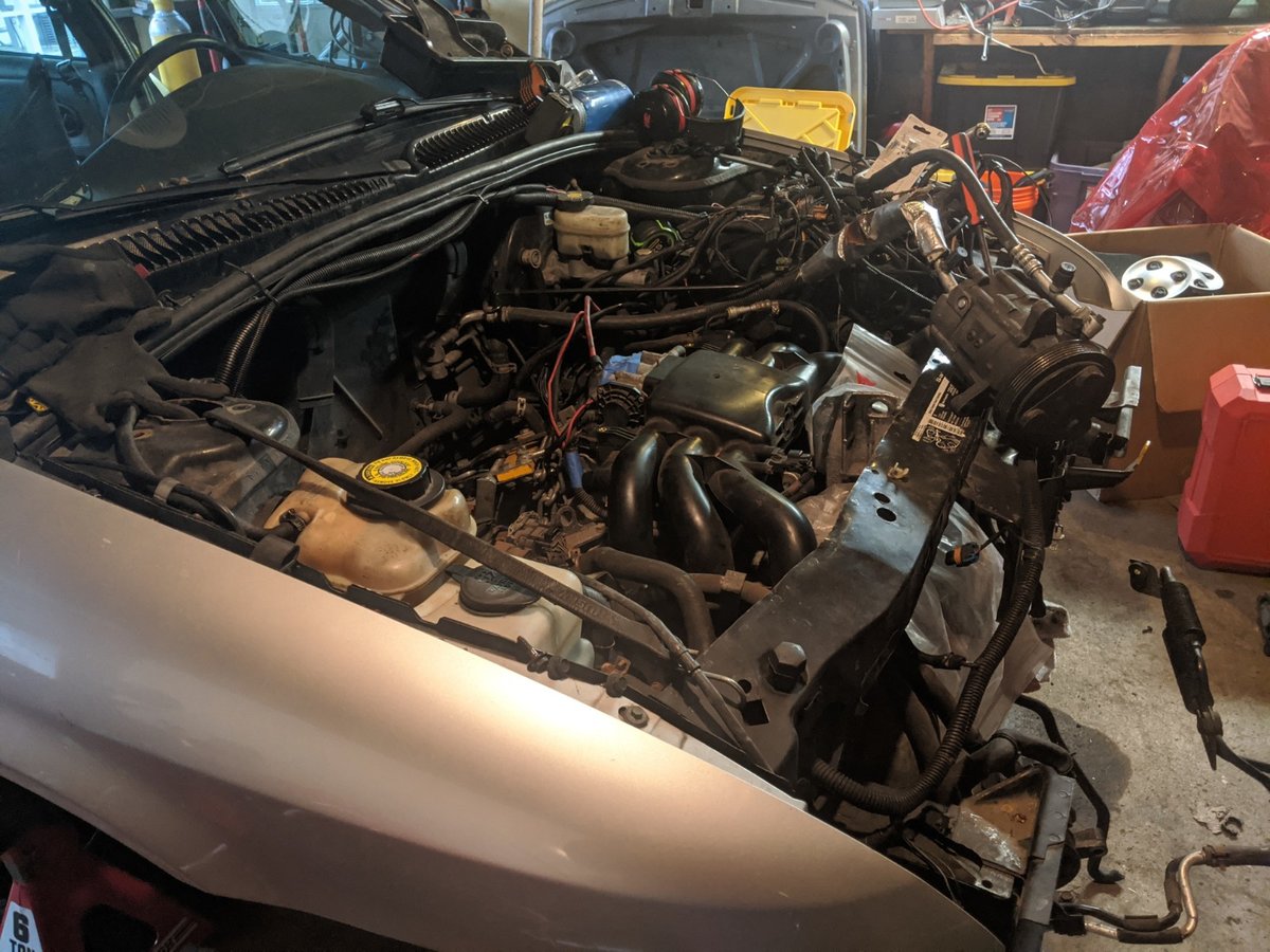

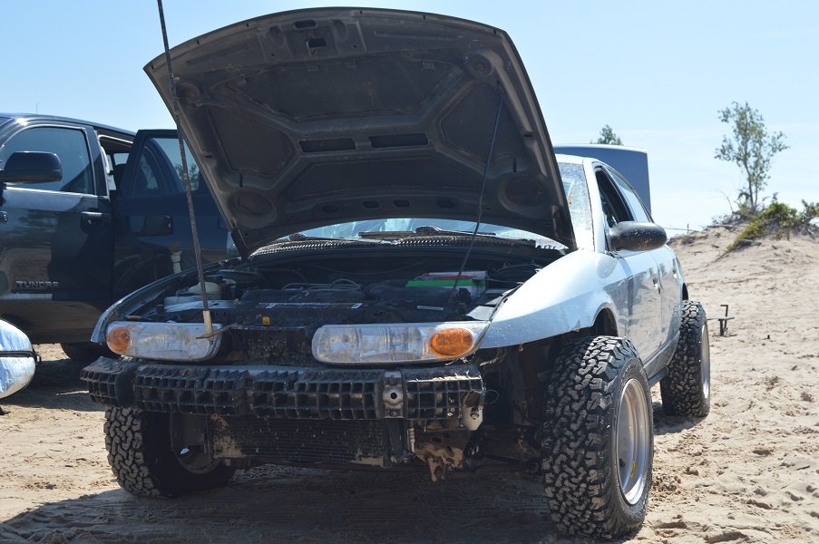

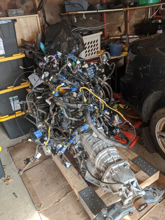

I figured I'd throw up shots of my derelict project I've decided to embark on while we're quarantined. The goal is to shove the Engine/Drivetrain from the '06 Legacy LL Bean [120k] into the silver car for some offroad shenanigans. As to the question of why, plastic doesn't dent or rust. Plus the Legacy was an auction car that glanced off a tree
