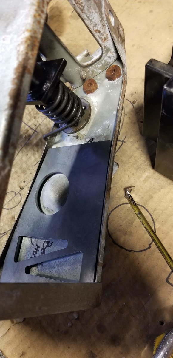

  8. When pushing in clutch the left wall of the box would bend here under the pressure
  9. I was saying PB, short for pedal box. So I apologise for confusing anyone. But yes if you push in your clutch pedal with your hand and you see it flexing or cracking the pedal box at all. That is your problem. I've found out that any play what so ever makes it nearly impossible to actuate the clutch. And as for getting down there yeah it's super tight and you have to take that "kick panel" (I just call it the under dash) and then if you end up taking the pedal box out I had to remove my gas pedal bc it wouldn't come over the steering with it on.

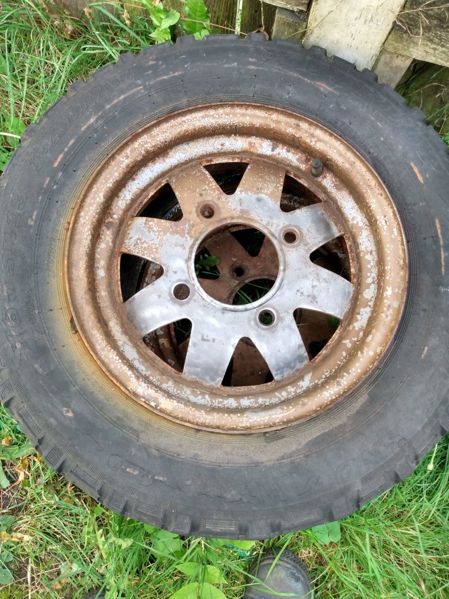

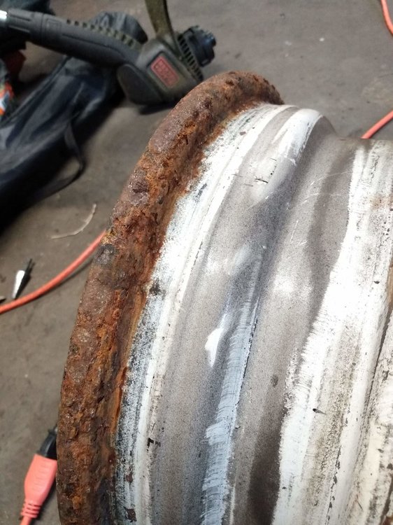

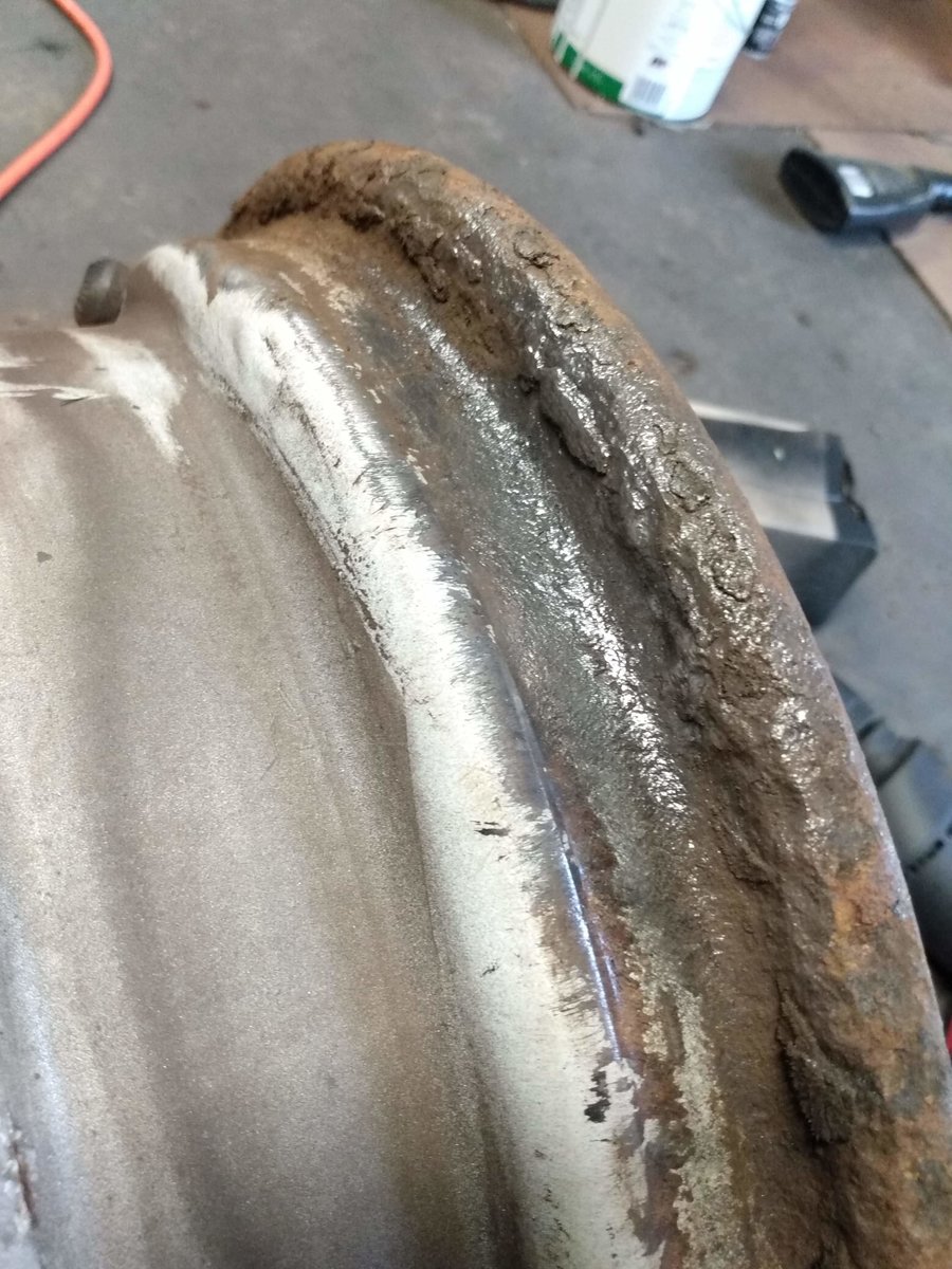

  10. Started grinding at the worst part and although it did smooth it out idk if it's going to take those chunks off. What do you think? Are they too far gone? And how smooth does this area need to be?
  11. I've an extra set of spoked GL wheels that I've been wanting to restore. Started grinding rust off but once I had tires removed the bead seat area seems to be far too gone.
  12. It was infact the pedal box that was the CAUSE. A sidenote was the cables terrible quality. Basically just welded this plate on the wall that was cracked and bending. Strong as hell now.

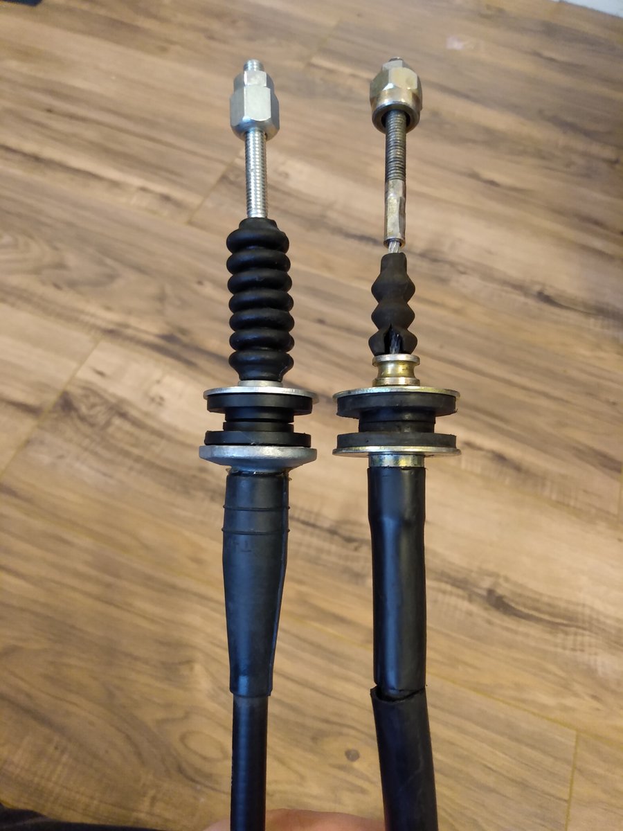

  13. Alright guys thank you, I have solved the issue. It was both the PB and the cable. The one thing I learned from this is BUY QUALITY PARTS. Man the difference between the oriellys cable and the genuine Subaru cable is insane. Can you guess who is who?
  14. Cable works great. Very smooth. The pedal box is very bendy so I wonder if that's it. EDIT: Got new cable from dealership. The "new" one that I put on already has bent washers.. it was from oreillys. And taking the PB to my buddy's shop to have reinforced. We shall see if this fixes the issue.
