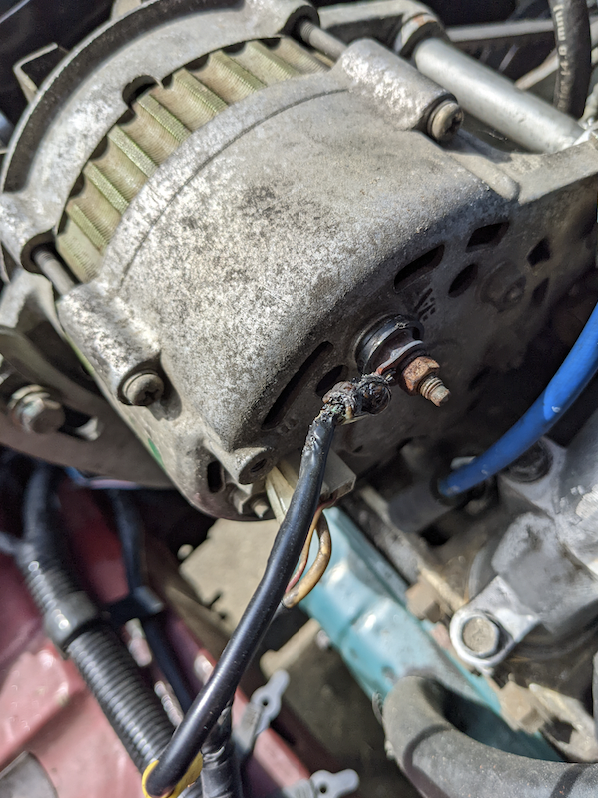

  4. I replaced the washers and nuts on the alternator and literally everything reads properly now. What an easy fix. Scrub scrub scrub those connections.

  6. Maybe my eye terminal just isn't actually contacting the positive output post? I really don't understand how I get two different readings from touching the post or the eye terminal. Here's a photo of the not-burnt connection.
  7. I'm confused by my interior volt meter reading. It shows 10V. Where is the interior volt meter measuring that voltage? When I use my own volt meter I don't get any reading near 10V, but I don't see any reading around 14V like I expect to see. * I read 12.6V across the battery terminals. * I read ~12.6V from the eye terminal to ground on the engine case * I read 18V (a lot!!) from the alternator positive output post to ground on the engine case * And, hey, why do I get a different reading between literally the post or the eye terminal? They're touching the same thing!! I thought I was dealing with a bad wire somewhere but I've replaced a noticeably bad wire and I can't find what looks like any voltage drops between the alternator and the battery. The eye terminal and the wire on the positive alternator post have gotten physically hot to the point where they melt plastic on the wire. Check out pictures to see the melted wire. My best guess is there's still a bad wire somewhere. Or maybe the alternator is bad? Shouldn't it read 14 or 16 volts and not 18 volts? Any insight is appreciated! And again, my original question is where exactly is that interior volt meter measuring that voltage? I really don't understand why it alone shows 10V.

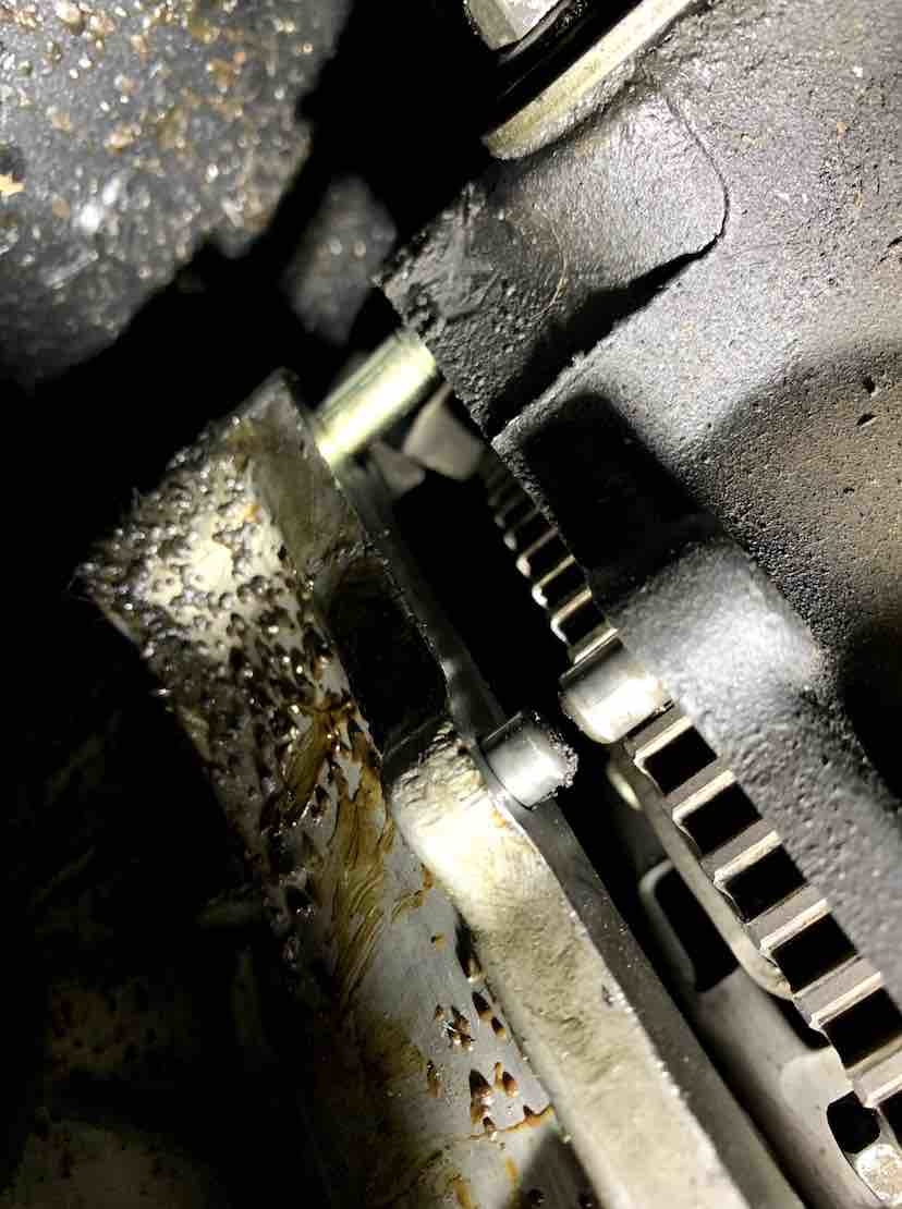

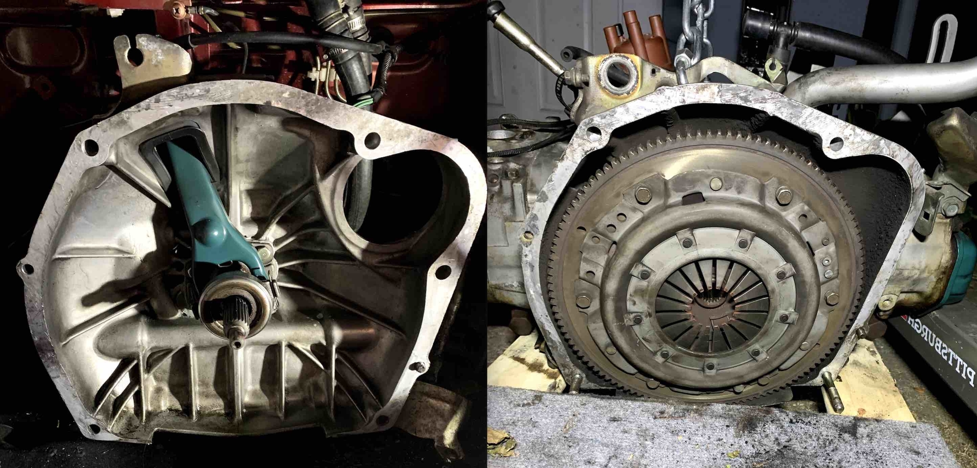

  11. Unfortunately I'm an idiot and wasn't watching oil and seized the engine on my '83 BRAT. Good thing I picked up this well-running '84 wagon real cheap ($700!!, 130k miles, can you believe it?) as a donor car. I'm taking the engine out of the Wagon and putting it into the BRAT, albeit way sooner than I expected. I went to drop the 84 Wagon engine into the 83 BRAT today and was surprised to find a fitting pin on the lower right facing the transmission smashes straight into a fitting pin on the engine. What's up with these fitting pins? Can I hammer them out and put them in another position? Or, is the pin position clueing me in that this engine and this transmission is not in fact compatible? Pictures attached. 1. I horizontally flipped the image facing the engine to make it easier to reason about this pin mismatch. 2. a super zoomed in image of the pins clashing. 3. the overall setup just to show off my annoying slightly inclined driveway. Anyone have a clue what's up with this pin? cheers!

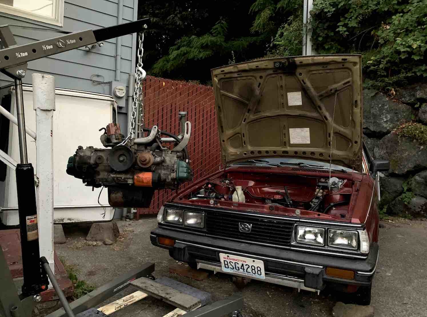

  16. Well. God damn. I messed up. After putting a ton of work in I thought I was done and back to enjoying my car. Nope! I messed up and drove it on a 1 hour test drive around the city only to find out later it didn't have oil. I think something was wrong with my oil indicator. I was doing the test drive because it died on me twice before earlier in the day, but I thought I just hadn't let the engine warm up at first. It drove well for my test drive after I let it warm up but now the next day the engine wouldn't start and there was zero oil when I got around to checking the engine. I fear I made a very dumb mistake and seized my engine! So. Anyone have an engine laying around? I would love to replace mine. Here's a picture of my beautiful 1983 BRAT hanging out down by the old Weyerhauser headquarters by Auburn. If someone around here doesn't have one I've already talked to a guy in Philadelphia who's willing to ship one over. Someone on reddit clued me in to ask here to find someone more local.
