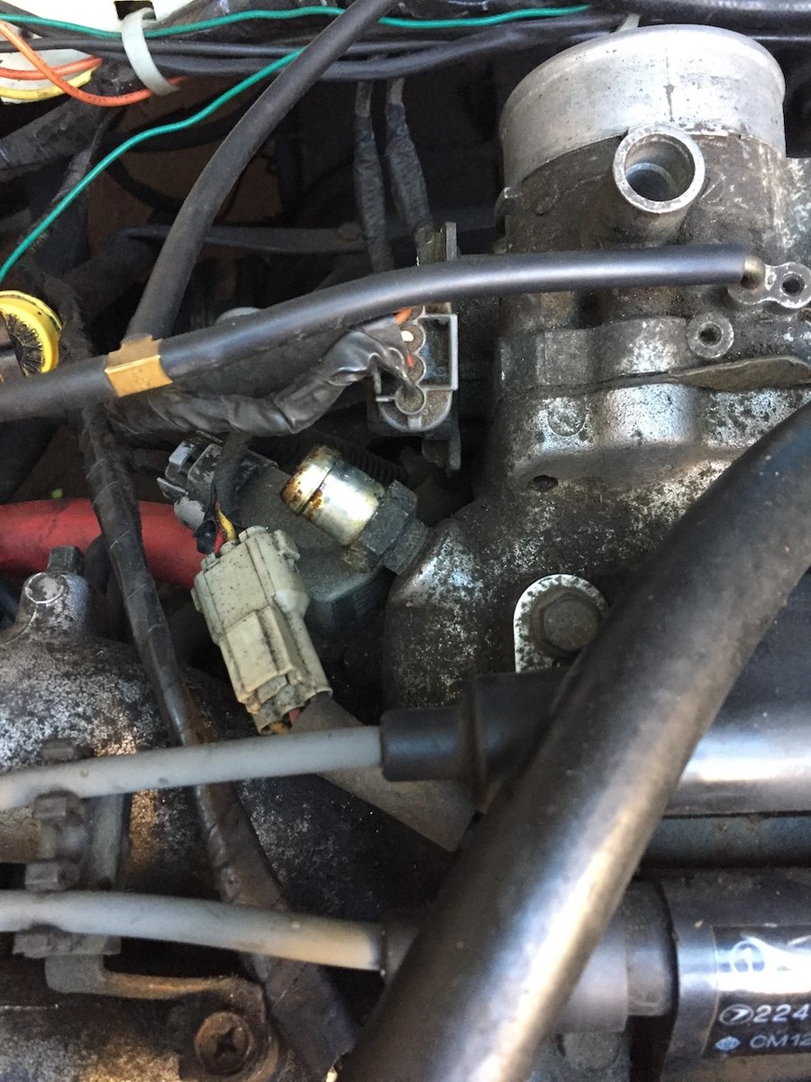

pvfahrer replied to pvfahrer's topic in 1990 to Present Legacy, Impreza, Outback, Forester, Baja, WRX&WrxSTI, SVXso i replaced the PCV valve today, instead of finding it at the rear passenger side of the engine, i located it at the intake manifold... is this really where this is supposed to be? the valve appeared to be okay but i replaced it anyways. But is that really the place where is is supposed to be? i thought it was checking the crankcase pressure?! edit: i am a fool, turns out i have been watching an instruction for wrx engine were the valve is in the back... so everything is good, only i need to replace the hoses as well now..

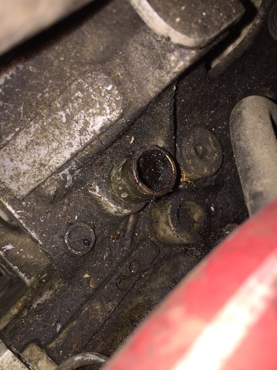

pvfahrer replied to pvfahrer's topic in 1990 to Present Legacy, Impreza, Outback, Forester, Baja, WRX&WrxSTI, SVXi cleaned the engine a couple times now to hunt down leaks, the crank seals, o-rings and plug were the worst so far. The valve cover gasket seem to leek from one of the screws so i ordered them new... will check on these and the pcv, hopefully this is addressing the leakage.

pvfahrer replied to pvfahrer's topic in 1990 to Present Legacy, Impreza, Outback, Forester, Baja, WRX&WrxSTI, SVXyeah.. i hope its not that. the engine is build somewhere 90-93 and has the metal thermostat housing connector in case this is an indicator for what might be used for the oil/air separator.
