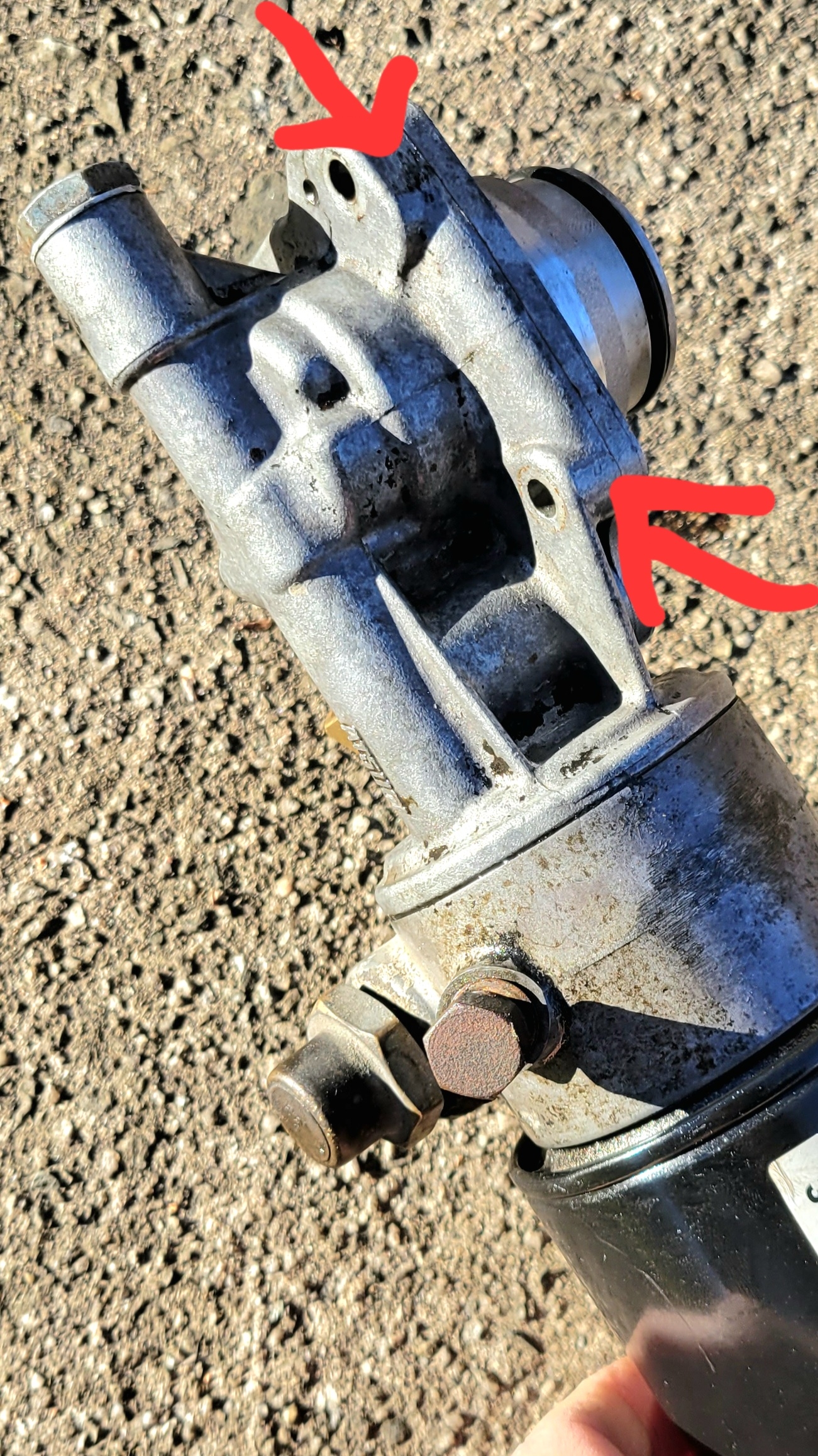

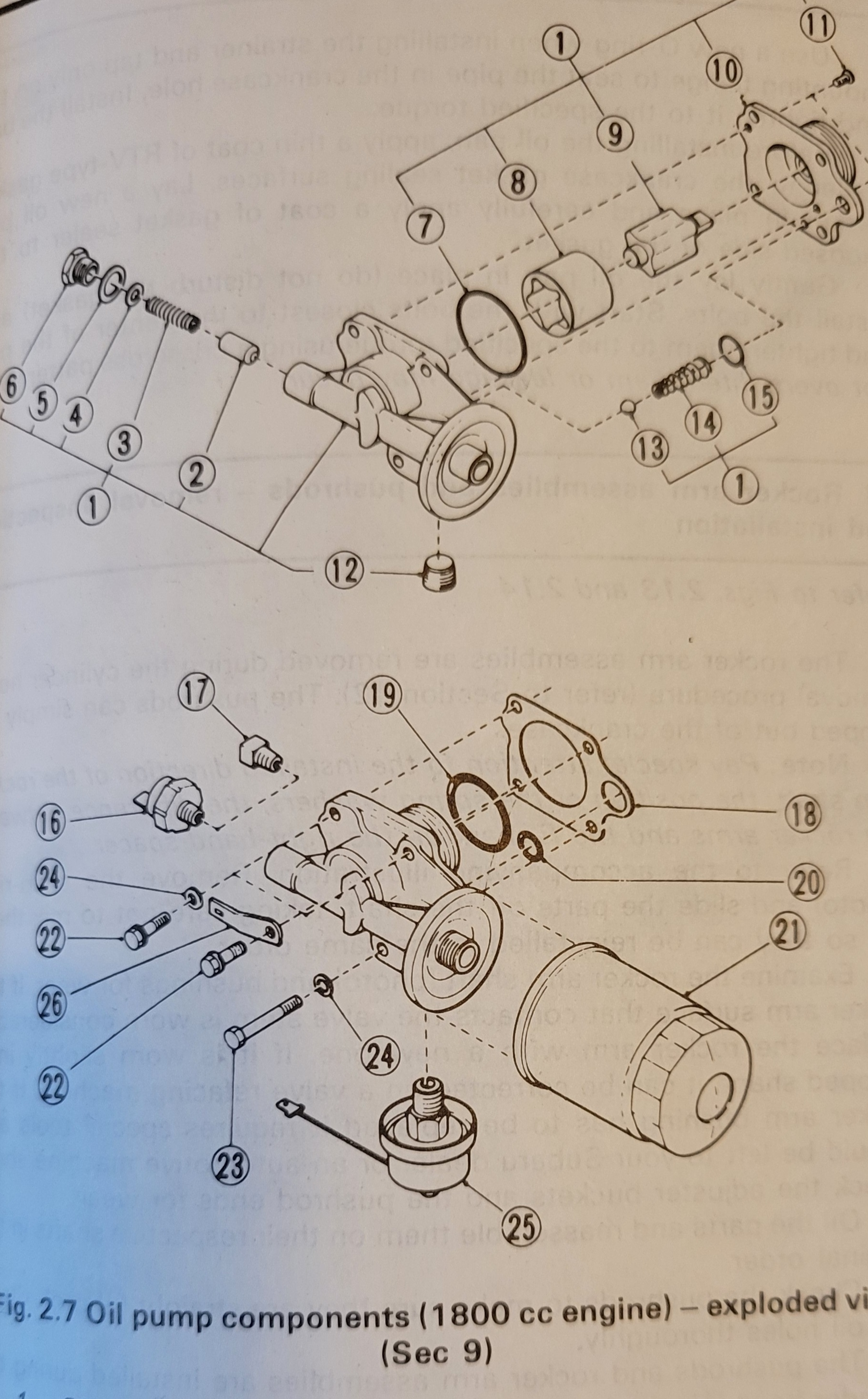

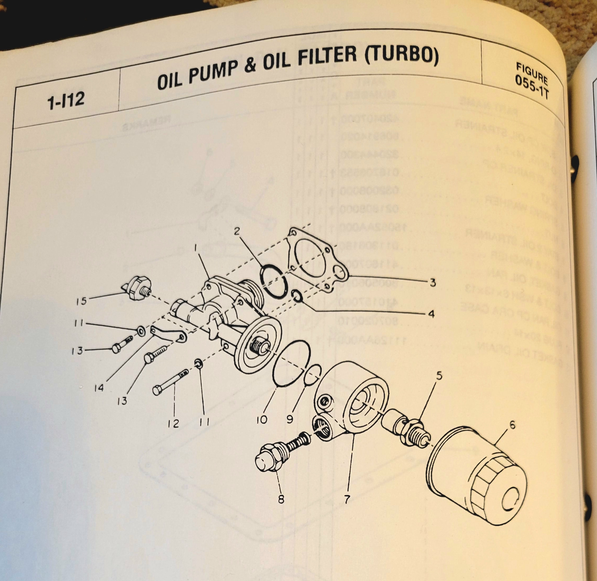

EA81T Oil Pump Gasket Question
Here it looks like there is an oring in between the main body and the gear plate, but my Turbo pump diagram doesn't show it what gives??
Yes I have been using and impact screwdriver, but even with heat the phillips bit and the screws are getting damaged and the screw is not starting to rotate.
My Turbo pump parts diagram shows no gasket or oring, but other EA81 pump disassembly diagrams show an oring. Is a EA81T specific oil pump the same as a Carbed EA81 oil pump just with the addition of the cylinderical extension which feeds the turbo and oil cooler in between main pump body and the oil filter?
Trying to verify whether there is a oring or gasket between the pump main body and the plate on my EA81T oil pump. The Turbo wagon that I am trying to resurrect has been off the road for 25 years. The orings on the outside of the body that fits in the crankcase bore were super hard and brittle. I have tried removing the 2 phillips screws that hold the plate over gears on the pump but even with heat and PBblaster they are not moving and the phillips heads are starting to strip. If I need to take them out they will probably need to be drilled out. However if there is no oring or gasket to replace in there I am not sure whether I want risk cracking the pump case by continuing to attempt to remove the two screws.
