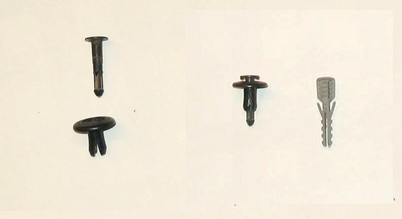

yewman replied to yewman's topic in 1990 to Present Legacy, Impreza, Outback, Forester, Baja, WRX&WrxSTI, SVXI haven't had this Legacy for long and looking at the operators manual, this cover has to come off to replace the rear bulbs. It says unscrew the clips. The clips on my car are a clever design which doesn't work. The middle part of the clip with the cross head slot is supposed to be turned a quarter turn counter clock wise and the part separates from the body, as shown in the photo, and then be grabbed and pulled out. There is no thread, just 4 steps behind the head. What actually happens is the whole clip rotates. I broke the first clip, and have replaced it with a plastic wall plug and a small screw. Seems stupid to me, a screwed clip is much easier.
2005 Legacy Rear Gate strut loose.
yewman replied to yewman's topic in 1990 to Present Legacy, Impreza, Outback, Forester, Baja, WRX&WrxSTI, SVXI thought brute force might be the answer. with all the technical improvements to cars over the years.plastic trim clips are still a nightmare. Thanks Yewman

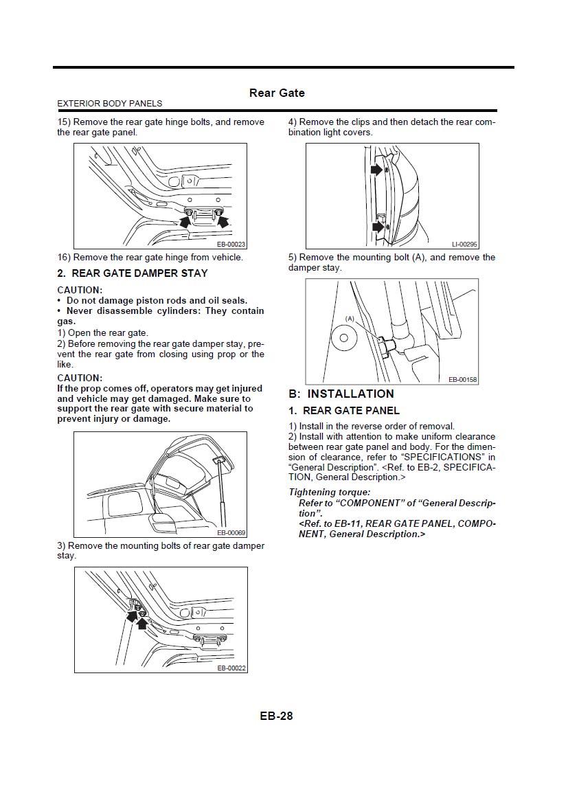

The bottom bolt for the rear gate RH strut is loose, and needs re tightening. I also like to grease the ball joints and upper mountings too. An easy job on my old 1999 Legacy, but on this one there is a plastic panel obscuring the bottom bolt. The manual says remove the clips to take the panel off. These clips have a crosshead recess like a screw, but they are not screwed in . Any idea how to get the clips off without destroying them. Even if we had a Subaru dealer nearby, they wouldn't keep clips. A copy of the manual page shows the clips upper right
