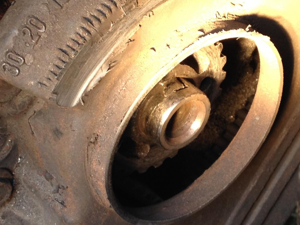

I have taken my crank shaft pulley off and know I need to get a new one. I am wondering if I am going to have to replace this other piece that the crank shaft fits onto though. I know I need a Woodruff key for it as well but will buying a new pulley and a woodruff key and putting it on fix my car. Or do I need to fix this other piece inside here?
