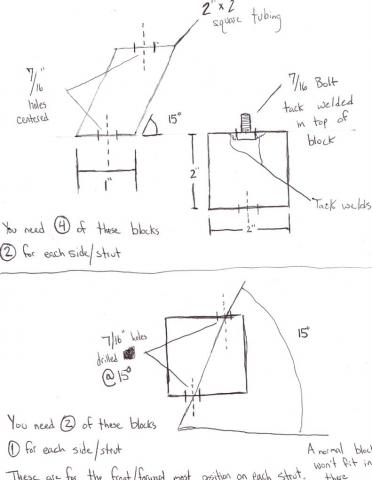

BEAR91LOYALE Posted February 15, 2010 Share Posted February 15, 2010 I am new to this forum or whatever its called. I have a 91 Loyale Wagon of which I want to lift. Is there a cheap way for me to lift it temporarily until I can afford a lift kit? Or does someone have detailed prints so I can Make my own. I saw the Helen Keller thing and I agree. Before I Became unemployed I was in the sheet metal workers union. I built signs for various companys including subaru. I am good at welding, fabrication, and reading prints. This is a you help me I help you type of deal. I dont mind fabbing up parts for next to nothing if someone can help me. Hope to hear from someone soon. Quote Link to comment Share on other sites More sharing options...

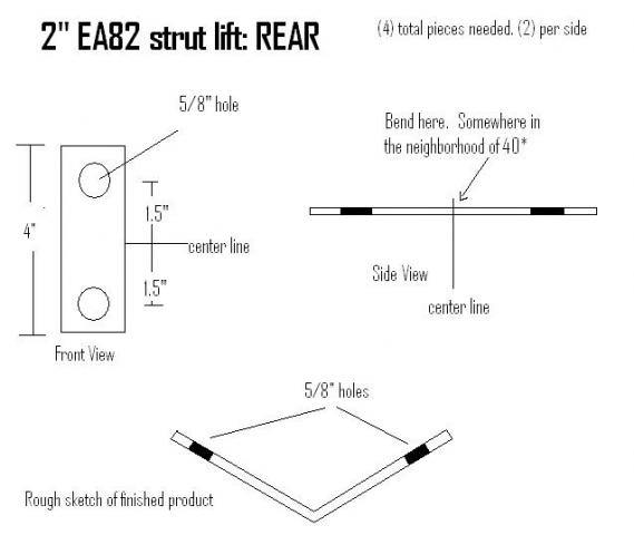

ivantruckman Posted February 15, 2010 Share Posted February 15, 2010 check the off road section of the forum. somone made a sketch of a 2 inch lift. i did it and it was less than 20 bucks in steel Quote Link to comment Share on other sites More sharing options...
ivantruckman Posted February 15, 2010 Share Posted February 15, 2010 like this lhe rear bracket requirres you to flip the top or the shock 180 degrees to get the angle Quote Link to comment Share on other sites More sharing options...
MilesFox Posted February 15, 2010 Share Posted February 15, 2010 easy enough to fab yourself. the hardes thing will be finding m10x1.25 bplts long enough. You could fab part of the lift, and get pre-engineered partial kits for sale. you are basically doing a body lift and keeping the suspension geometry the same. the only difficult part to figure out is the strut tower and the angle of the strut to keep camber correct. You may have to extend brake lines, and you will have to make your own steering linkage extension Quote Link to comment Share on other sites More sharing options...
