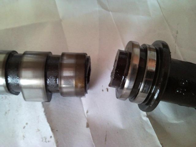

Sorry Nathan, you're right! :o Anyway, I had run out of justifiable vehicle downtime, so I had already told the mechanic to replace the cam. I just picked it up and so now have a functional car again. I have attached a picture of the broken cam. I've checked that thing up and down and can see no signs that the cam had actually seized prior to breaking. The mechanic said that it's uncommon, but he has seen EJ22 cams simply fail in the past. I am still skeptical, but there's not much I can do right now (except update my AAA membership to the Premium level).
Edited by jarz21
Glad it's running OK for you again and thanks for sharing the picture. It's an odd failure, for sure and I think your mechanic would have seen some galling on the cam "bearings" if there had been a seizure. Metal fatigue perhaps? :)
Interestingly enough, the Rover P6 2000 TC (the car in my avatar) was known for snapping the camshaft if revved very hard when not under load. There's just a touch too much torsional loading or some such thing. Hard metal tends to be brittle....
Nathan
Thanks, Nathan. Yeah, I'm stumped by the failure as well, but I'm just happy to have a working car again. I changed the oil yesterday (before the pouring rain came to Boston), and today I drove an hour to a junkyard so I could find some cruise control parts and a variable intermittent wiper switch. The car never skipped a beat, so I'm content for now. I got completely drenched working my way around the 'yard, but I got a great deal on the parts, so both my Subie and I are happy. Once I find an MT cruise ECU, my Outback will essentially be everything that I could ask for in a car, so I hope for my wallet and sanity's sake that the cam was a fluke and that I'll get another 150,000 trouble-free miles out of this thing!
