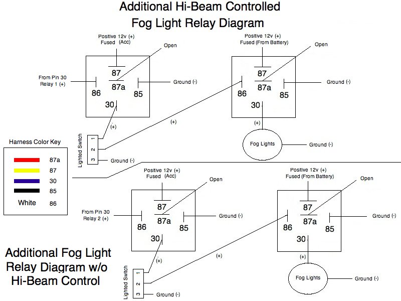

These are the diagrams that I made to install my off road lights. It's a little complicated using relays, but I get the relays for $3 including a harness, so that's why I did it this way...
And to add more lights
Now the first diagram has two ways to turn on the lights, one to have the lights come on with the brights, and a second one is wired to it's own lighted switch so that you can turn the lights on whenever you want, without having to turn on your brights. Then there is another lighted switch that controls the individual set of lights. My goal was to be able to turn on all the lights with the brights on, turn them all on without the brights on, and then to be able to control each pair of lights by themselves. This way when I go to wire in more lights, it's already setup for me, all I have to do is wire them in. Also I wired them this way because at no point is the power load of the lights going through any of my switches, it just goes through the 40A relay, instead of the 6A lighted switch. You could remove some of the relays, but you would be running the entire load of the lights through one of the switches, which is a bad idea, especially if you plan on adding more lights than just one set.
Like I said, it's a little complicated, but it allows you to have complete control of the lights, and you aren't running a large load through any switches. Let me know if you have any questions on my diagrams, I will help out as much as I can :)
Oh, and the first relay in the first diagram has the correct wires to have it come on with the brights, and only the brights. I updated this diagram after installing my lights and getting them to work they way I wanted. On my first try, they were always on with the lights, brights or no brights :mad: So after resoldering it all again, I updated the diagram so I wouldn't do that again :rolleyes: The subaru light system is common grounded, so it's a little different than most and a little more tricky. There's some good threads about it on here, I believe skip explains it quite nicely, just search for it.
