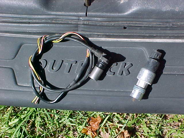

May 15, 201015 yr first i'm an auto trans guy , so i may be wrong on some of the finer points. but... you need to tart over. vss #1, on autos, has nothing to do with the speedo / odo. so check your cel code again. on 5 speeds, the vss #2 is on the passenger side about half way back, i think. on autos, the vss #2 has a wire connector built into the top of the unit. so the wire harness plugs right into the speed sensor. check it again, unplug it and plug it back in again. not working except when you hit a pothole sounds like it could be a lose connection, or maybe the speedo drive gears. but lets not go there yet. Vss#1 is on the rear extention housing, passenger side, again auto trans, and there is NO wire connector at the unit. it is part of the trans harness, which the manual trans does not have. edit, manual trans do not have this one. pic below, from an auto trans, vss #1 is on the left and #2 is on the right. if yours looks different, please disregard everything i said. EDIT: maybe check the connector at the speedo. Edited May 15, 201015 yr by johnceggleston
May 15, 201015 yr Your manual trans Legacy on;y has one VSS. For some reason Subaru calls this one VSS 2. Only automatics have a VSS 1. The VSS on your car is on the passenger side of the tranny, about half way back. 3 prong connector right into the top of the sensor. Unhooks from the sensor. Sensor threads out with a 17mm wrench.
